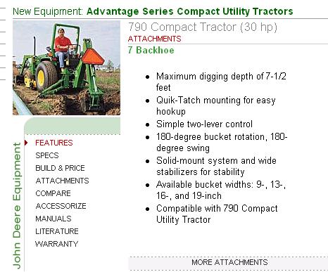

Re: 790 - Backhoe info
IHCrules,
Here is info (attachment) on the JD 790 backhoe.
Buck
