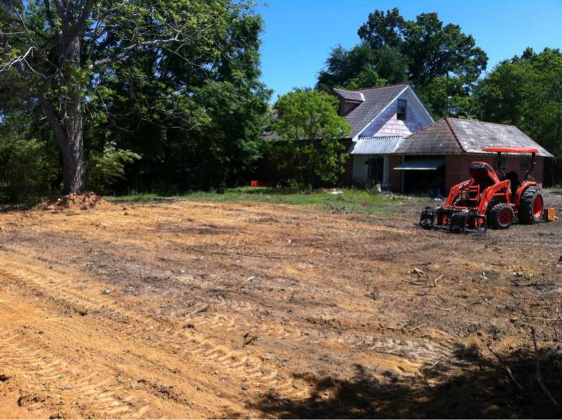

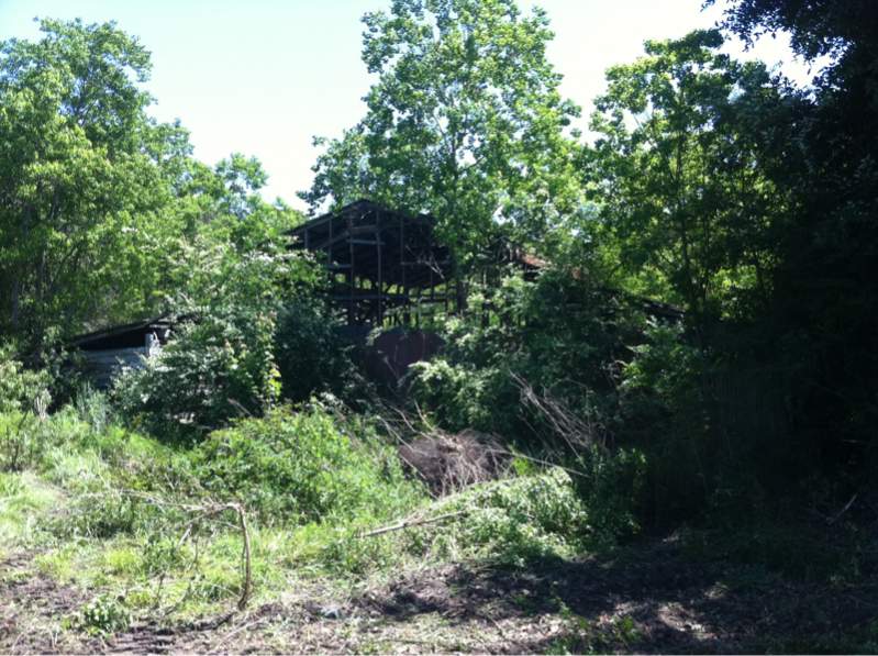

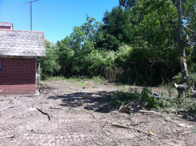

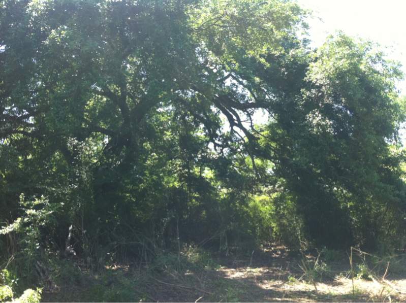

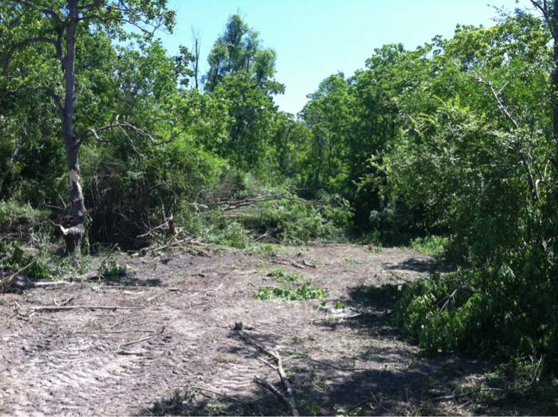

Here are some updates from recent work. As you might remember you could not even see the house from across the street before 3 weeks ago. I'm learning that slow and steady will win this race, when I get in a hurry things go bad.... It's not a dozer.

I am in the midst of some reclaiming work on a family property. It is only a little over 3 acres, but has become quite overgrown. Luckily I have the support of 2 out of 4 brothers, and one did all the tree work so far. Looks like you are doing well with your project! I like the " slow and steady" approach. I don't have much choice, but it will give you more time to see what you have, and make decisions. Looks like you are off to a great start. Brian

Looks like you got your tractor and root rake with grapple. You shouldnt have much trouble with all the scrub brush with what you have and a heavy bush hog. Looks like you have made a good start. You will be surprised at what a bush hog can shred up when you push it over with your tractor FEL and hit it with the hog. Small shredded trees make good soil compost. Clear it with the bush hog and then work on the rest if need be with chainsaw or backhoe as needed to remove. When you get all the tractor will take out, you may decide that the rest looks good enough to keep.
   / 8 Acres to clear...... Smart or crazy #30
great progress!
