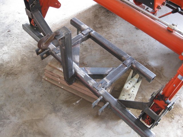

Has anyone tried mounting a plow UNDER the FEL? It seems to me also that the plow out in FRONT of the FEL puts a lot of leverage against the tractor and creates a very long rig. I'm sure there are reasons why the plow is better mounted out front so just curious.

You can only go back so far before the end of the plow hits a front tire. There are several threads where the pivot point of the plow frame was set back a foot or so behind the ends of the loader arms to get it as close as possible. They are not as simple as going forward from the loader arms and have to be well designed and built to be as strong .
I think I could shorten the setup in this picture by a foot by moving the hing pins on the push plate back through a hole cut in the push plate so that the ends of the angle cylinders were flush with the push plate.

I just happen to be mounting a 7 foot Western snow plow to my B2400 loader arms. Originally I had the plow mounted just in front of the loader arms. Now I'm moving it back about 14 inches. With the plow mounted just in front, I plowed a very light snow. It worked well. Because I have a fairly small tractor, I decided that to move the attachment point back in anticipation of heavier snows which would put greater lateral forces on the loader arms. Also I figured I could always mount it in front if it did not work in the moved back position.
Note that I have a cushion valve installed for additional protection.
One thing to consider is moving the attachment point back too far will cause the plow to hit the loader arm when the plow is angled.
Attached are photos showing my original configuration and the work-in-progress moving the attachment point back 14 inches.
