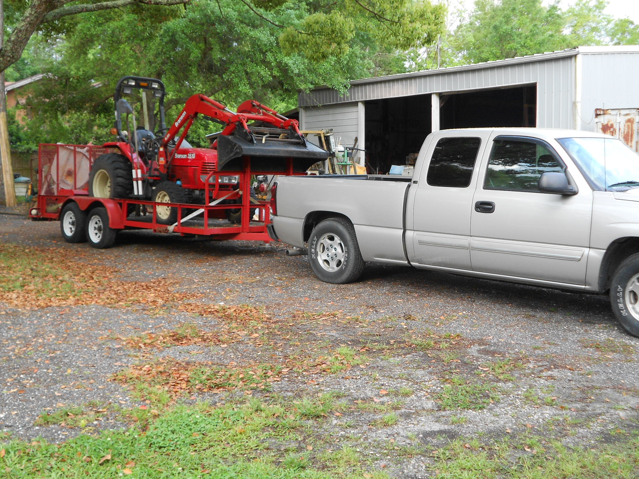

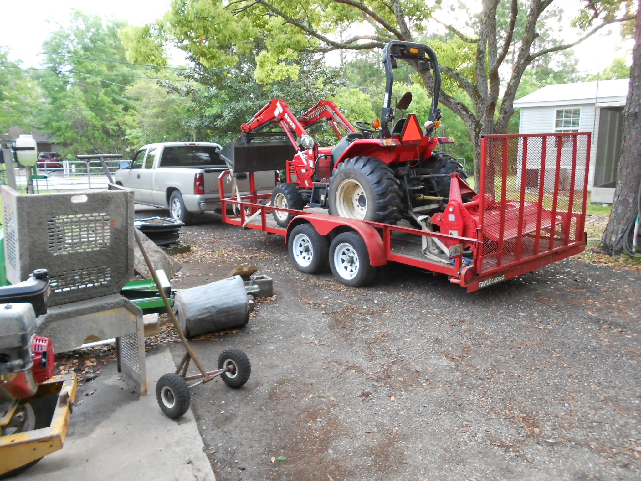

My PU has no problems with a heavy load, pics are with almost 7000 lbs. The wind resistance was the problem.

edit- those are not the heavy pics, the heavy pics are with the backhoe on the tractor.
