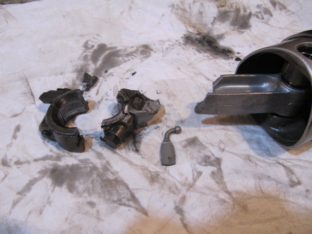

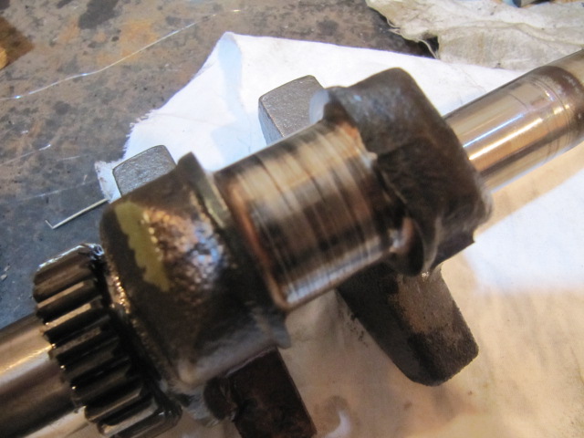

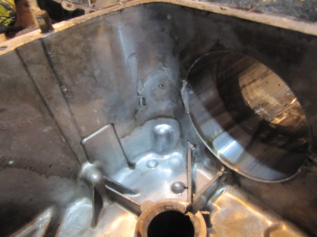

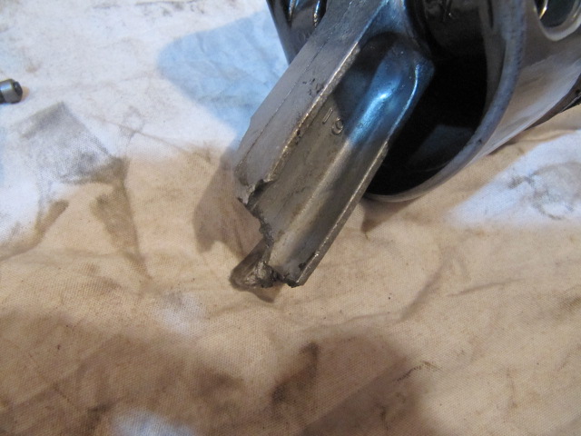

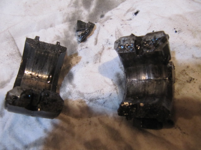

OK. First off: I bought the Roto Tiller attachment for cheap, knowing the engine did not run. So what happened to cause that condition DID NOT HAPPEN UNDER MY WATCH.:( What the seller neglected to tell me was that the engine could not run. I found that out when I got the head off and discovered that only the valves moved up and down when I spun the crank.:p
In the first three photos you see the pieces as I found them in the crankcase. In the fourth I'm trying to show some of the damage to the crank. The fifth shows where the con-rod whacked the side of the crankcase and the bottom of the cylinder wall. Not too much damage there. I should be able to hone the cylinder wall enough to rub that out.
My question is why did this happen? There was enough oil in the engine when I bought it but the crank looks to me like the engine ran dry at some point and though the operator filled it again, the engine soon packed it in. If there are other scenarios, I would like to hear about them. Also, at todays' parts prices, does it make sense to overhaul this engine, or should I just wait for a good used one or even one of the cheap off-shore units that Princess Auto here in Canada has on sale from time to time?
Thoughts?

Cause of failure is lack of lubrication, ie, not enough oil. due do cost of repair parts it is not worth repairing unless you really want something to do. I would look for a good used or new engine and not mess with this engine.

Some rods are really cheap others...not so much. As far as the crank goes, they usually clean up with a little muratic acid and 2000 grit. I did a mower last year on a bet that was worse than that and my buddy mowed all summer with it no problem.

I have a rod and piston just like this on my desk. It's from lack of oil.
They are splash lubricated, and if you run them low, or run them on an incline, they pop.
