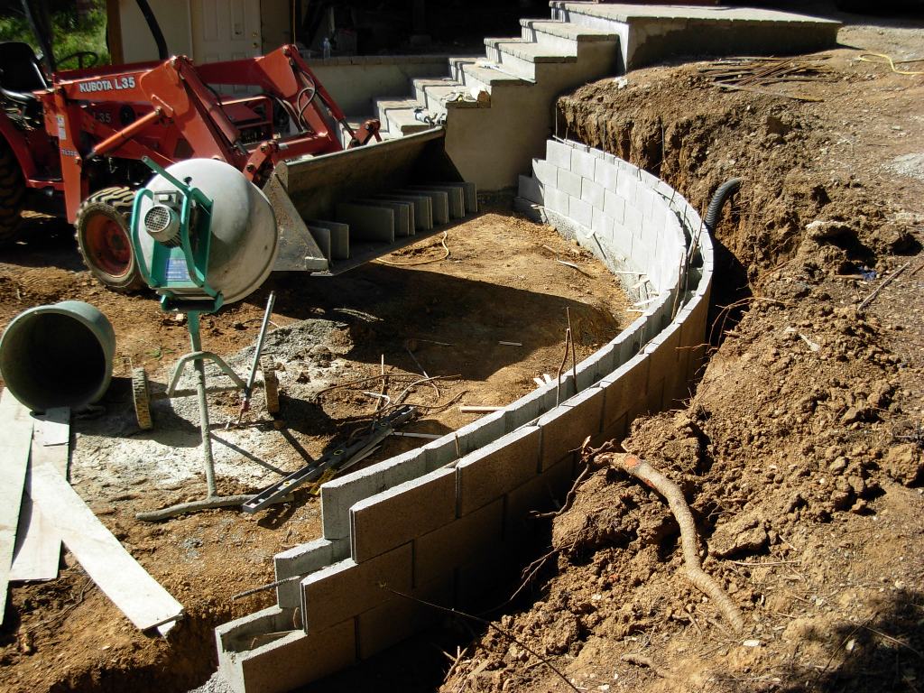

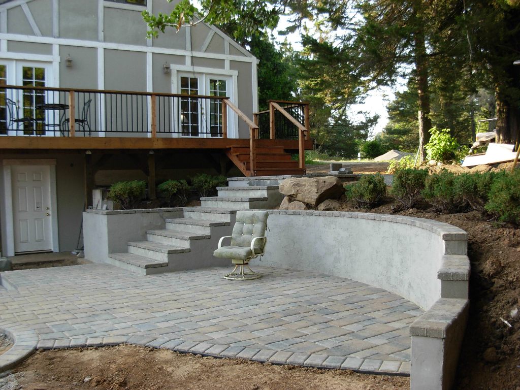

One of the strongest shapes is the arch. I've built a few retaining walls with this shape. The one I have pictures of is only about 40 inches tall but it's enough to give you an idea of one way to build a retaining wall.
It's built of concrete block the ones with the open ends. It has a footer with two strips of rebar running horizontal. In the wall rebar runs both horizontal and vertical and is completely filled with concrete. There is a perforated drain pipe behind and at the base of the wall.
For the homebound engineering, that's the proper way it should be done. Hopefully the perforations are on the top side of the layout. :D
Accolades to your planning.
