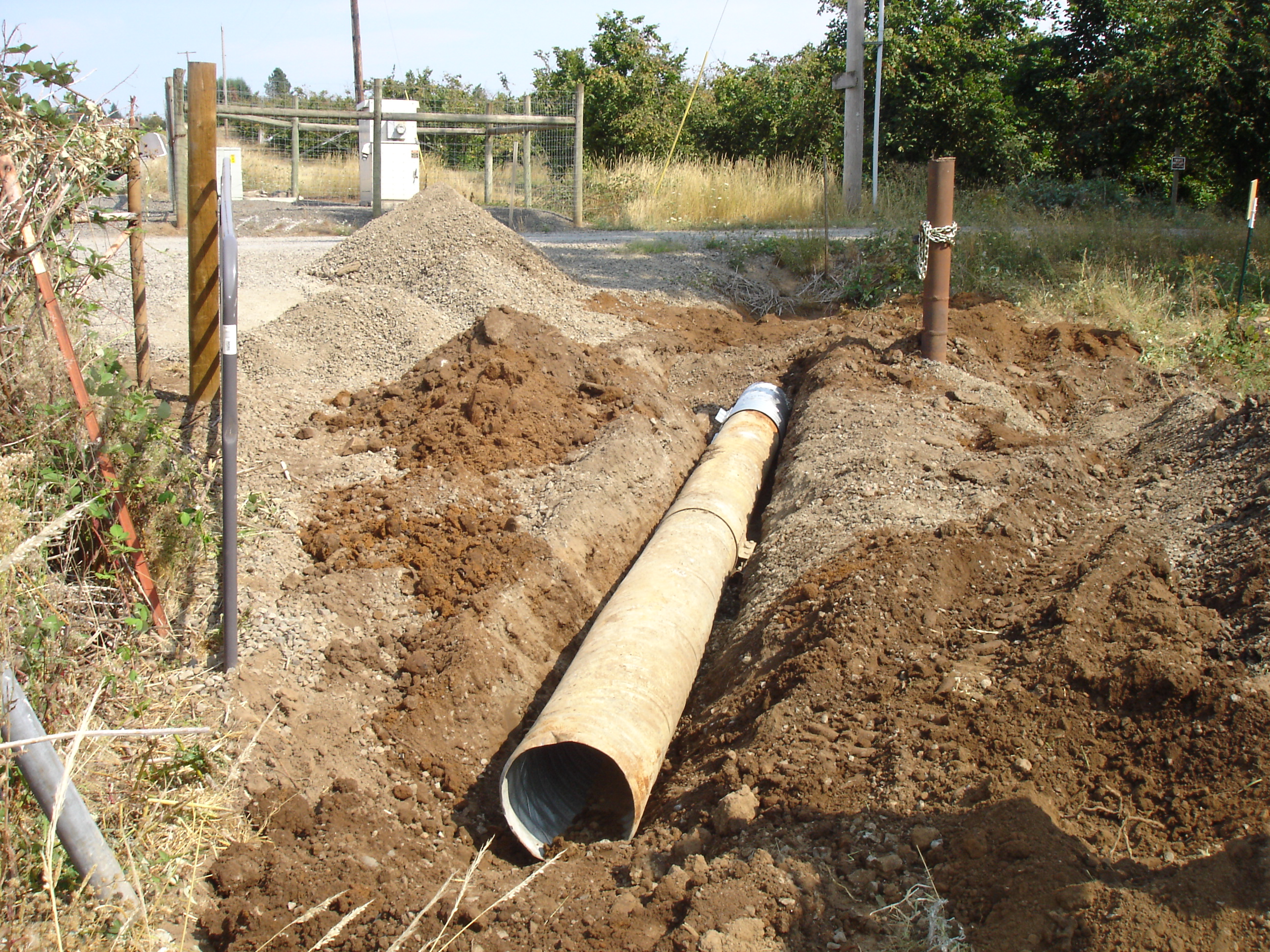

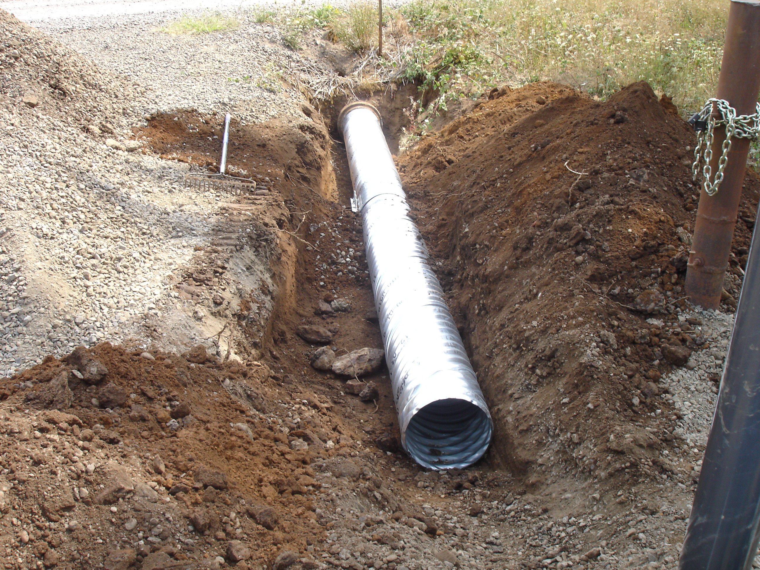

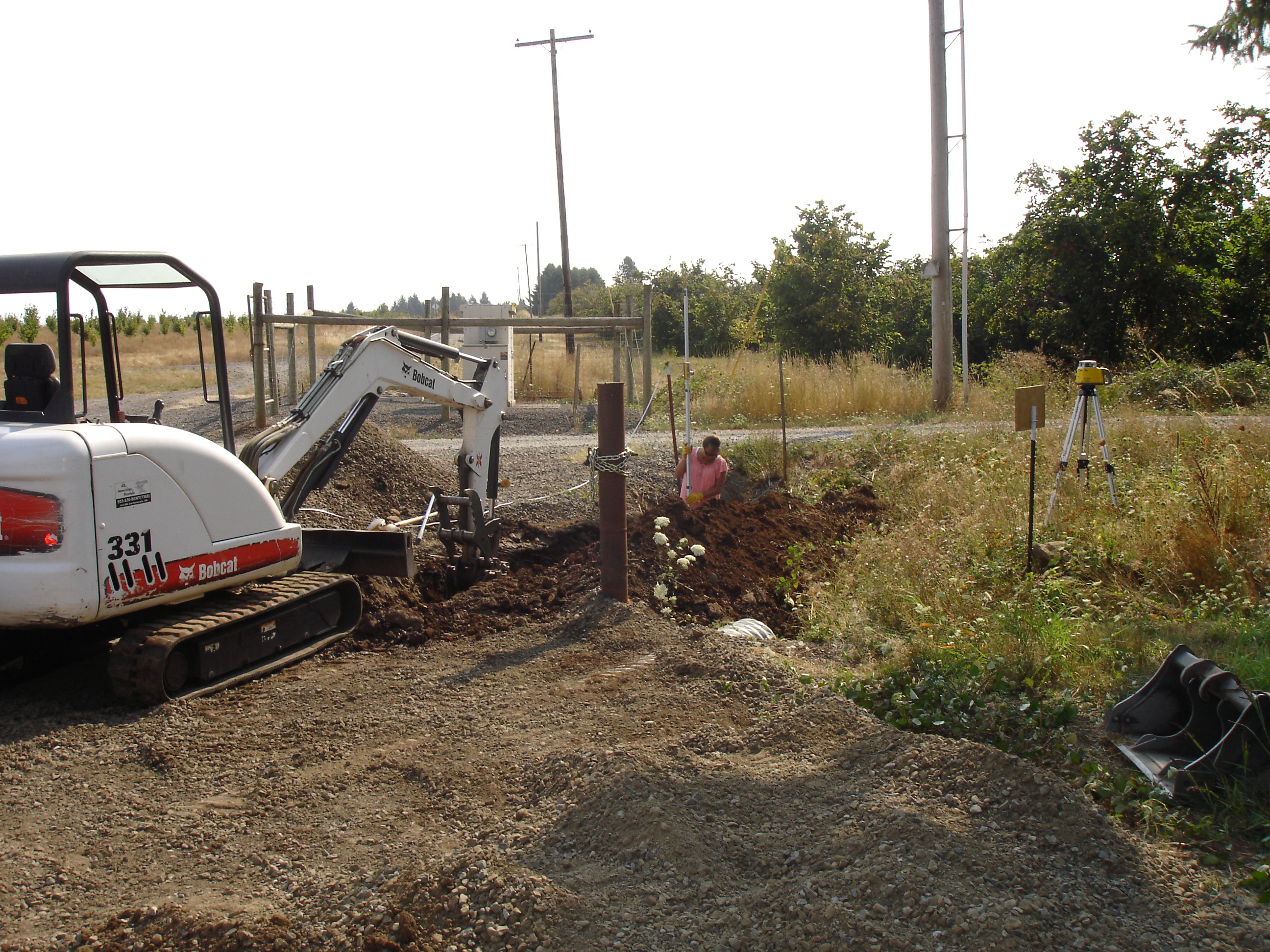

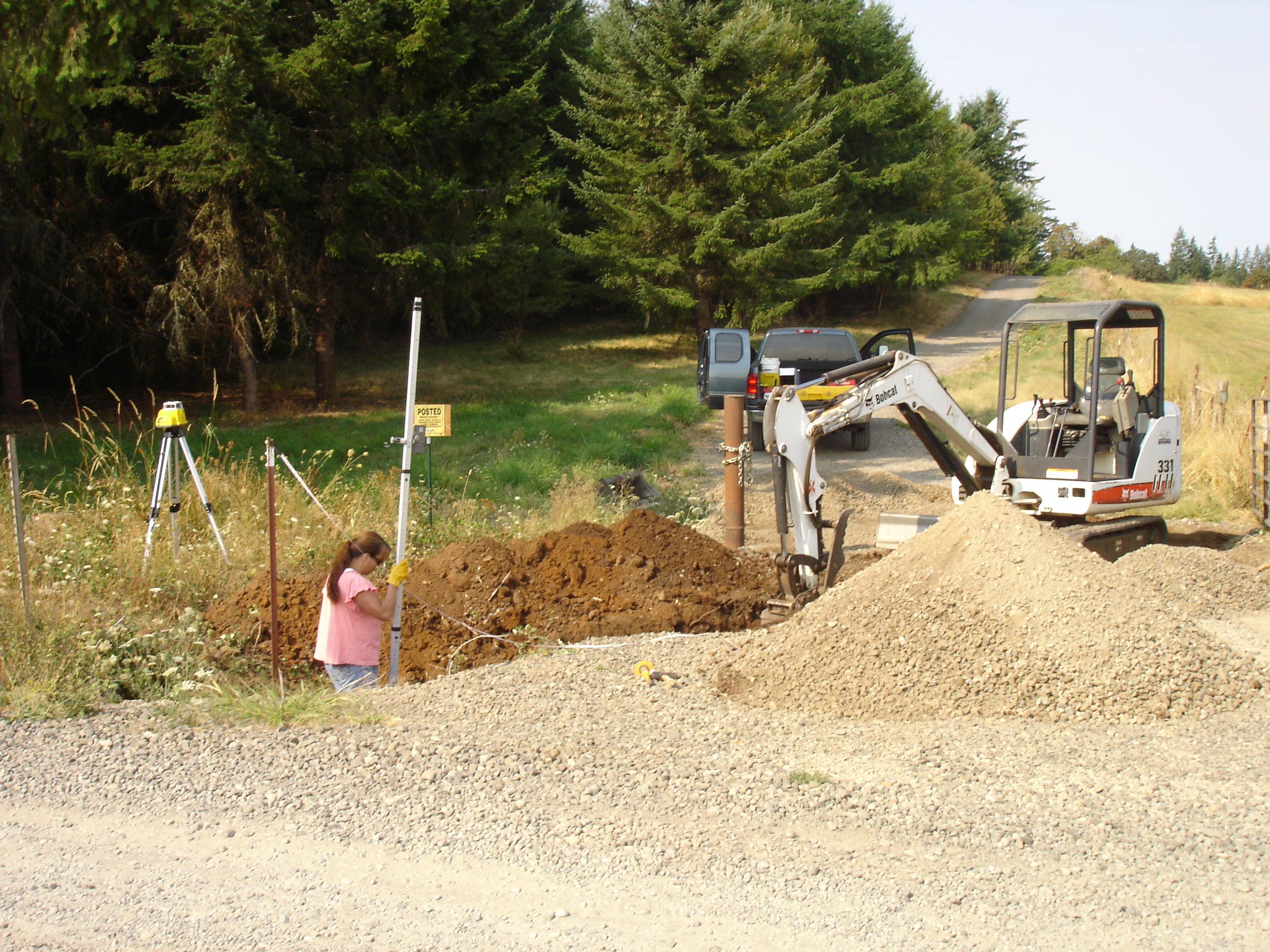

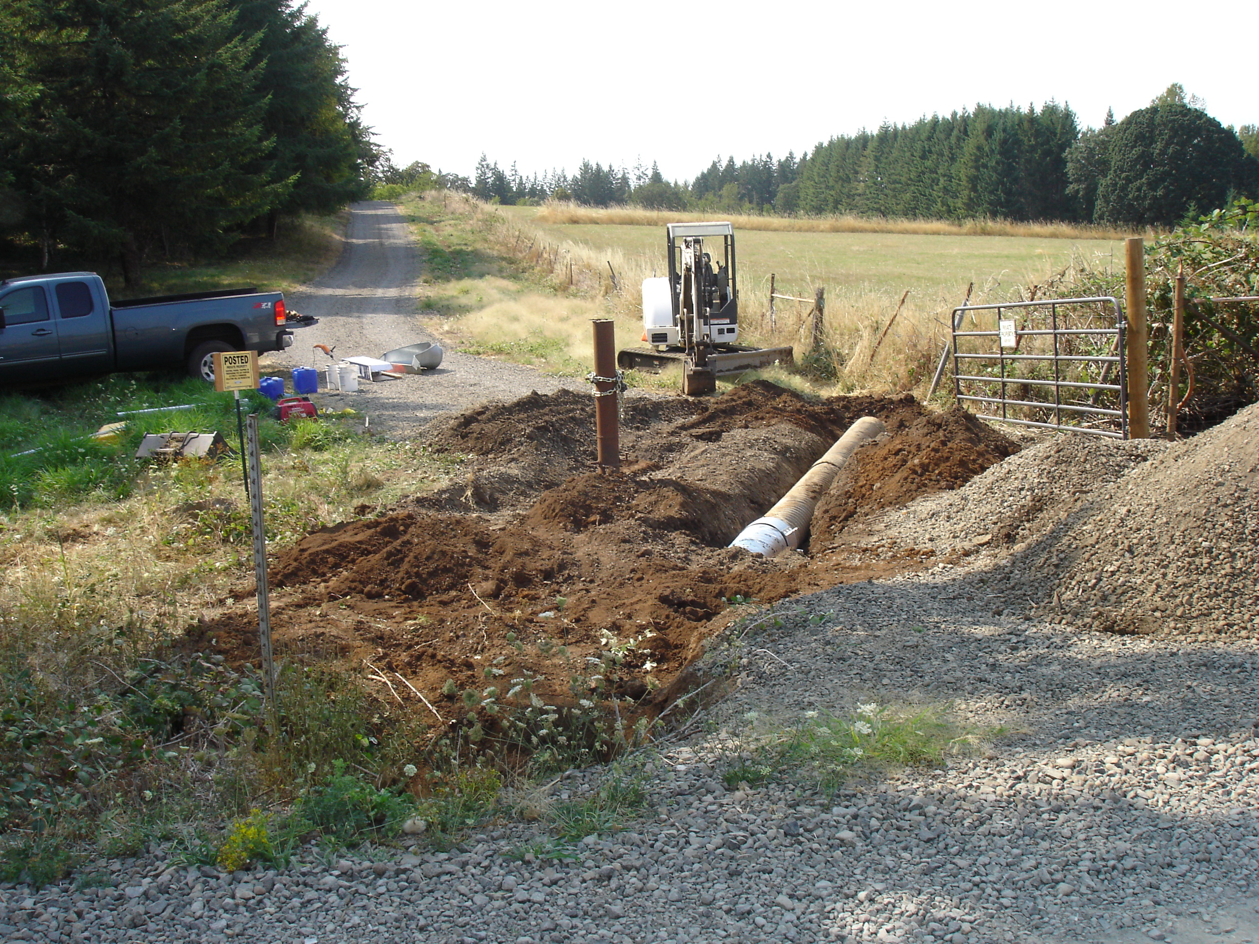

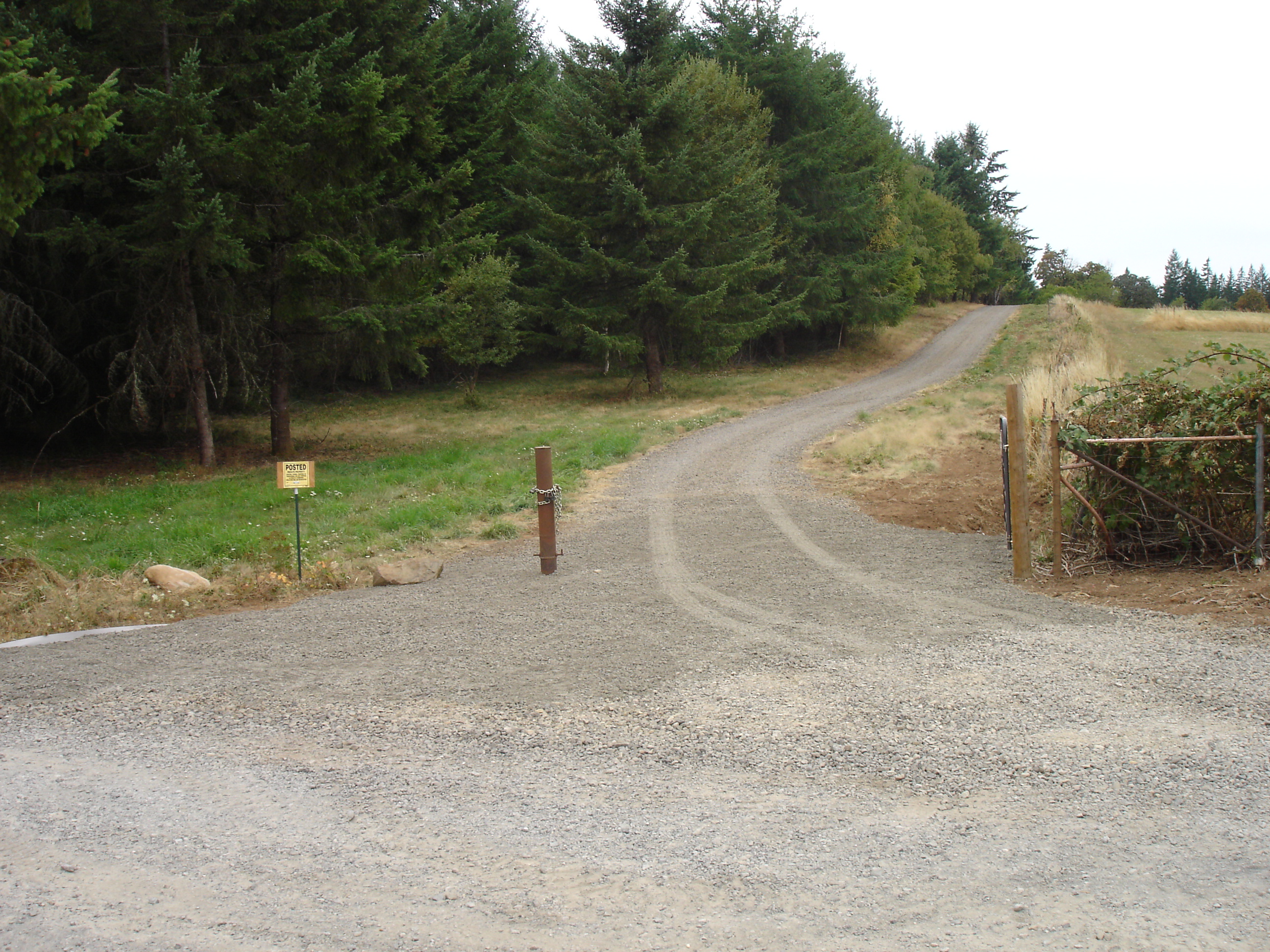

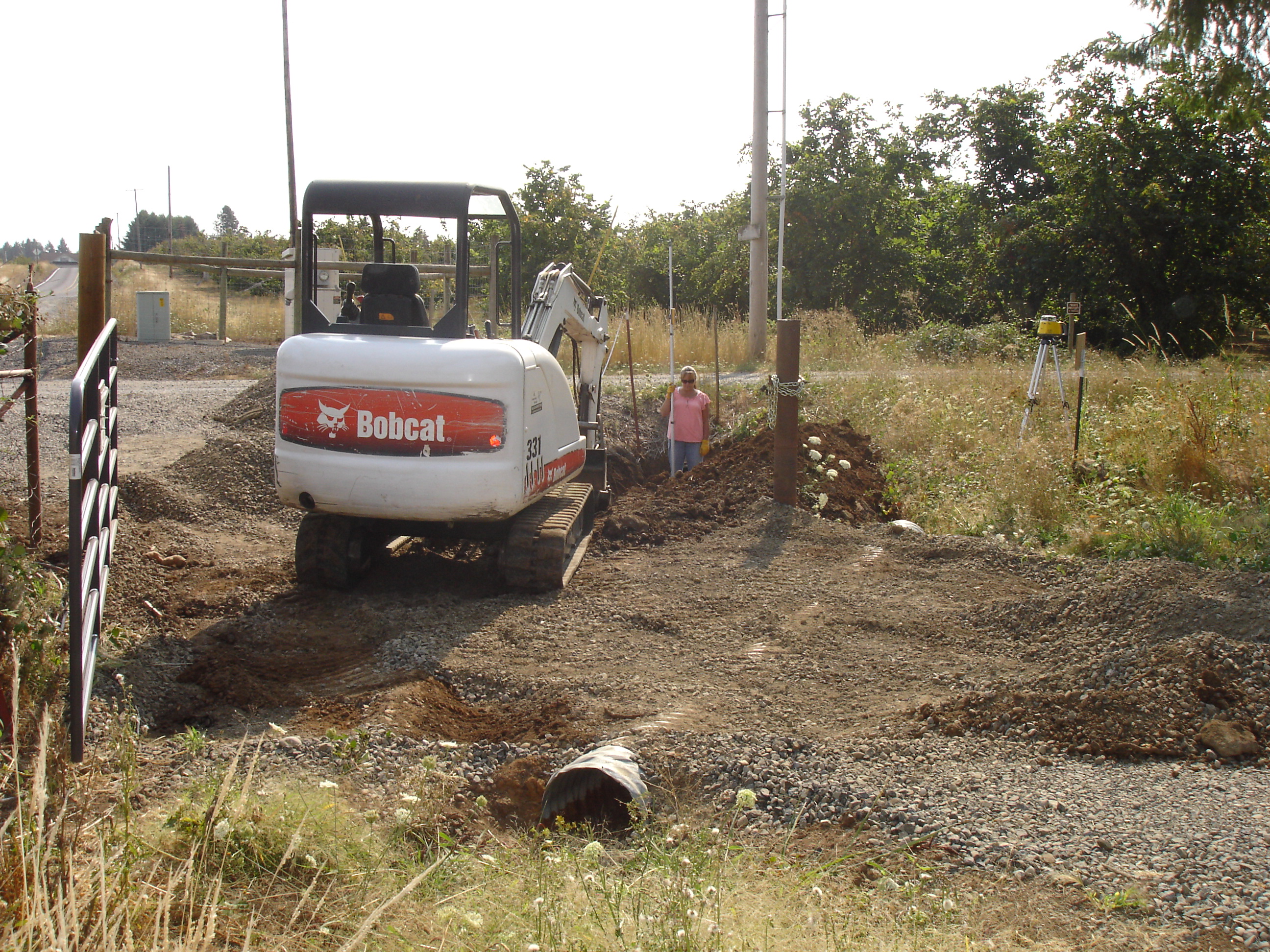

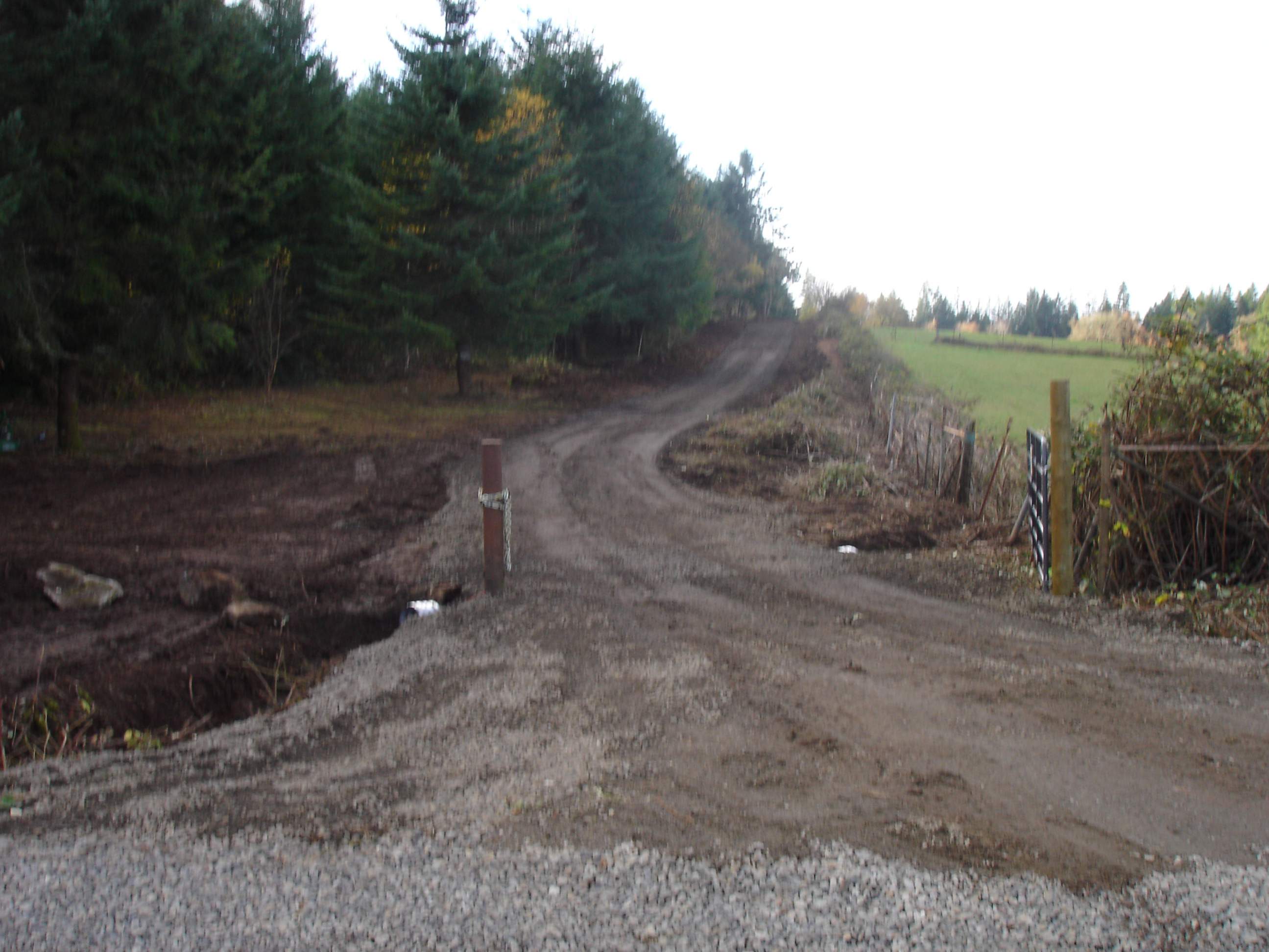

Started working on the entrance. Originally there was just a ditch that connected the culvert from the uphill property to the small culvert under the driveway which then ran to the downhill property. I had already replaced the driveway one with a 18" galvanized one temporarily. It was time to make it permanent by having one run.
Rented a excavator for a day because the Kobelco was just too big. Dug up the old one and added a new section, total length 40'.

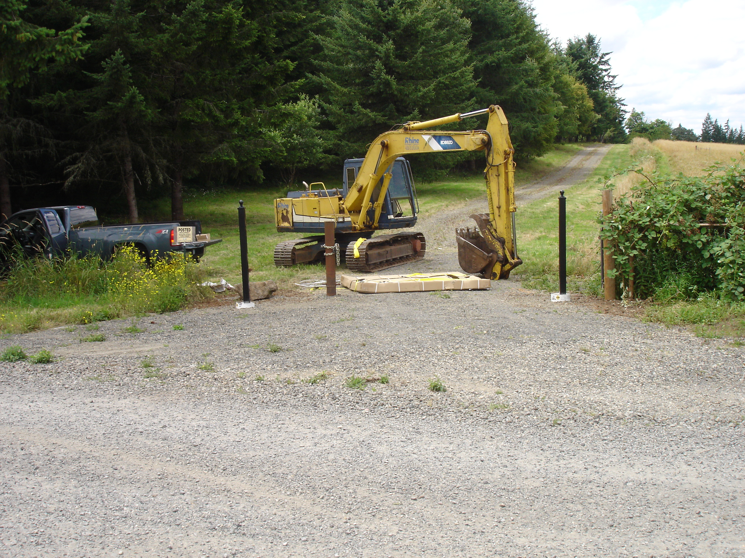

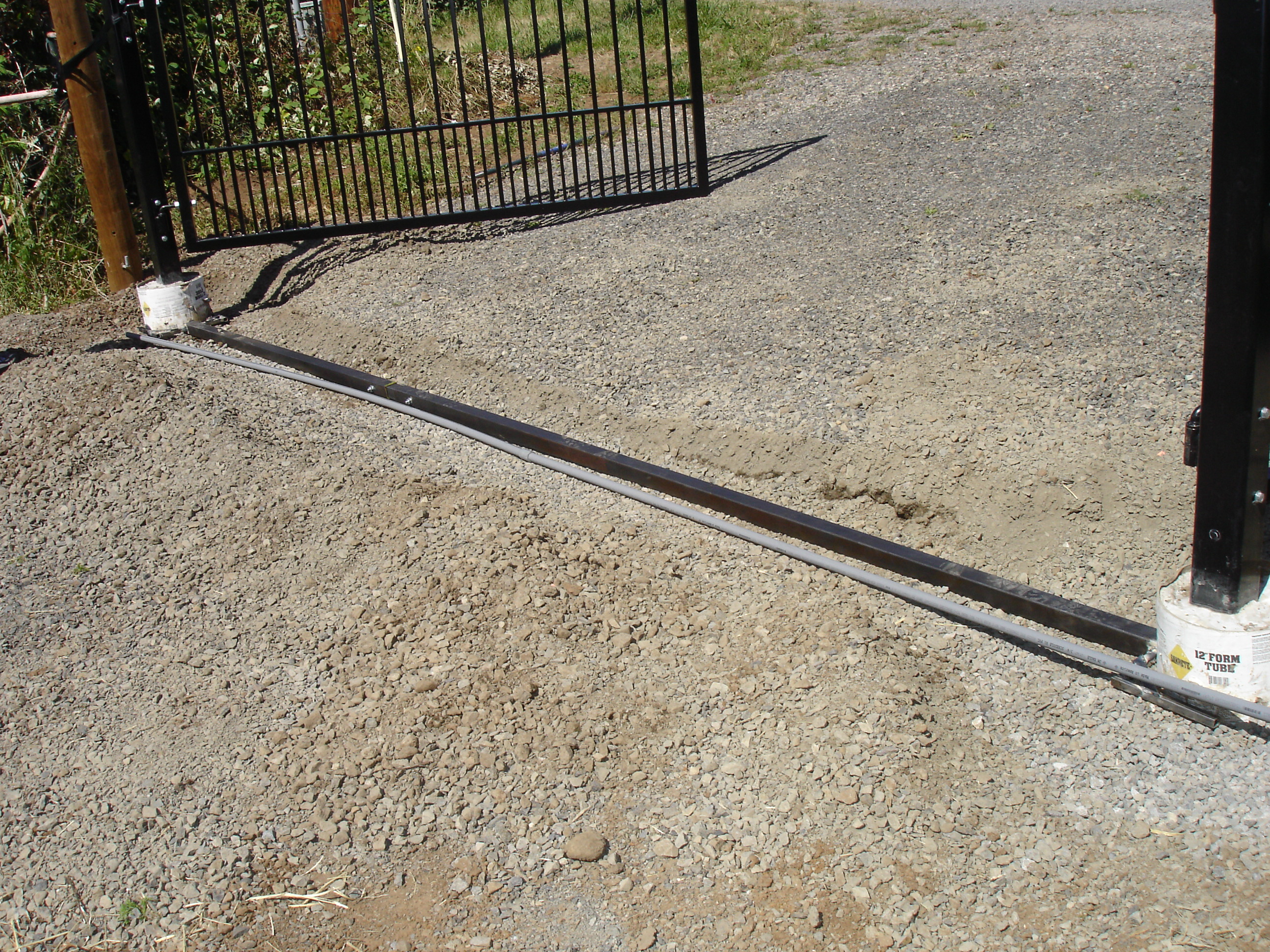

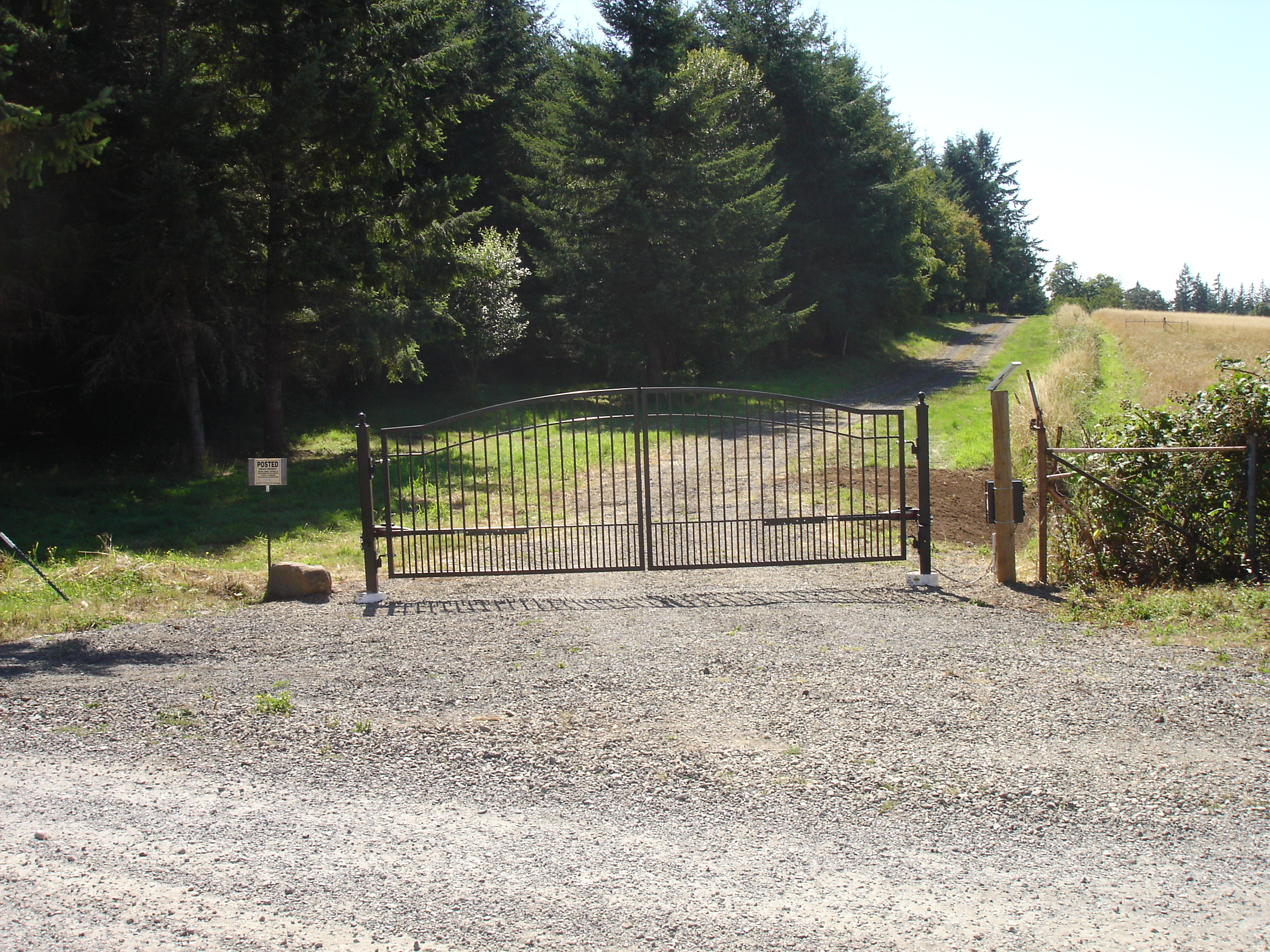

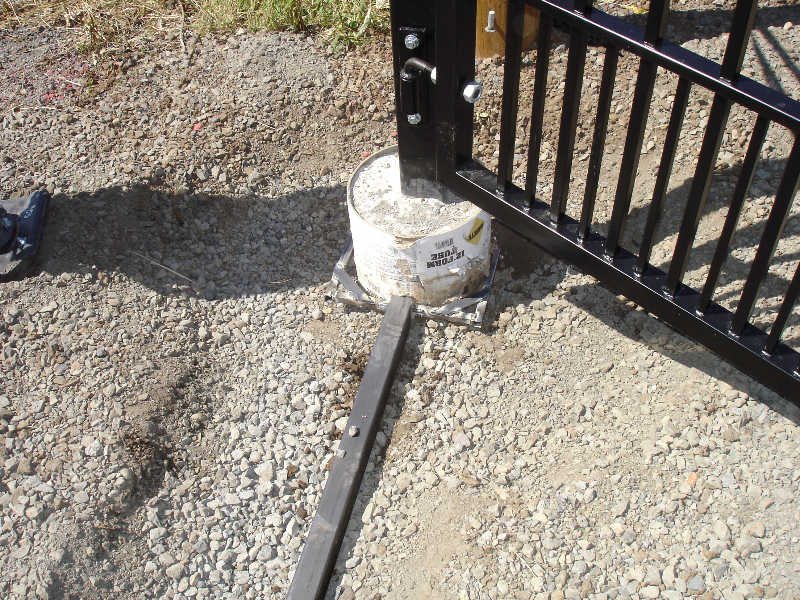

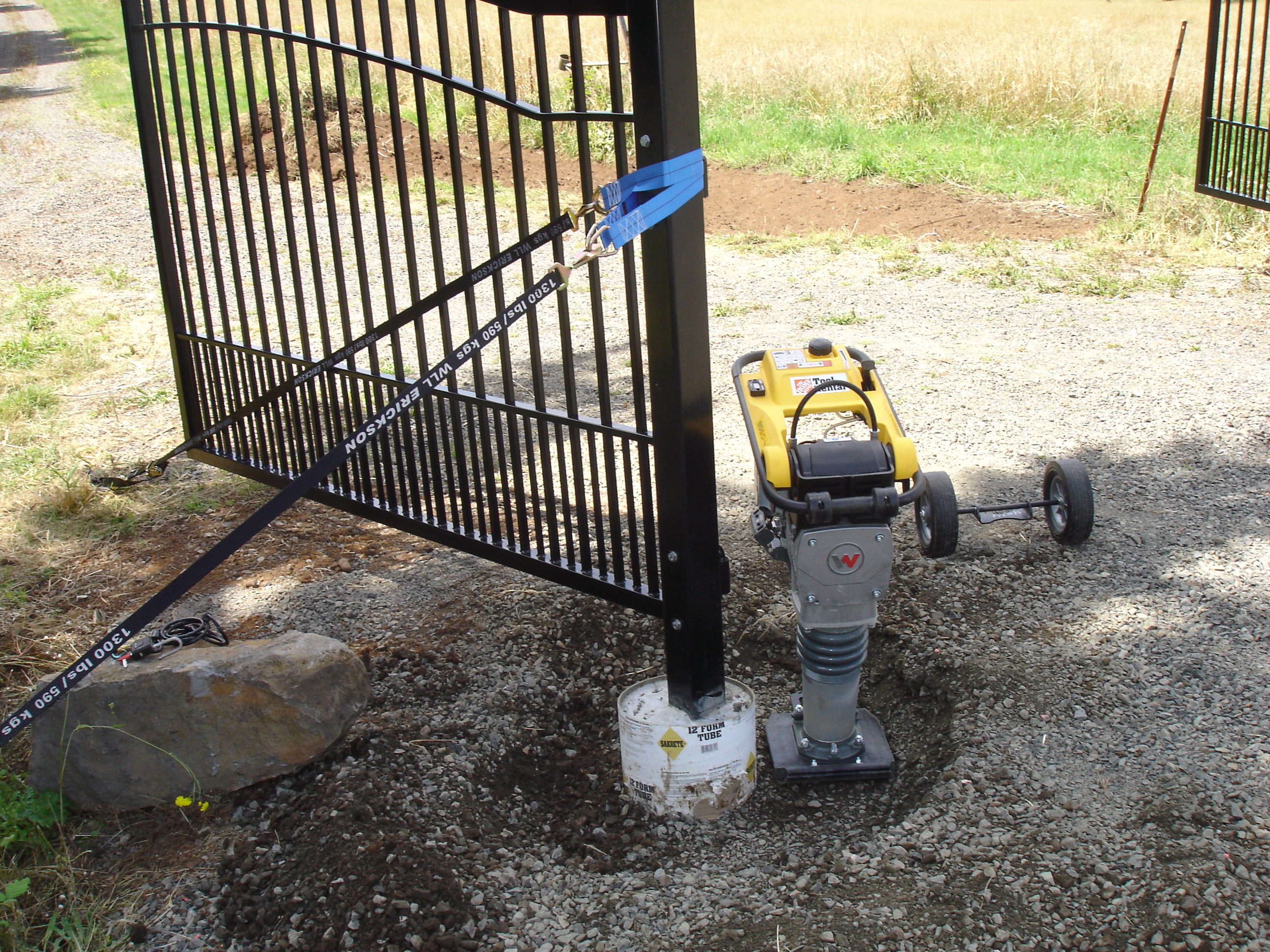

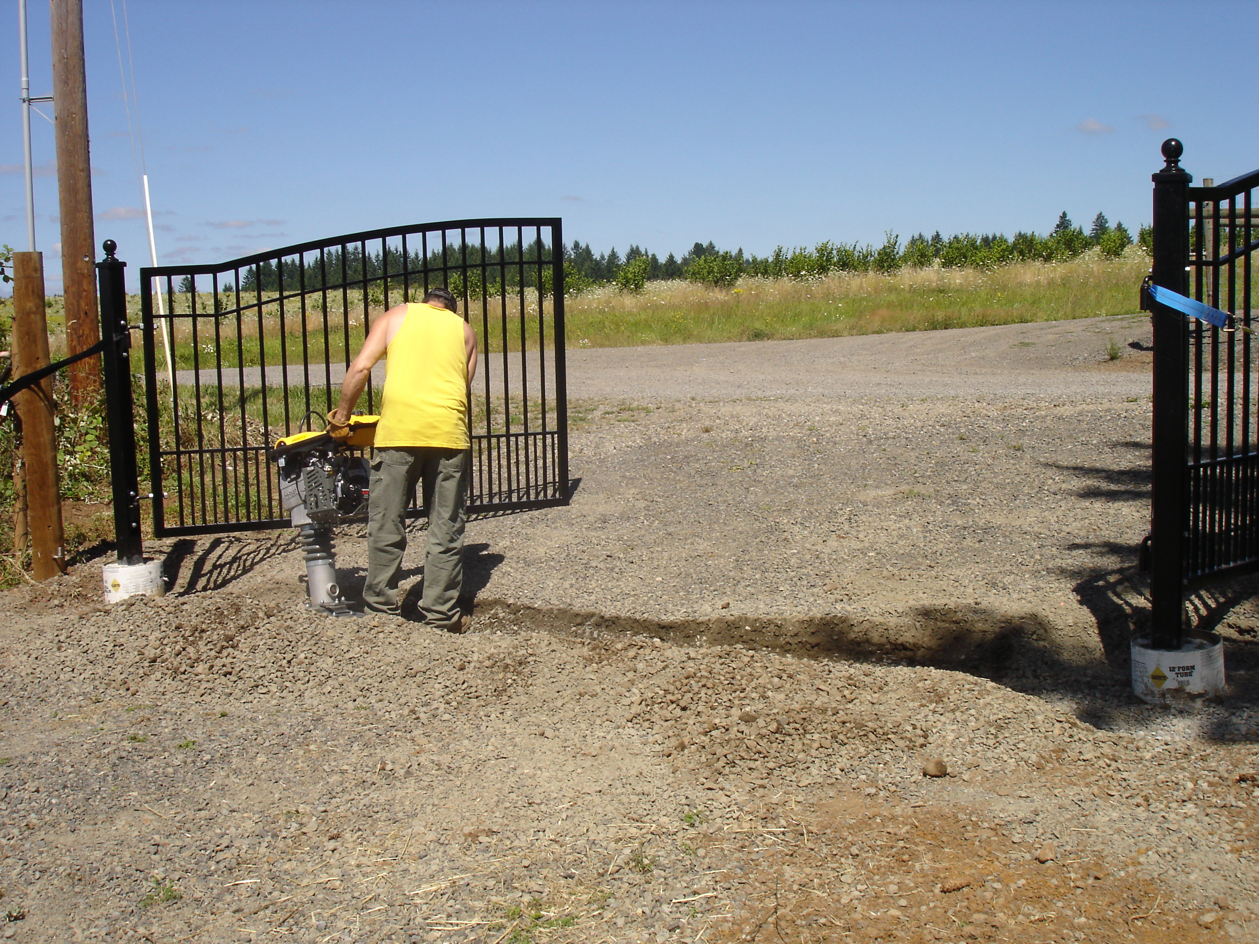

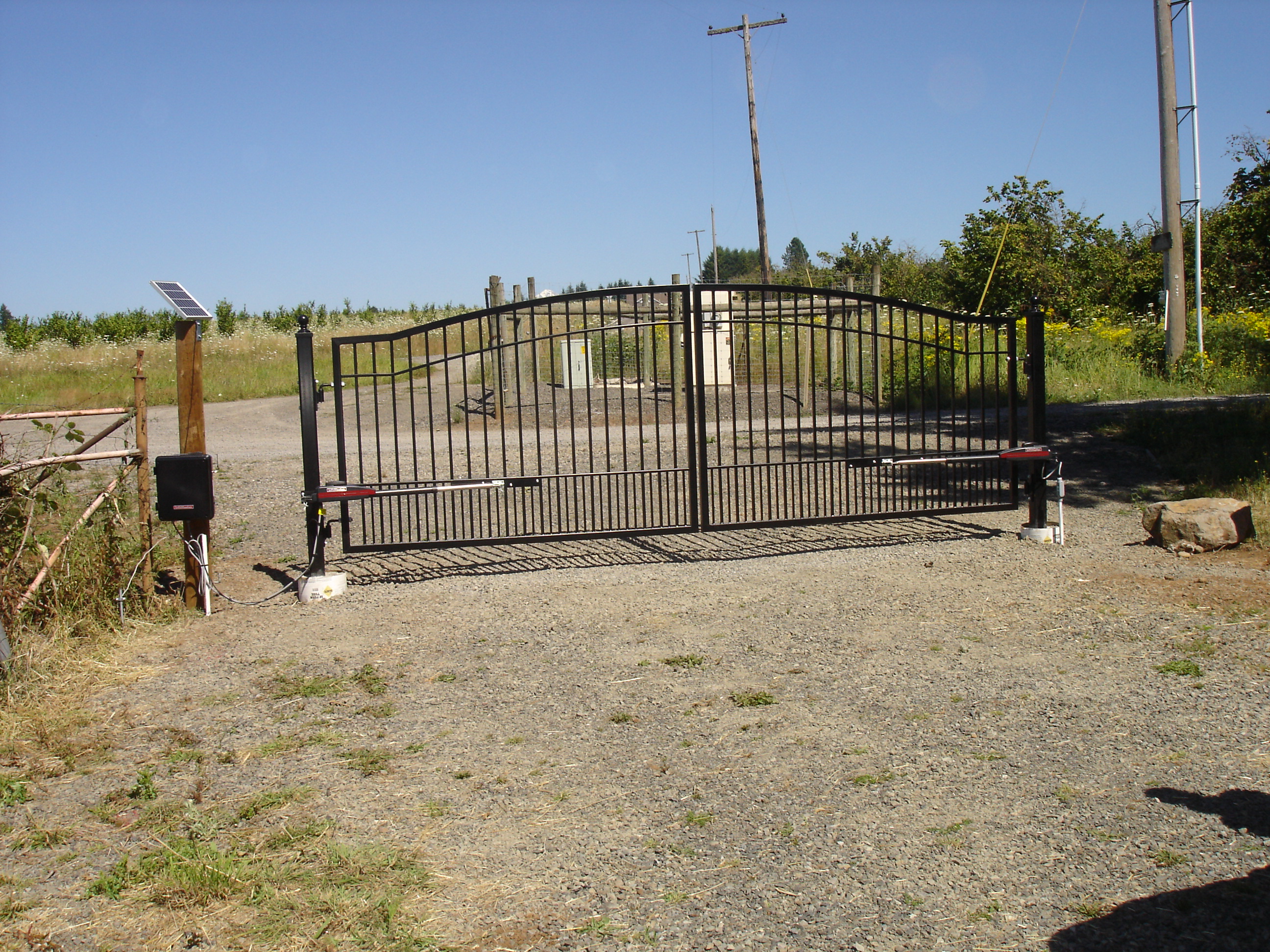

We started having problems with trespassers so it was time for a gate. We figure it was locals so they knew when we were there or not because we would leave the gate open while there. Because of where the posts were at and the fact that there was 16" of loose gravel at the top I went down about 50". I couldn't add to the precut posts so I took small concrete blocks the same size of the post to set it on. The total concrete columns are 50" in the ground. Got the posts set and waited a week then installed the gate. Came back a couple days later to install the solar opener and the weight of the gate had moved the posts, ****. Had to get my thinking cap on and came up with a plan. Had to figure out how to keep the columns from moving. Bought some 3" steel tubing and welded some holders on the ends. Pulled the posts back to level with some stakes and straps to hold them level then rented a compactor and went to work getting everything packed down. Put the tube bracing down and ran the conduit for the opener and filled it back in, removed all the straps and crossed my fingers. Went back a few days later to install the opener and nothing had moved, :thumbsup: Installed the opener and it's now been 6 months and nothing has moved.
