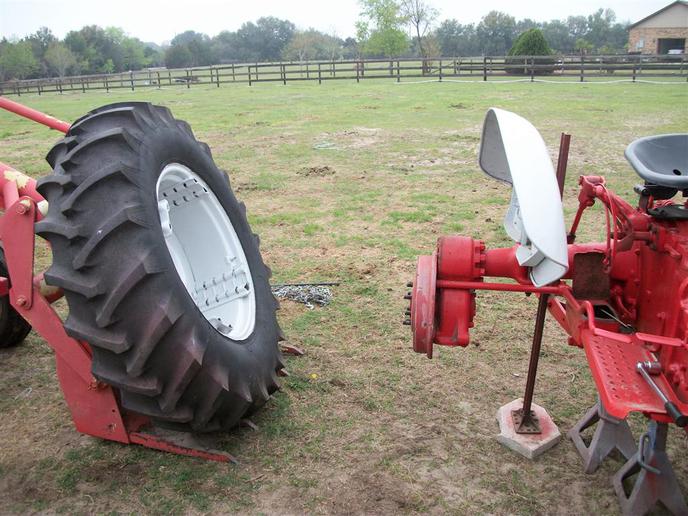

The 900 series tractors are "row crop" models. If your tractor is a 900 model, it can be easily identified by the rear axle. It will have final drives that drop the wheels down from the rear axle about 6" by using two extra gears. The 800s have a straight axle, and no final drives. 900s could be tricycle type or wide front, but all 900s sit higher and are considered row crop tractors. A rare high crop version of the 900 was also availible and is higher yet.

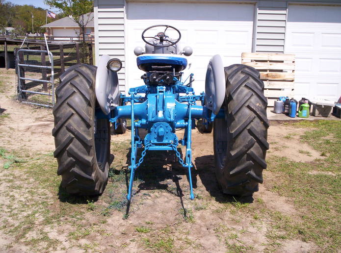

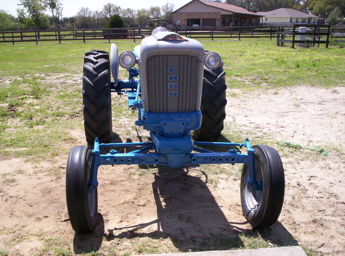

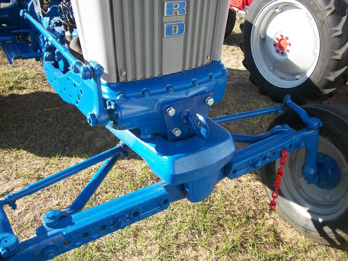

here's a pic of my 63 4000 which is essentially a updated 941 has the ford wide front end.
last pic shows another of my rowcrops, a 950.. shows you the drop 'bull' axles and the brake hub, while i'm changing a tire.

ps.. the one you are looking at would be a 941-D-5 if it was a 4spd and wide front from the factory.. post pics if you are unsure.

yep.. older ones used a single piece pedistal.. newer oneds use the 2 piece as shown.. all had the drop axles in the rear..
