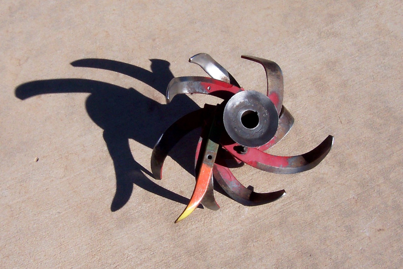

I'm also making a modified tine cluster. I will be combining some tractor tines sistered up with the original tines which will allow me to get down another 2 inches. See the attached prototype. I have yet to add the remaining 15 tines.

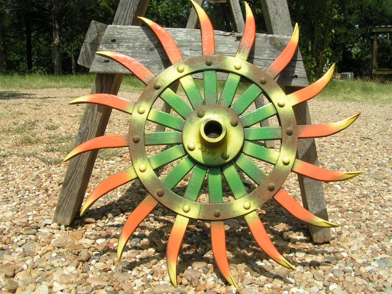

The second picture of yours is a rotary hoe wheel. Looks to be from a John deere 400. They are for blind cultivation on corn and beans before the seedlings emerge. They're also for breaking crust if you get a hard rain after you plant, but before the plants emerge. They are not meant to be powered, but run at around 5 mph with no down pressure. I have a 400 and use it as such.

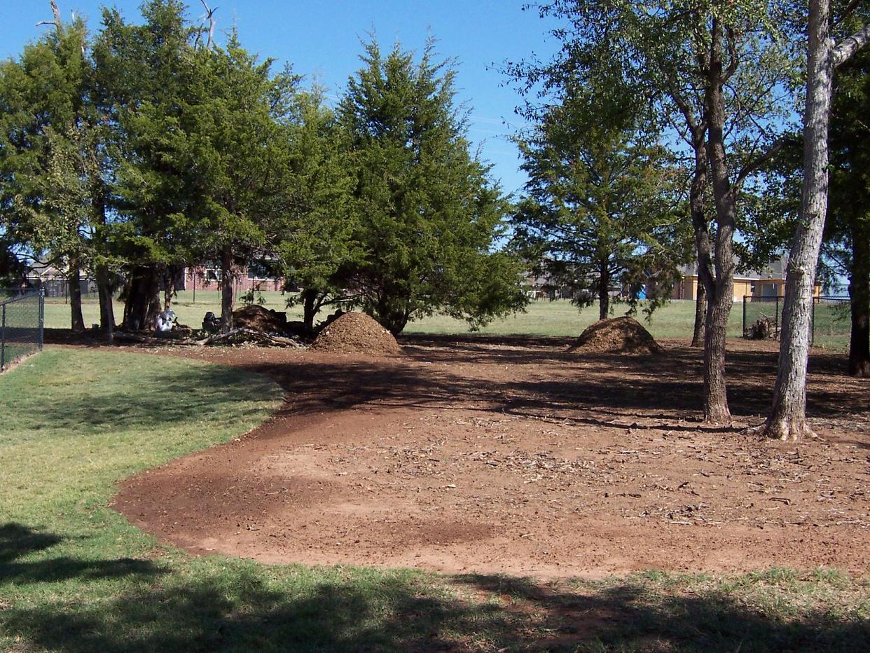

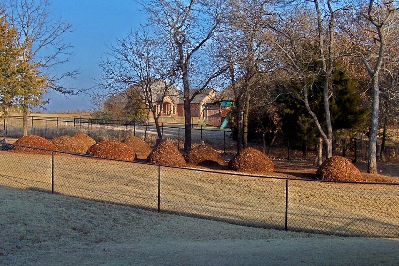

Thanks for the heads up. I noticed when I was drilling the JD tines they weren't hardened and figured they would break off pretty easy if I subjected them to hard use. I use a lot of home made compost in my garden to help break up the native clay soil and I'm hoping the JD tines will reach down furthur into the soil. The plan is to use the JD tines after I perform the initial spring till with the regular heavy duty tines.

If you ever get to try a BCS with the rotary plow you will be impressed how easy it goes down 10" to 12" even in hard clay. Secondly be careful adding more load to the TroyBilt tiller drive as the brass gear wears rather quickly in really heavy going. They even have been known to split in two. I used to rebuild the TB transmissions every year for someone who tilled gardens for hire. The life in his usage was about 400 hours using three set of tines and two or three belts. He charged over $40 on hour while tilling so he considered the $1000 he paid me for a rebuilt tiller with a new engine was a bargain.
   / 83 TroyBilt Horse with 13 HP Honda #15
If you get too much more bite with different tines, the tiller may propel itself forward on the tines.
