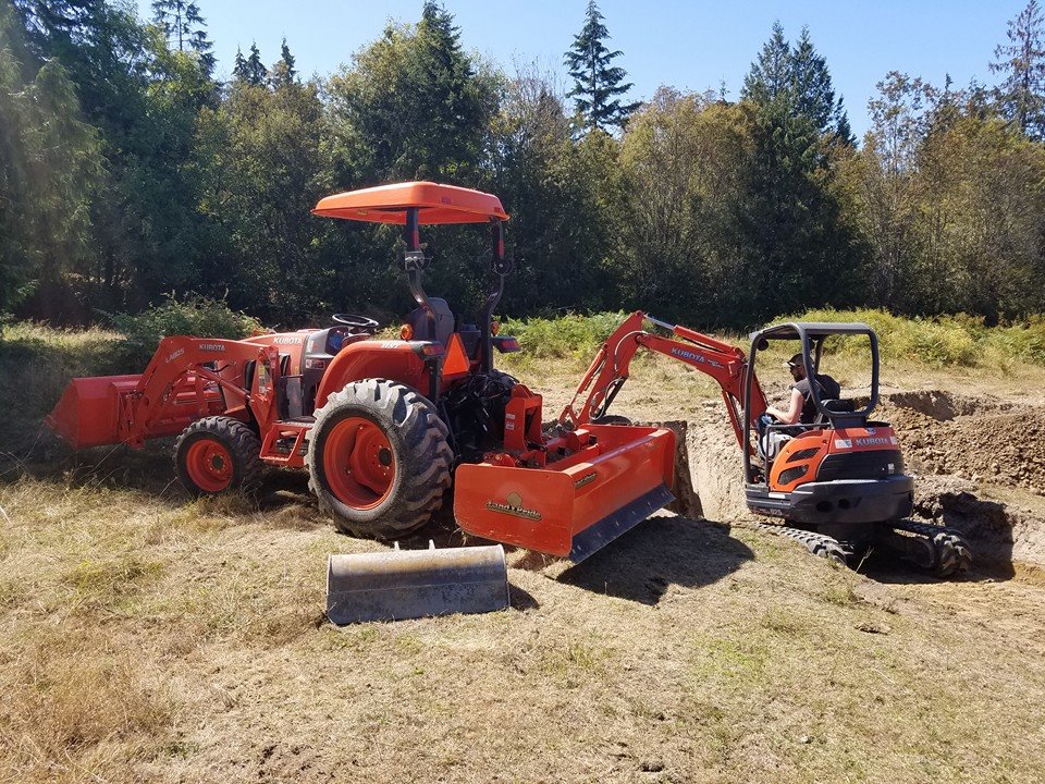

I need a bigger brush hog, my 48" is a joke on this L3560 i have, looking at a 72" or 84" But looking for advice on which one to get, the tractor seems to have a crap ton of power
Pic for fun
