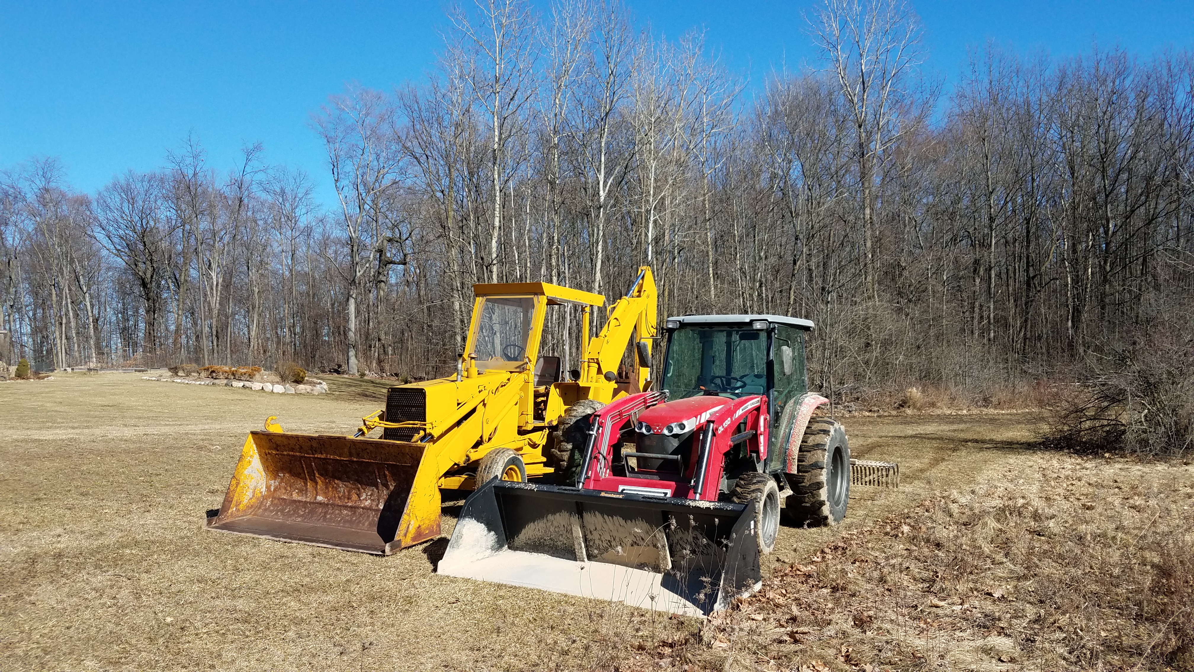

I got stress cracks in the factory massey loader. Numerous front axle issues. Dealer finally admitted the are having issues with front end on tractors with heavy loader usage. Now according to you the relief valve should prevent me from lift anything that should damage the loader or the tractor. Well I can basically throw that idea out the window. When you got a bucket of dirt up on the loader and you go to turn the wheels and the steering cylinder breaks something has a design flaw because according to you with the relief valve should prevent prevent you from picking up too much. You digging and you are using 4 wheel drive for added stability and traction. You got a bucket full of dirt and you try to back up. Pop, there goes the front axle. With the relief valve, you shouldn't be able to lift enough to cause a problem. If I own a 30 hp 4 wheel drive tractor with a factory loader and five bucket and can't dig a hole with it, then it is not much of a tractor. Guys that really use their tractors have had problems. I 've seen it, a guy have a loader rated at say 2100 lbs and he's feeding a bunch of cattle and setting 3-4 big round bales per day. The continual weight, stress and flex of that type usage and next thing you front trouble and or loader trouble. He never over loaded his loader. The Brute strength you need just isn't there despite what some salesman at the dealership tells you. My guess is that probably 50% of the people never really work their tractors heavy. That is why I contend that in town or a little 10 acre plot my mf 1531 would probably be ok. And why do you suppose out here in the heart of ag country you are seeing much of anything but mostly John Deere and case-ih??? Are we just a Bunch of hay seeds that don't know nothing about tractors???

I definitely agree that the build strength of the loader on my Ford 550 backhoe from the 70s is way heavier than that of my 2012 Massey compact. However, your experience seems to be isolated. We don't hear many people damaging their loader assemblies or front ends by using the loader. Yes, we do hear some, but they are few and far in-between. I will say that in the 1000 hours I put on my 52hp Massey compact, 75% of those hours included loader use, most of which were heavy usage moving heaping loads of dirt and gravel. I use my machine commercially. I don't baby it. And yet, I haven't damaged my front end and my loader still looks great and functions perfectly.
I'm not saying that post to state how amazing my machine is. I'm saying that to prove a point. Machines in this class are fully capable of being used to their limits for extended hours without breaking. There are many operators on this forum who use their machines as heavily as I do without damaging the loader or the front end. Your experience with your small compact tractor is not consistent with the experiences of most other people on this forum.
