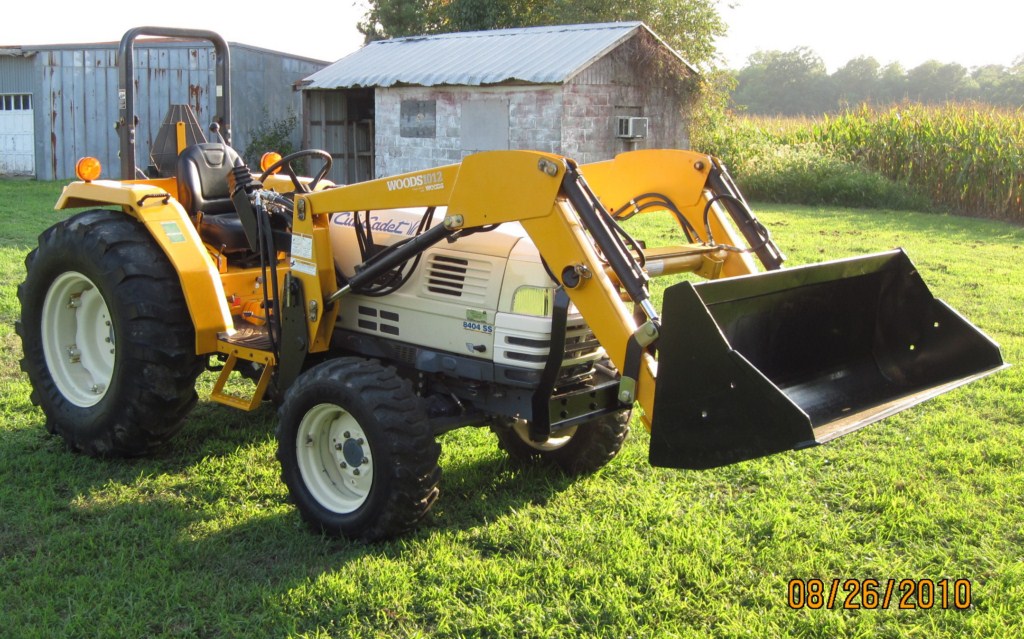

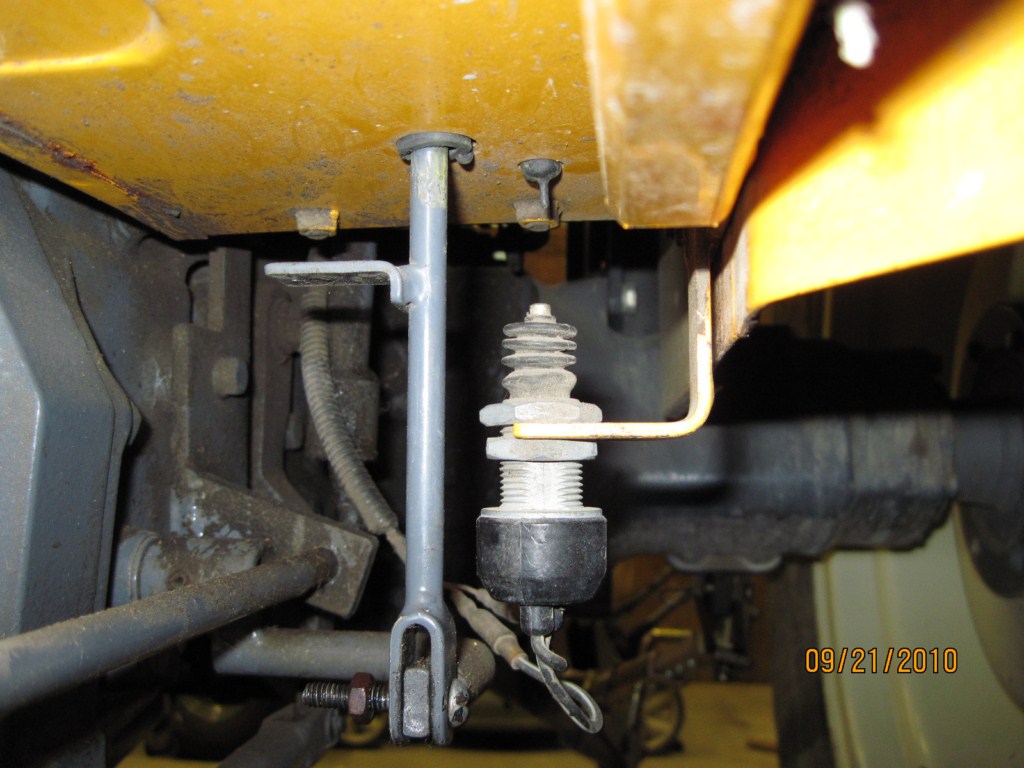

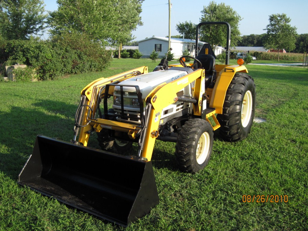

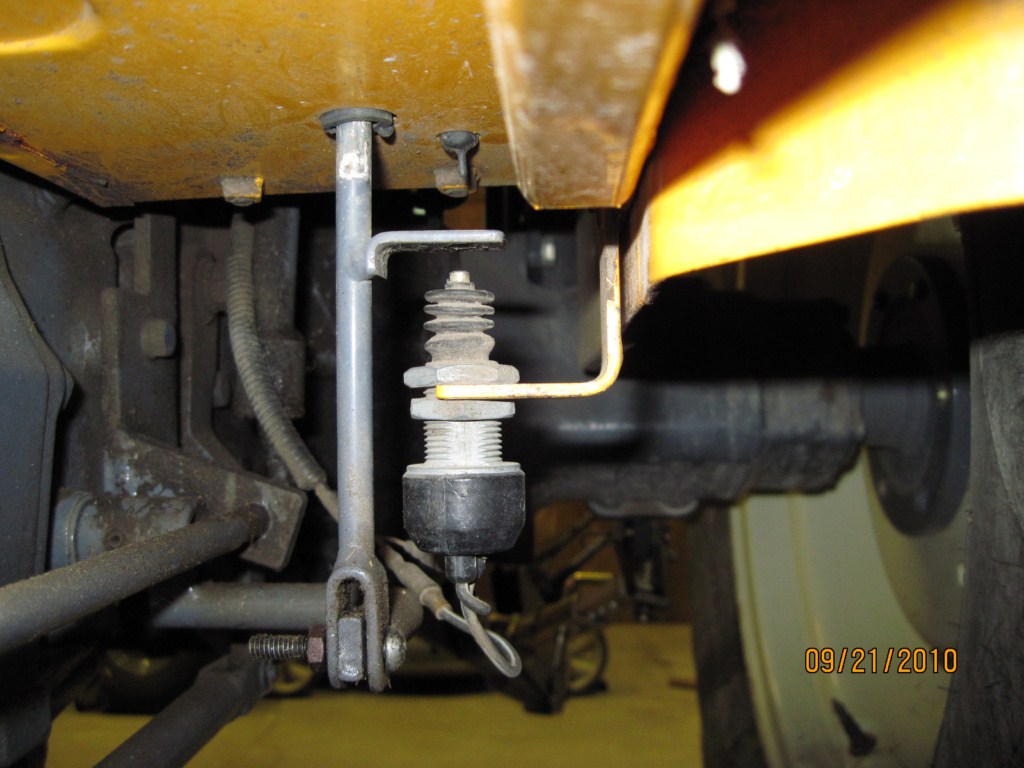

Here are the pictures of the 4wd lever being installed backwards and then reinstalled correctly. I have no idea why the previous owner would have had this turned around. The lever now engages the switch and the 4wd light comes on. Also attatched a couple of pictures of the tractor. First real tractor I have ever had, so I am very excited to start putting it to use.
