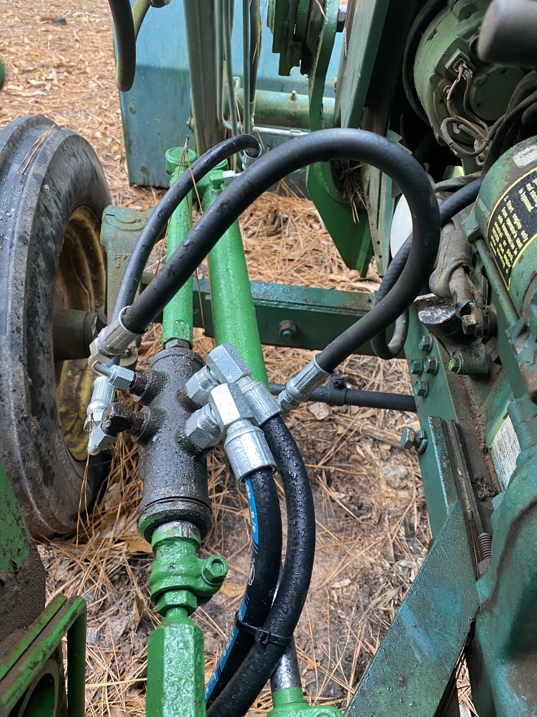

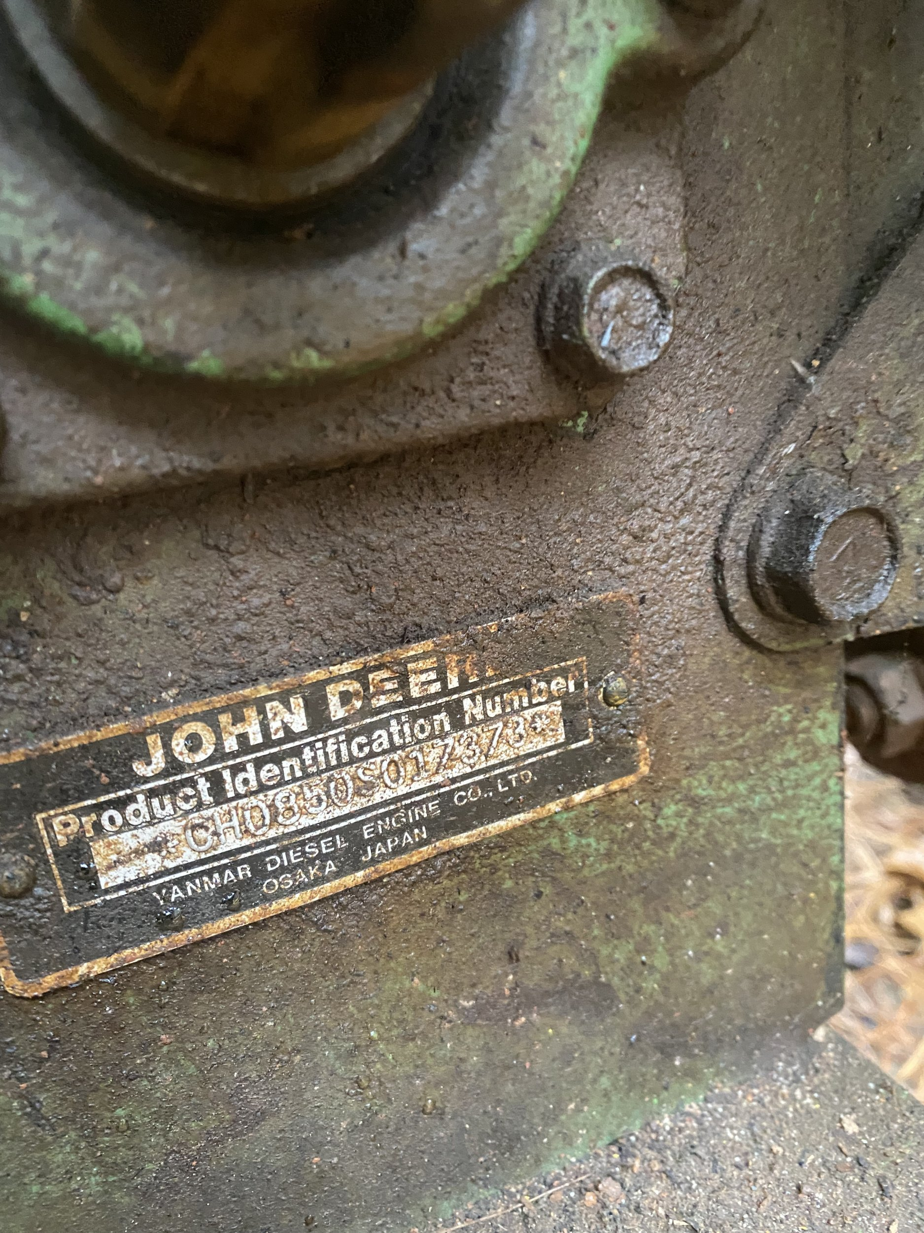

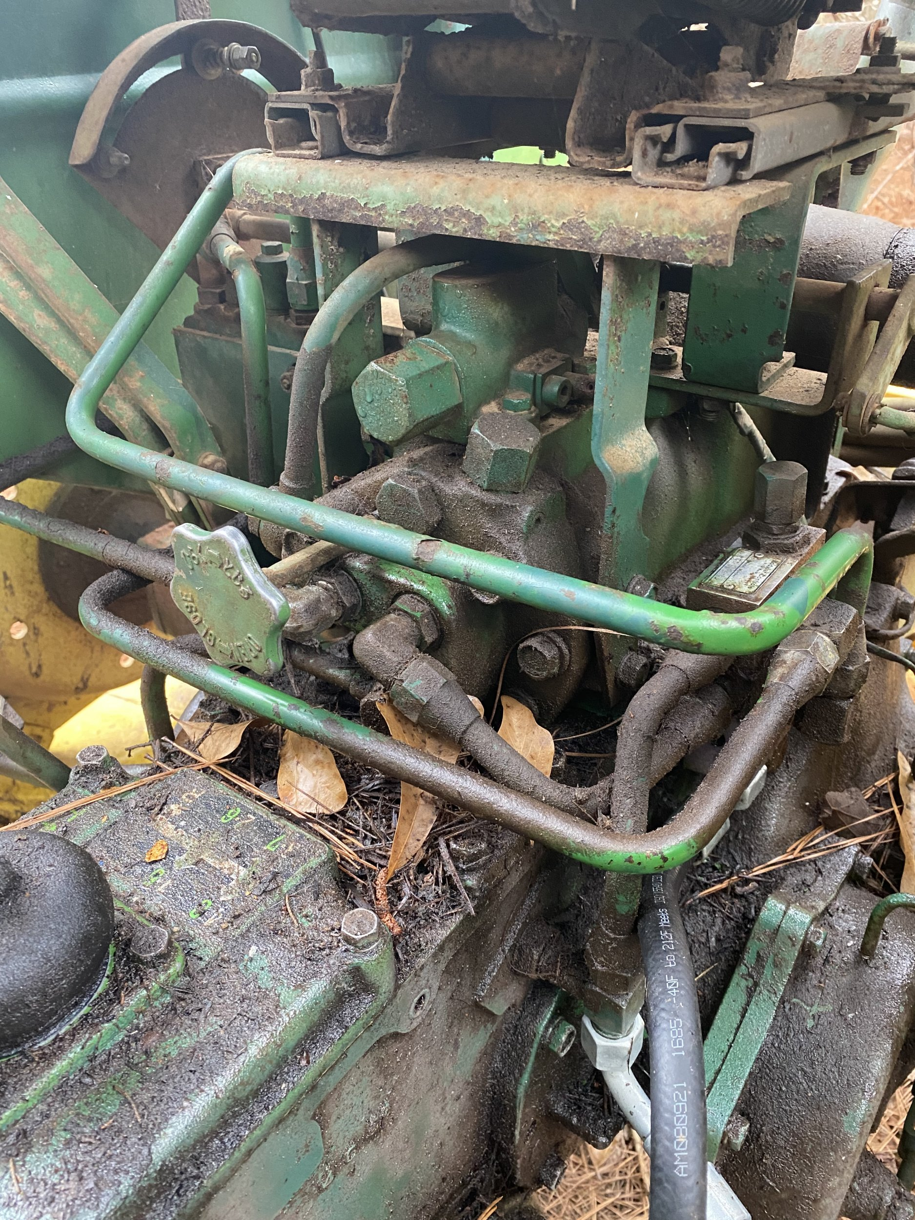

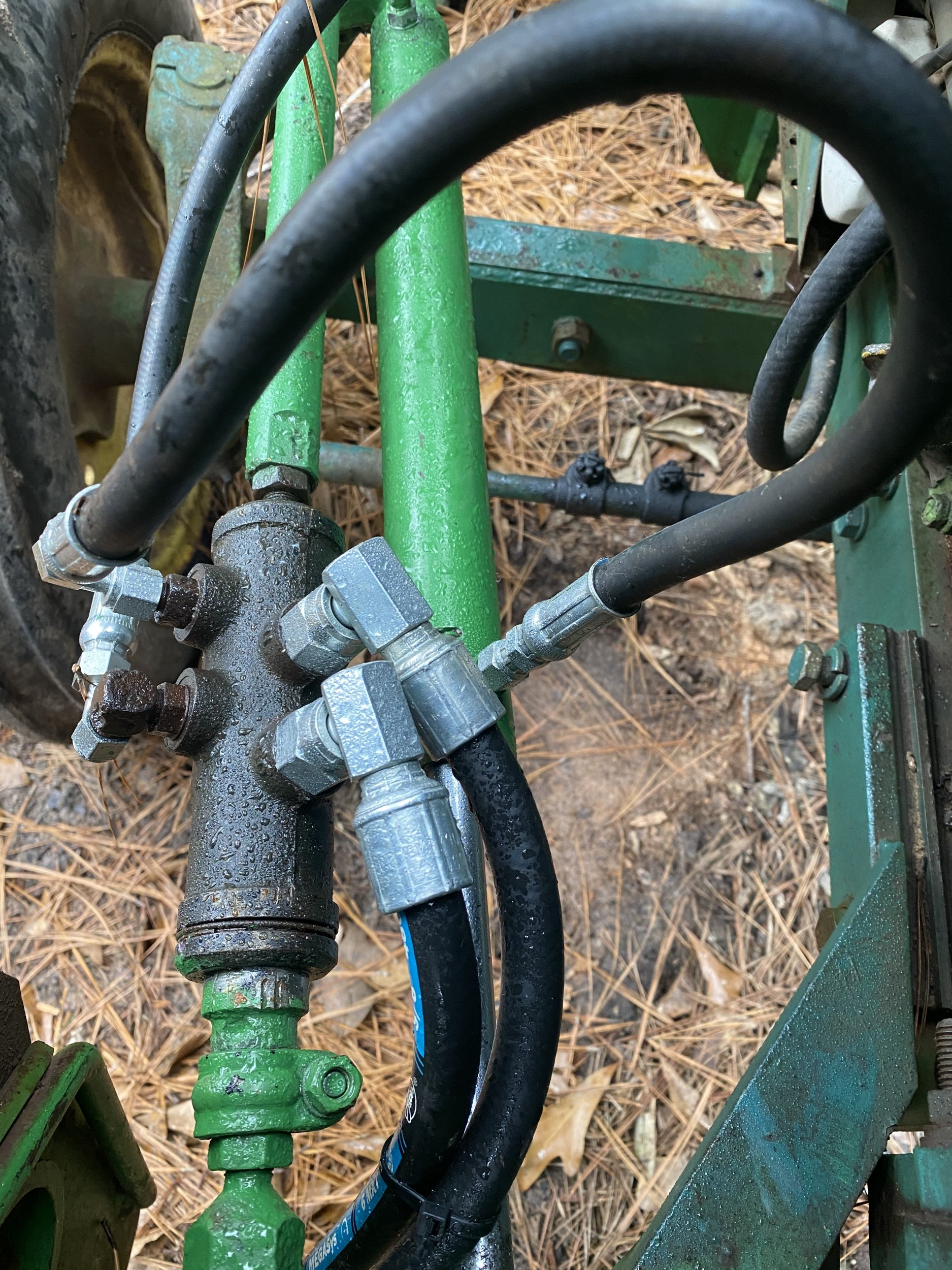

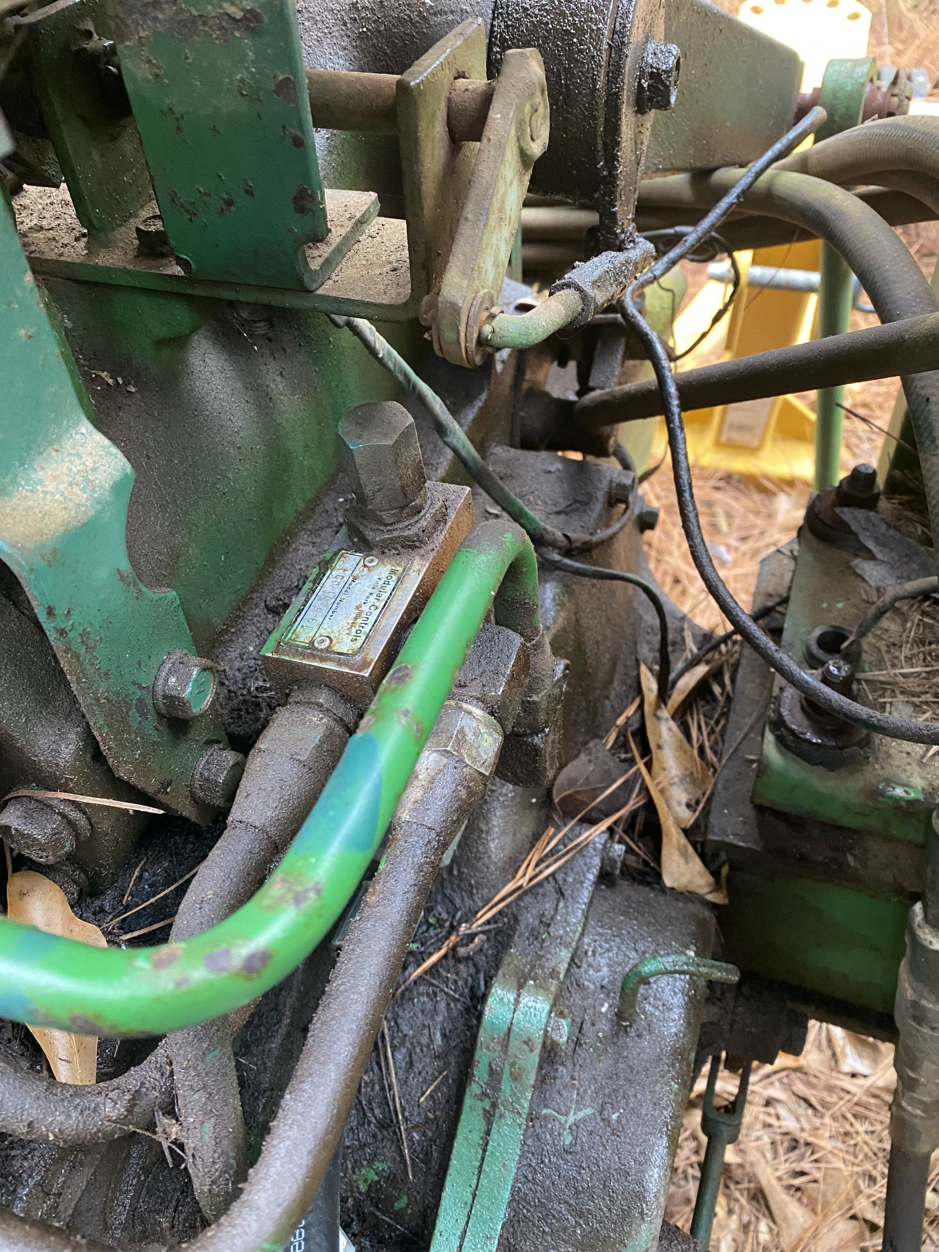

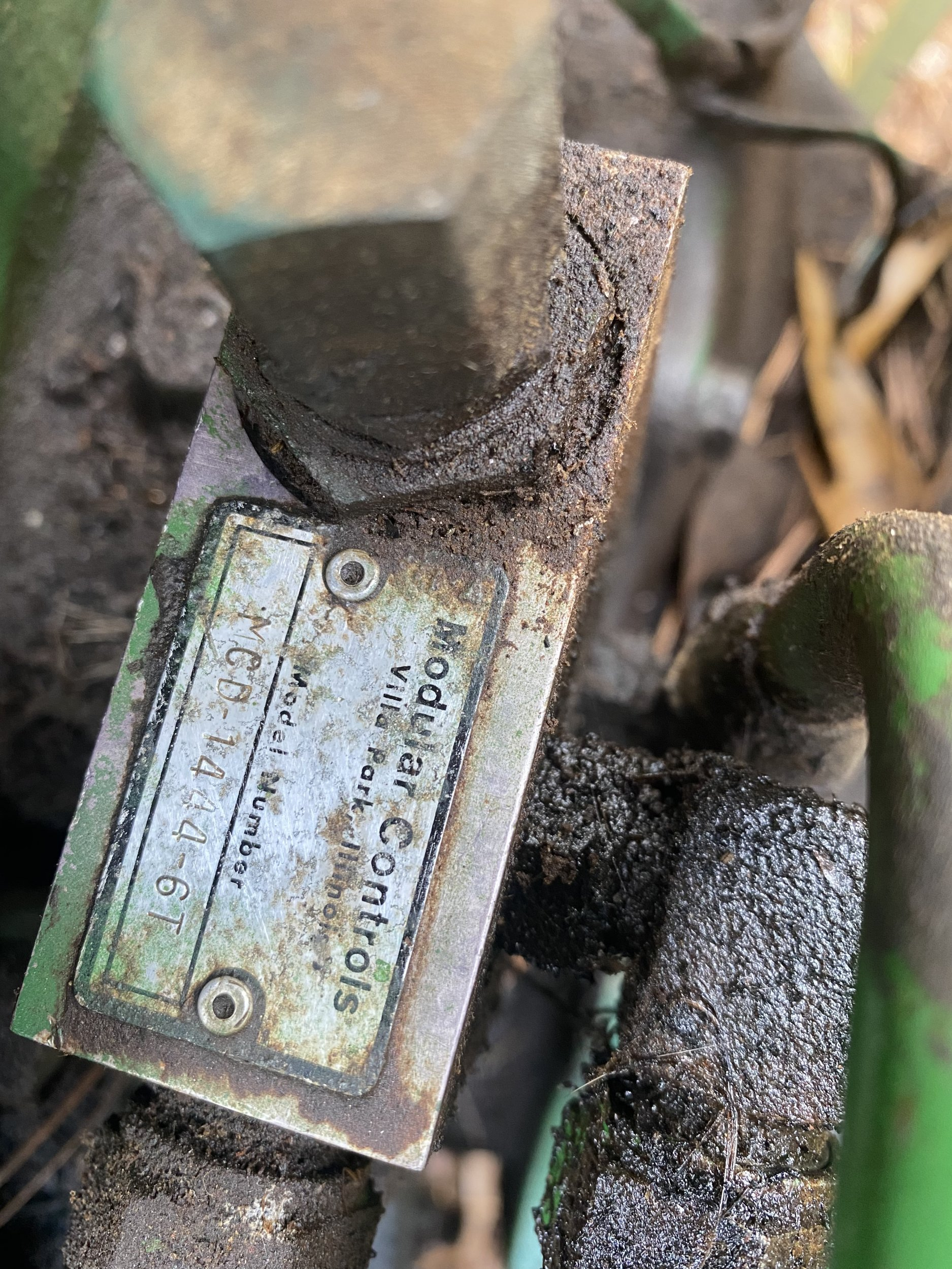

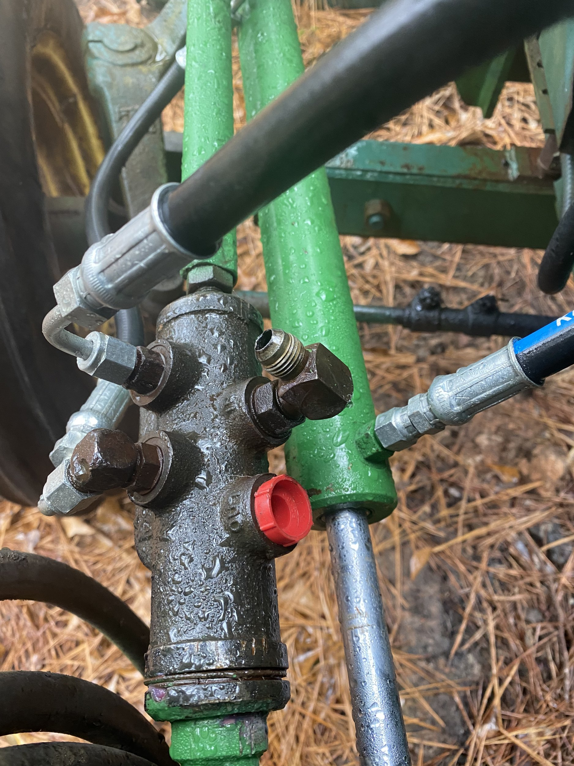

This was a complete headache not having the hard lines, adapt and overcome comes to mine

I just bought the same valve. I found a site called "fastline". It showed me all the salvage yards that have a 950 being parted out. I called them all. I got a person at Macfaddens in upstate NY. They had one and had just shipped out another one a couple days earlier. I looked like their listing contained almost all john deere 950's being parted out. Call around till you find one. I called all the usual standby tractor salvage yards with no luck. I'm glad I found this posting and my part. Unfortunately it didn't solve my problem.
