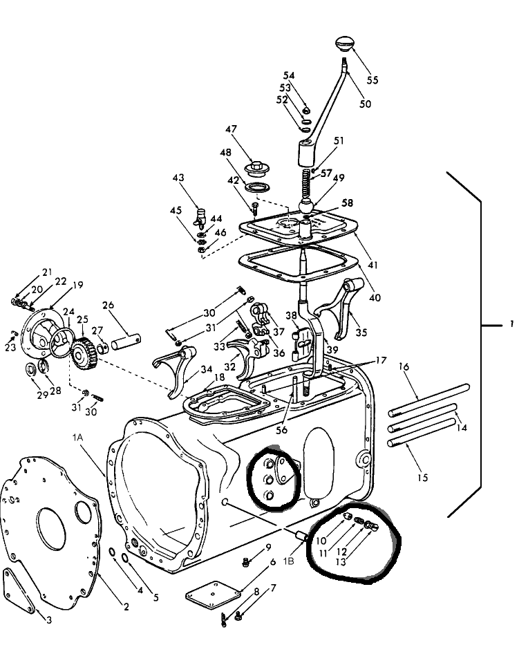

I’ll have to look at my tractor later tonight and let you know.
   / 850 Jumps out of gear #12
You should be able to access them
   / 850 Jumps out of gear #13
Rarely its the detents, unless excessively worn.. Bearings? More likely, especially if it likes to jump out when you go downhill and the trans overspeeds slightly.
   / 850 Jumps out of gear #14
The thrust washers must be checked as well. If worn, the 3rd gear on the lower shaft will rock (not maintaining axial alignment with the shaft). This was the cause of my 860 jumping out of gear. I know this because I replaced the bearings and then had to tear EVERYTHING back down to fix the thrust washer issue.
   / 850 Jumps out of gear #15
Agreed, if you go into the granny, check everything. Go big or go home.
   / 850 Jumps out of gear #16
I can access the two lower ones but I only can screw out half way before the footboard stops them. You are right Probably not the detents though. It comes out of third as soon as you let the clutch out. Will stay in if you put alittle pressure on the shifter.
