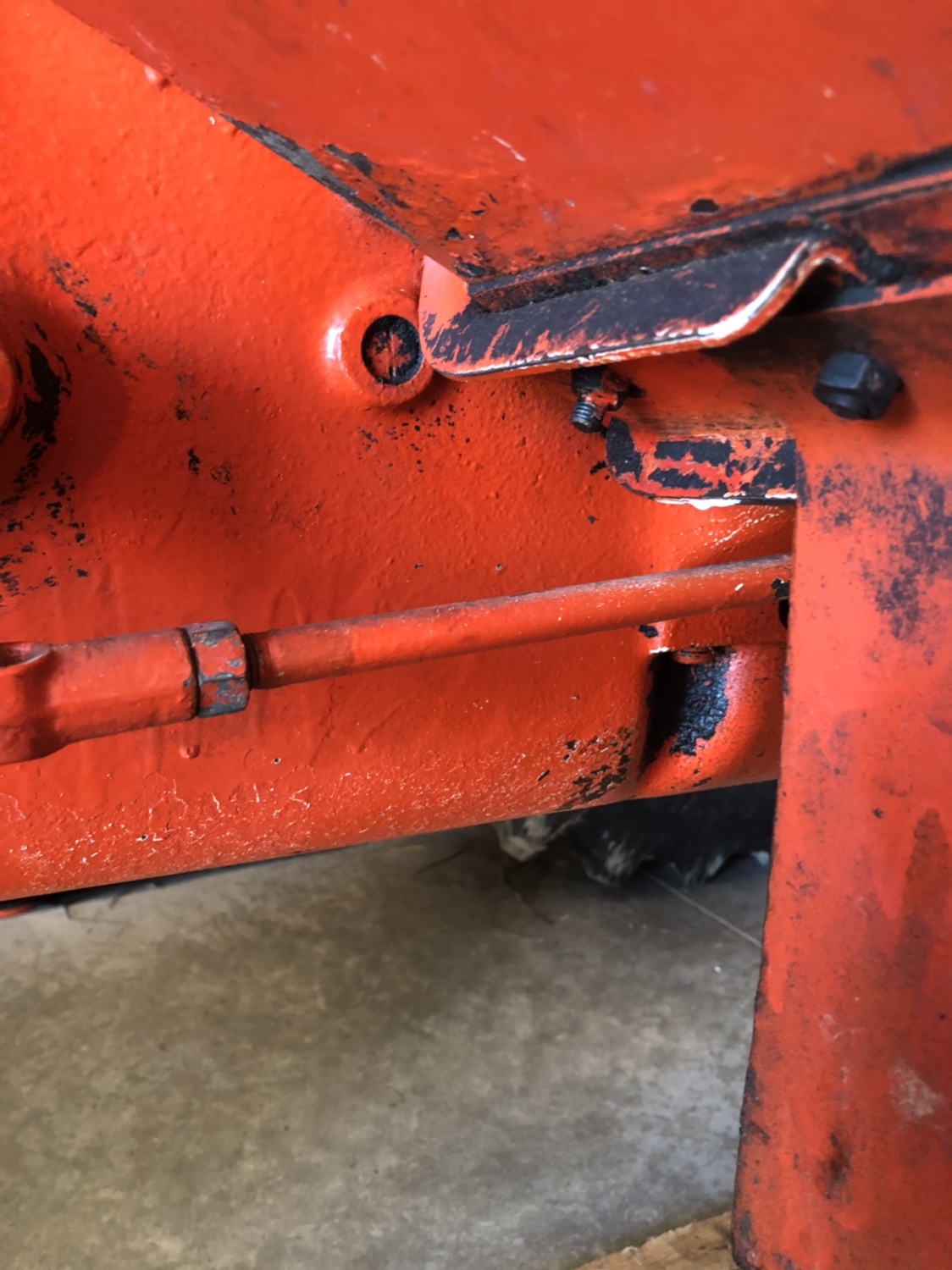

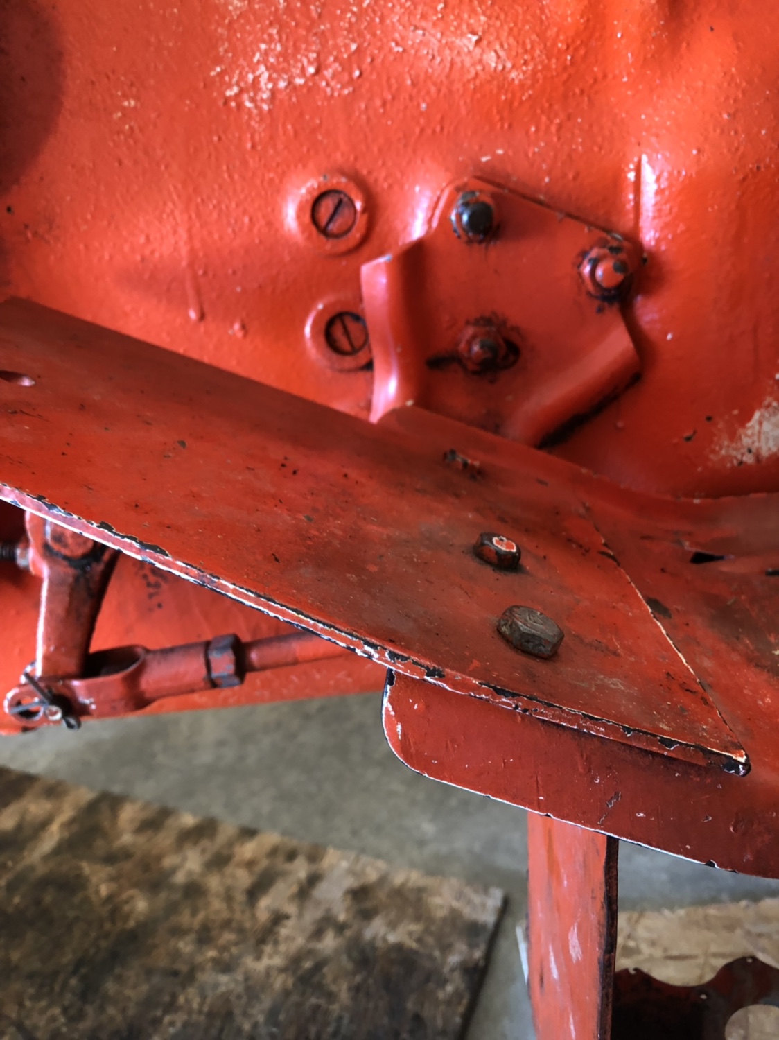

I can access the two lower ones but I only can screw out half way before the footboard stops them. You are right Probably not the detents though. It comes out of third as soon as you let the clutch out. Will stay in if you put alittle pressure on the shifter.
   / 850 Jumps out of gear #17
Post a pic of your running boards.
   / 850 Jumps out of gear #18
I finally remembered to take a picture of my tractor. Looks like 2 of the 3 are accessible and one would be close but probably easier to remove the step.
   / 850 Jumps out of gear #19
someone bolted on an extention to your running board.
   / 850 Jumps out of gear #20
Yes, makes it a little more comfortable.
