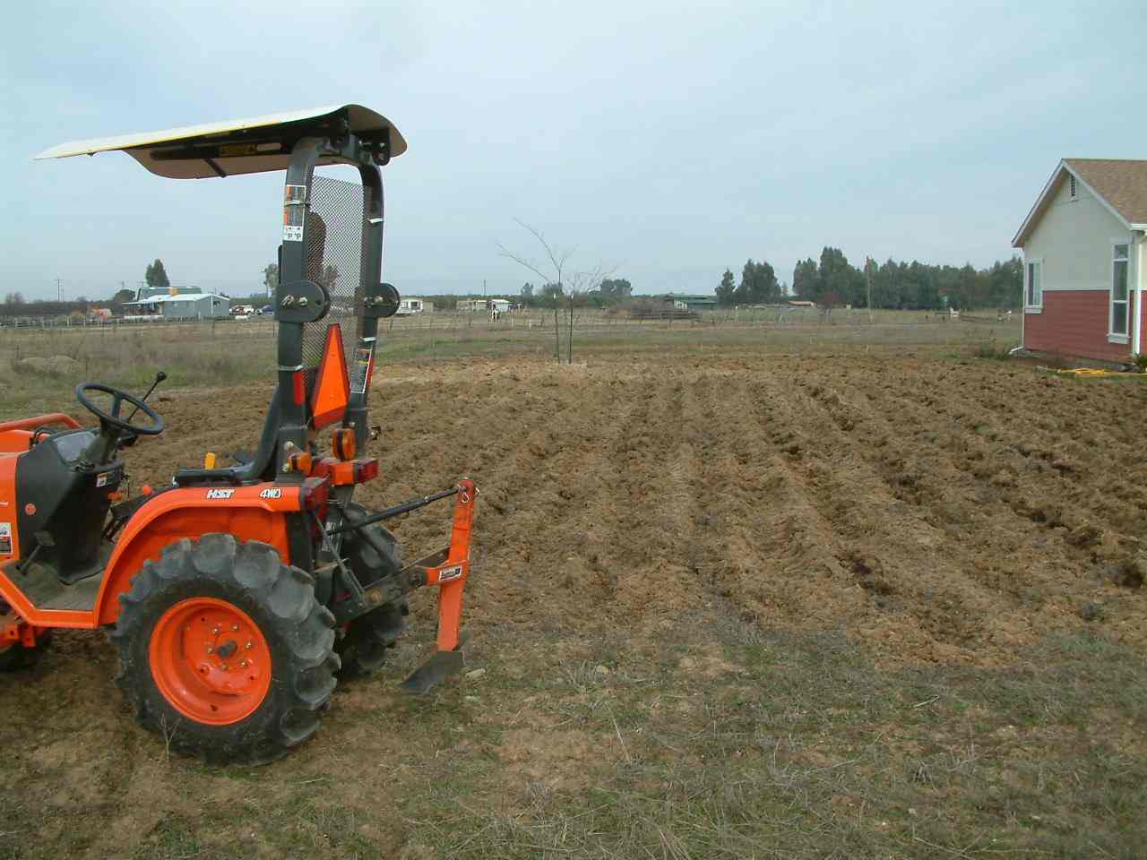

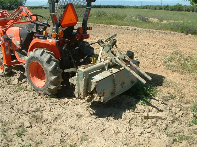

When I landscaped my new house a few years ago, I bought a used Yanmar RS1200 rototiller (48" wide) to use with my 2005 Kubota B7510HST tractor. That tiller is a light weight unit designed for use in the rice fields. It really bounced around on hard, dry ground. I had to use my middle buster plow to break up the soil and then follow it with the tiller. The hydrostatic tranny is a real help with that tiller because you can just crawl along and give the tiller a chance to do its thing.
Hope this helps.
Good luck.
