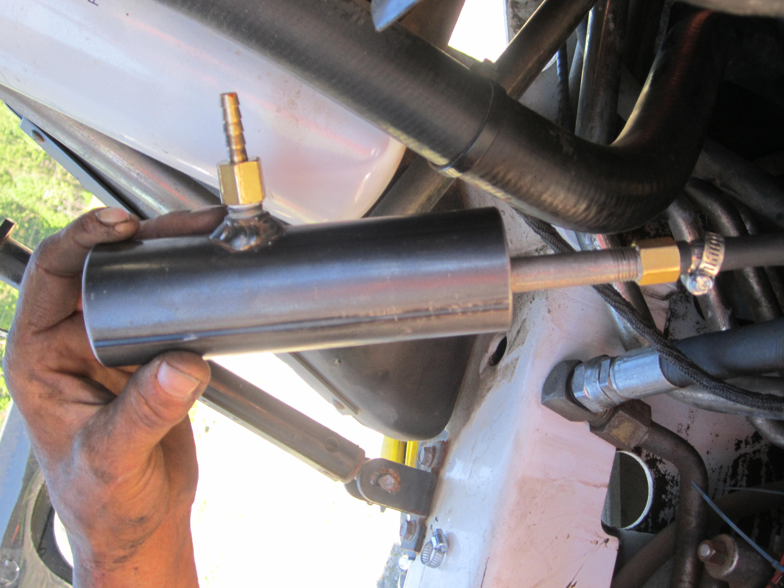

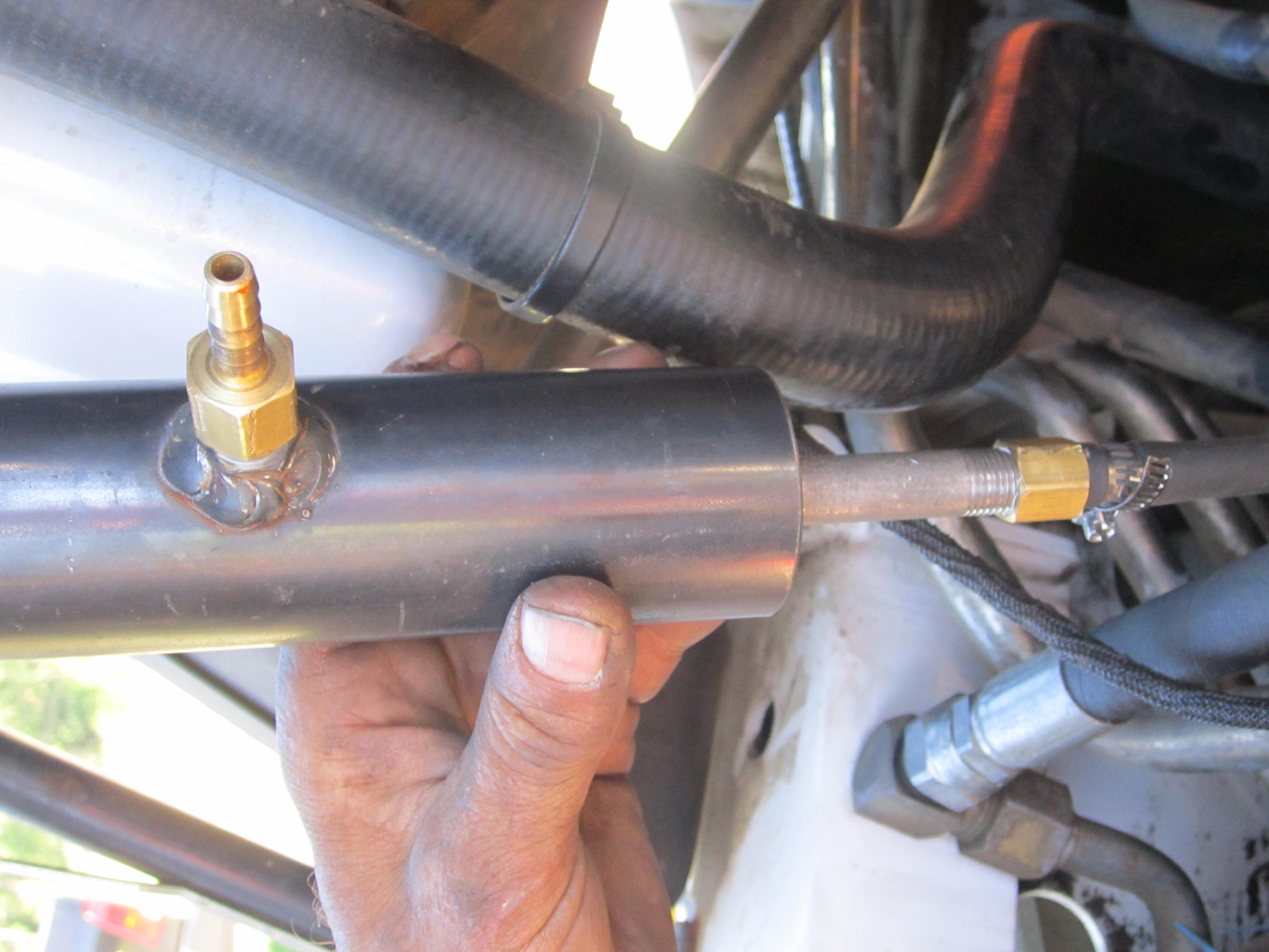

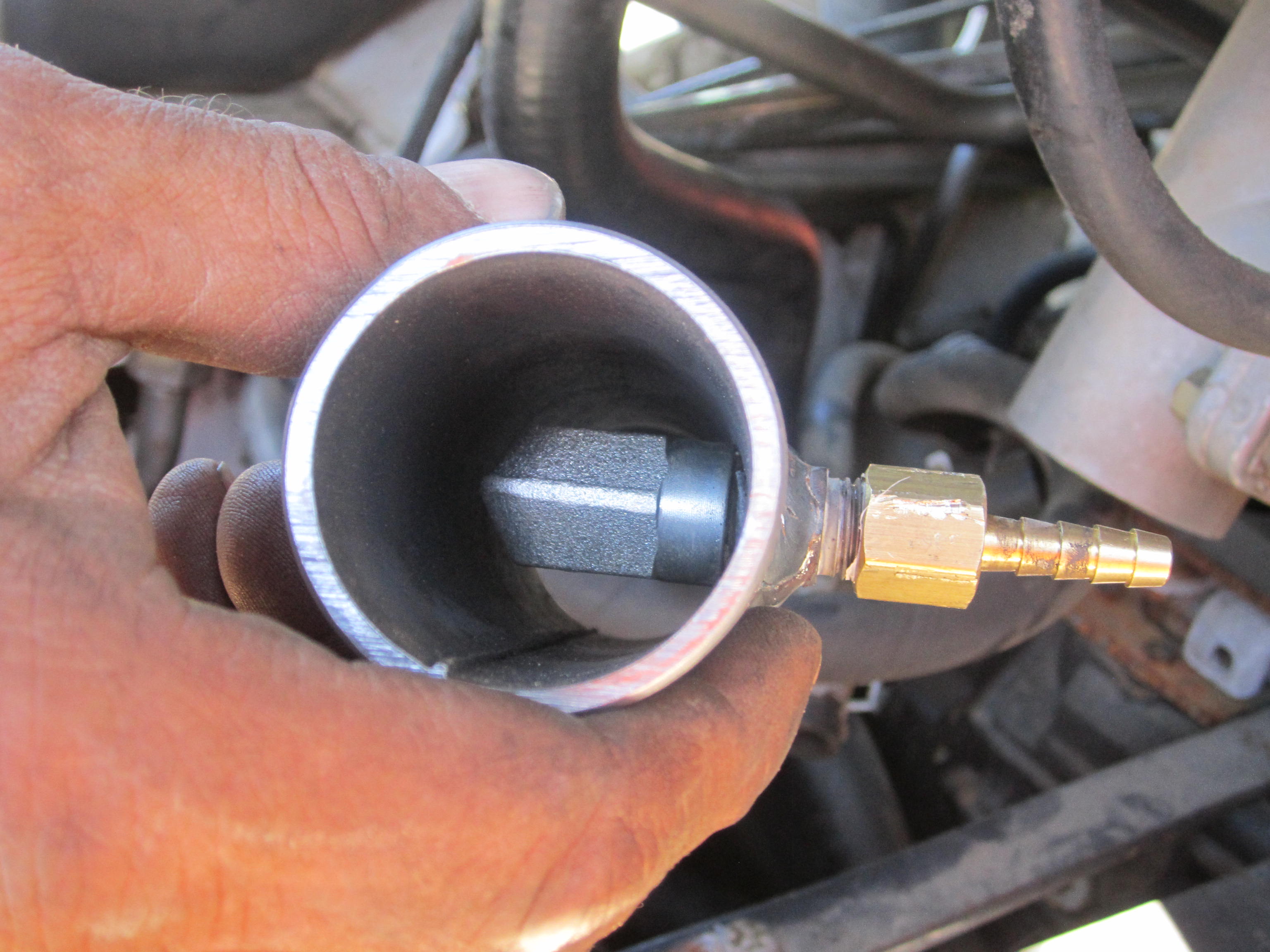

   / 863 Fuel pickup #18
Stole Mogman's idea for my T300- seems to work great. Had a local shop do it for $70, cut the fuel inlet line, just ran 1/4 inch fuel line
info the tank. Seemed to work fine.
