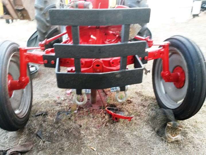

This is my front bumper grill guard I made.
the material is t1 steel the bottom bumper part is 3/8 by 4 " t1 the guard slats are 1/2 by 3 T1 the verticals are 1 1/2" sq bar then I placed tow shackles underneath
