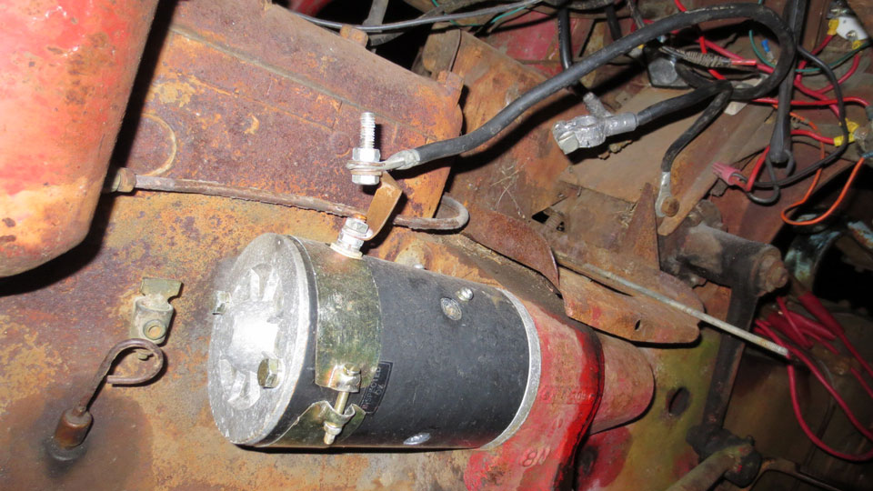

Starter is held on with 2 ling thin bolts, ground ti the chassis is thru connection, solenoid mounts to the starter.
Us it a 6v starter?
   / 8N Electrical Issue
#15
Us it a 6v starter?
I don't actually know if its 6V or 12V. The original was of course 6V, and this replacement acts exactly the same.

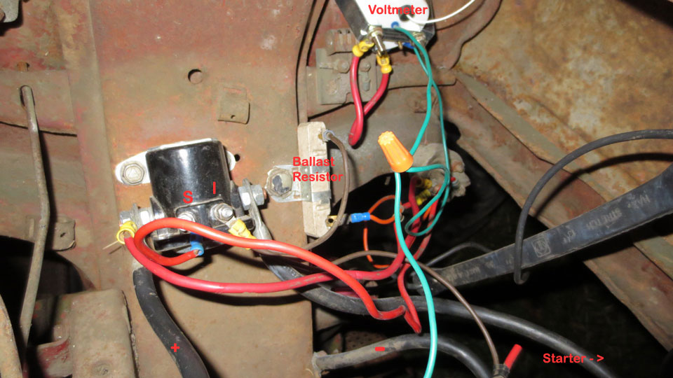

Here are pictures. My solenoid is not mounted on the starter. I have seen both versions in pictures. I had taken the battery out to have it tested at Wal-Mart and it had good voltage and good cranking amps. There is usually a battery in there...
Also ignore the voltmeter wiring. It was hooked through alternator #1 wire which I removed from I terminal just to make sure the alternator wasn't causing a short or something

A) The "I" terminal in the solenoid is to give a 12 volt shot to the coil when starting only to get things goings, your wiring has a resistor in line. If your coils/points/condenser is converted to 12 volts then it isn't getting start voltage. If the ignition components are still 6 volts and you are using 12 volts,on them, then they won't last long and may even cause starting problems.
I usually have seen the resistors in the main coil hot not the solenoid feed.
B) the solenoid, make sure there is bare metal and a good conductive paste between the solienoid and the mounting bracket for the solenoid, make sure it is tight. The mounting bracket is the ground for the solenoid.
C) The starter connections, eliminate the brass strip between the solenoid wire and the start post, too many connections. Also, as LD1 and I have suggested run the extra ground wire to one of the starter mounting bolts to give the starter a better path to battery ground and not depend on all of the poor connection through the chassis and other components.

8n don't use bypass solenoids.

Scrambler82, the brass strip came on the starter like that. I had broken off the stud on my old starter overtightening it so I just used the brass strip as it was there. I did take it off for a more direct connection but starter still does not spin.

having low, near zero ohms from starter stud to case is normal. having 0 ohms stud to case is not normal.
the starter is pretty much 2 big balls of copper.. you don't want alot of resistance to ground thru the armature. field has some.. but not much. Consumer grade VOM's may only tell you a very close reading when you get down to 4 ohms or less.
that said. if it says 0, pull the starter for a looksee. never know you might find a bad brush connection or other problem.
