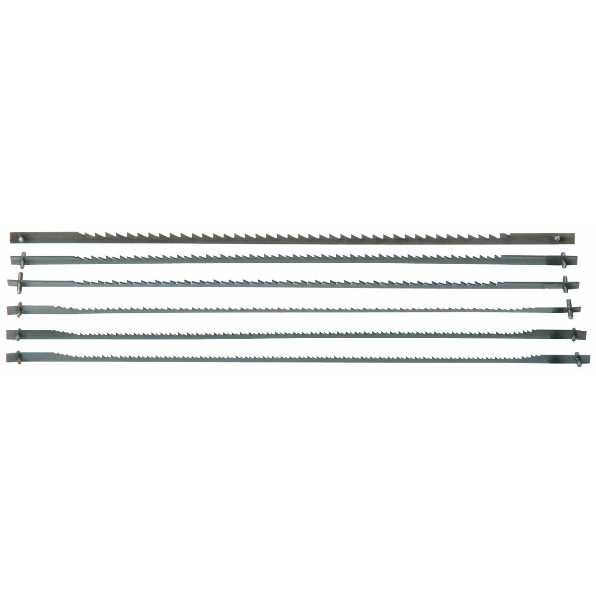

Try to pull it out with the smallest available scroll saw blade, with one blank end broken off.
Bruce
/ 8N key broke in ignition #4
Bruce
Done that and it really works!
(Idea did come from TBN.)Use the finest blade you have.
It is sort of like many tiny fish hooks and really works.
You then bring the 2 key parts to a locksmith (or even big box store) and they can copy.
