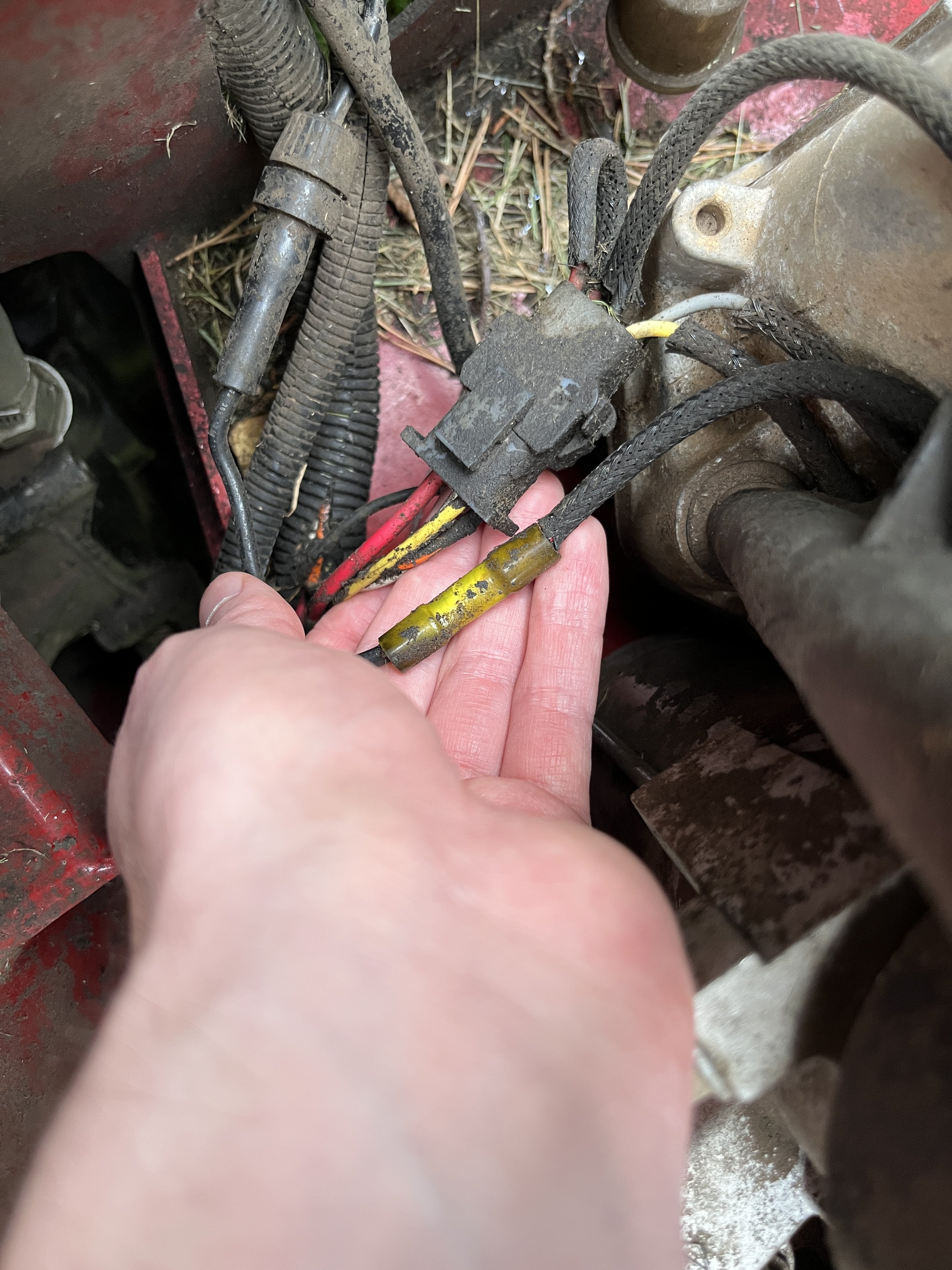

Voltage regulators are almost always wired hot. Meaning not switched. The VR is suppose to shut down the path. If you unplug your VR after you shut it down, and no more draw, there's your issue.
Sorry if this was already mentioned but is there an easy way to determine if something is drawing from the battery when it is not suppose to be?

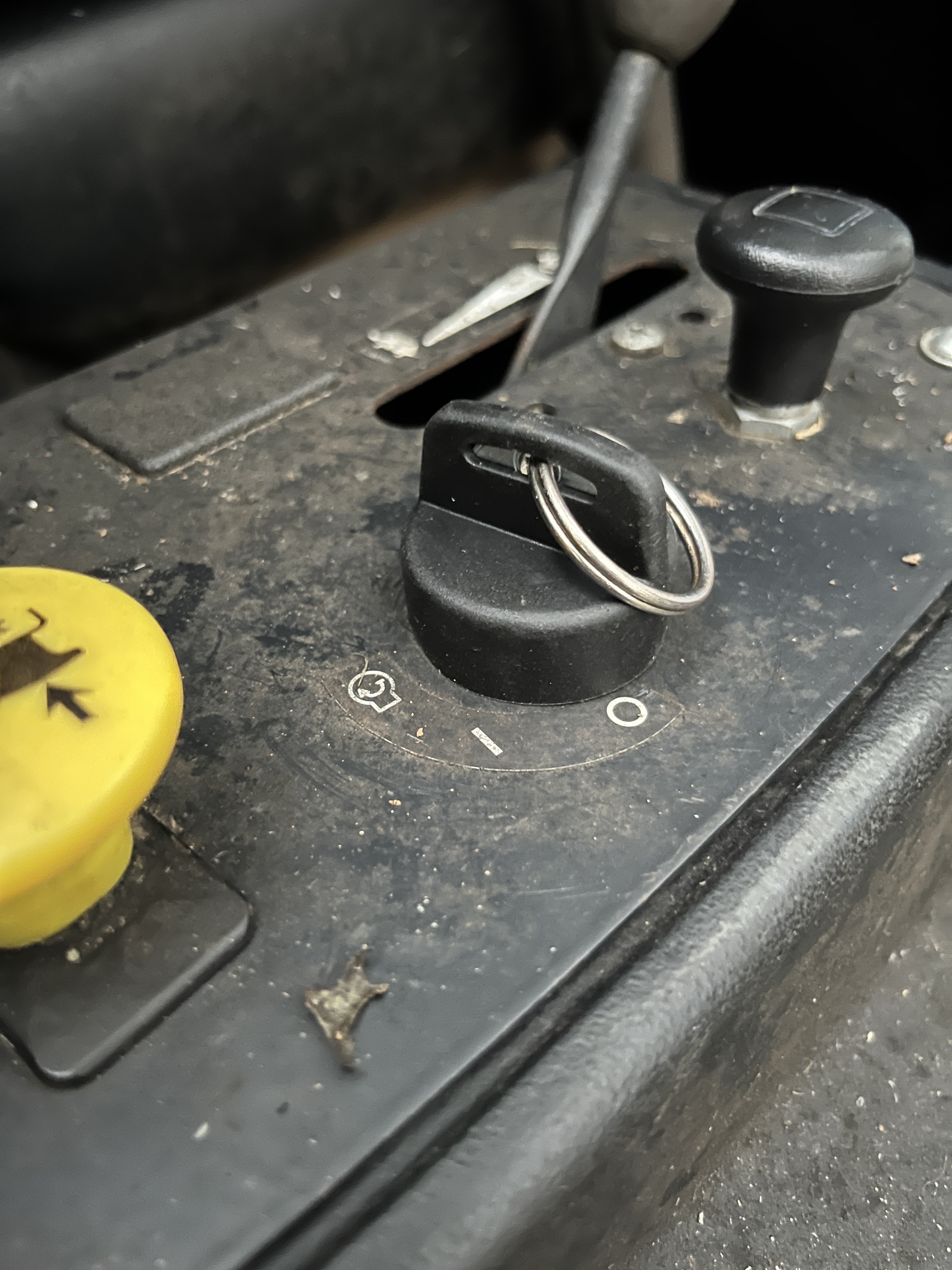

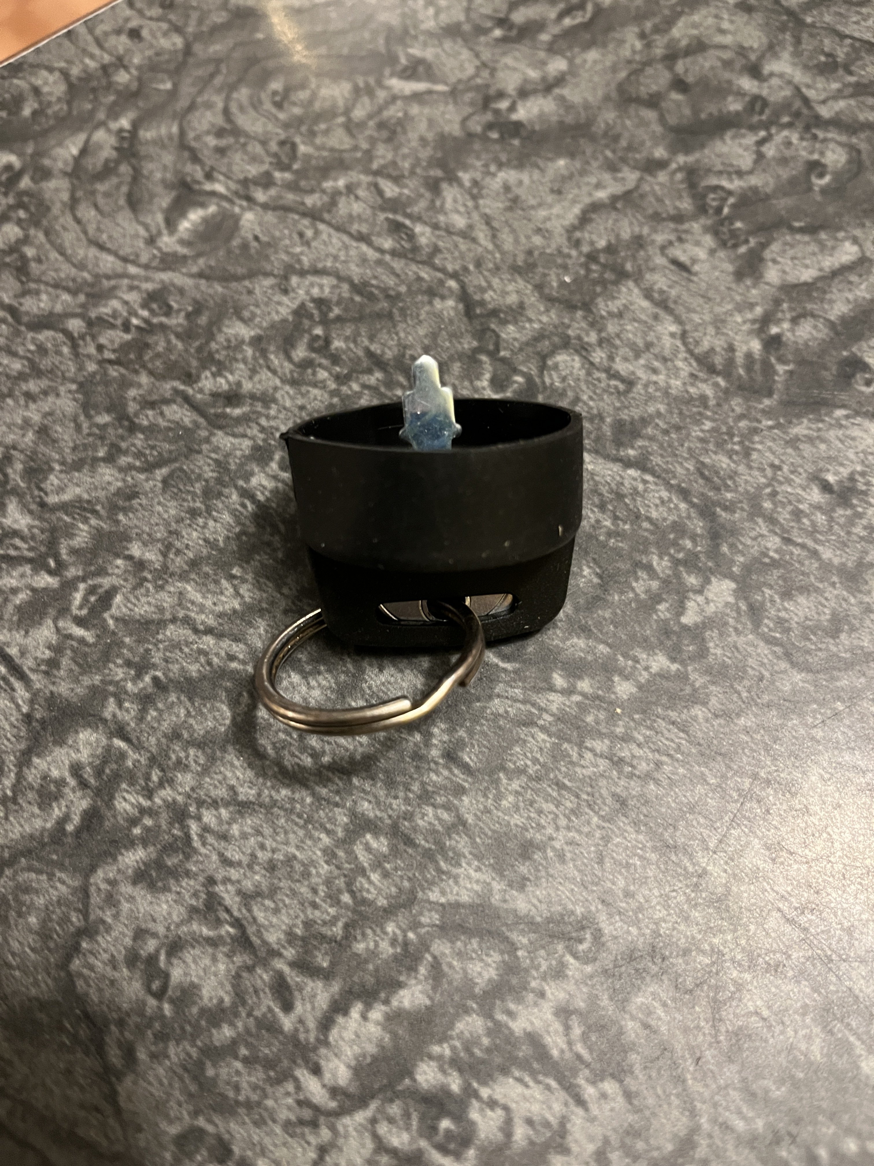

Ferris IS1500Z, replaced the key switch. Symptoms - Starter would only click when trying to start, after several dozen attempts it would start. Lost 2 keys out of the switch (old and new) when trimming around pines/cedars. Affixed lanyard to key attached to mower throttle.
Sure. The easiest way for you is to just unhook the regulator connector and do a wait and see. Or should you have a multimeter, you can remove the - battery terminal and put the leads between the post and a ground. I'm sure YouTube could be your friend here. But essentially you would be removing a connector at a time to help isolate an amp draw. I personally start with the regulator , but good practice is to break it in to chunks. So, if you have multiple fuses, pull one fuse and watch the meter.
That's one way or simply to unplug the 6 pin engine connector or other main connector another. You can move the switch from off to on and see if the draw remains when off, which could indicate a worn key switch- but don't turn to crank as it will likely pop the fuse in the meter.

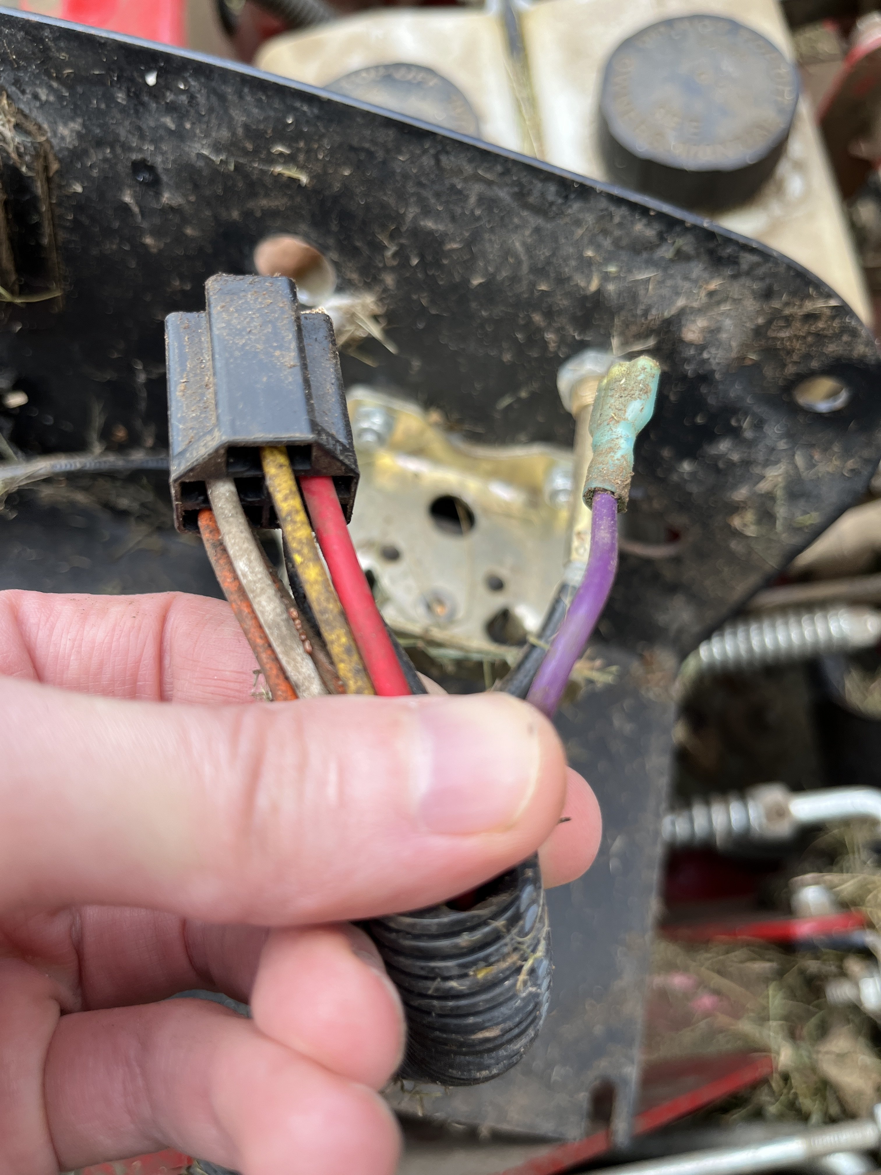

This is my issue. Mine does this exact same thing. You turn the key to start it and you hear the starter click but it does engage. It is especially noticeable if I realize that it isn't going to start and I need to let off the key to choke the mower. Usually if I give it some time or several attempts as you mention it will then engage.
I am seriously thinking about wiring a push button starter and toggle switch to my control board. That would be really convenient for me because of how often I need to turn the mower on and off. It would also eliminate the problem of stuff getting snagged on it like you mentioned which undoubtedly played a part in my ignition switches undoing. Watching people wire them sort of makes me uncomfortable though. Because it looks like you do have to leave the original wires intact and only tie into them to install the starter.

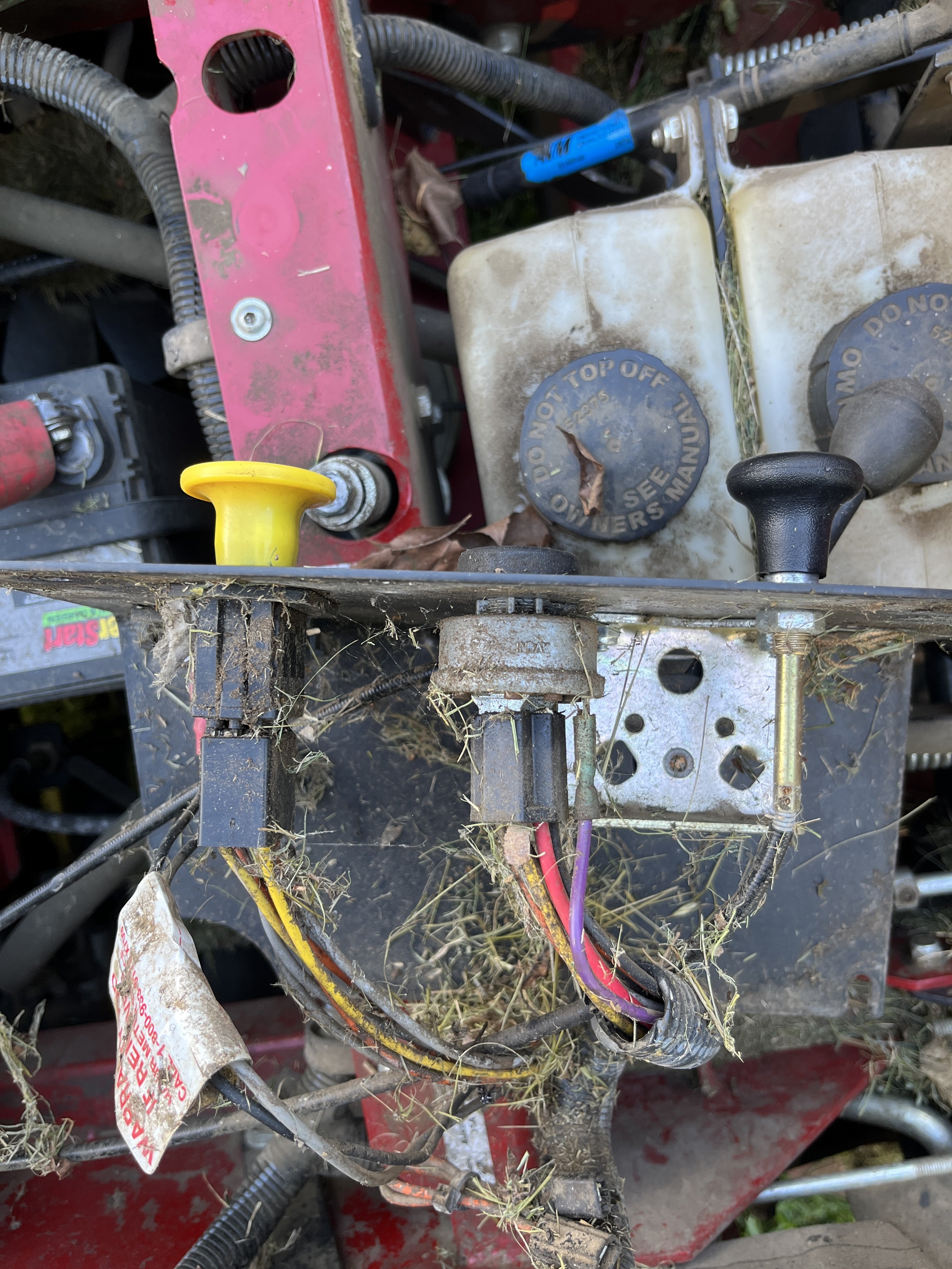

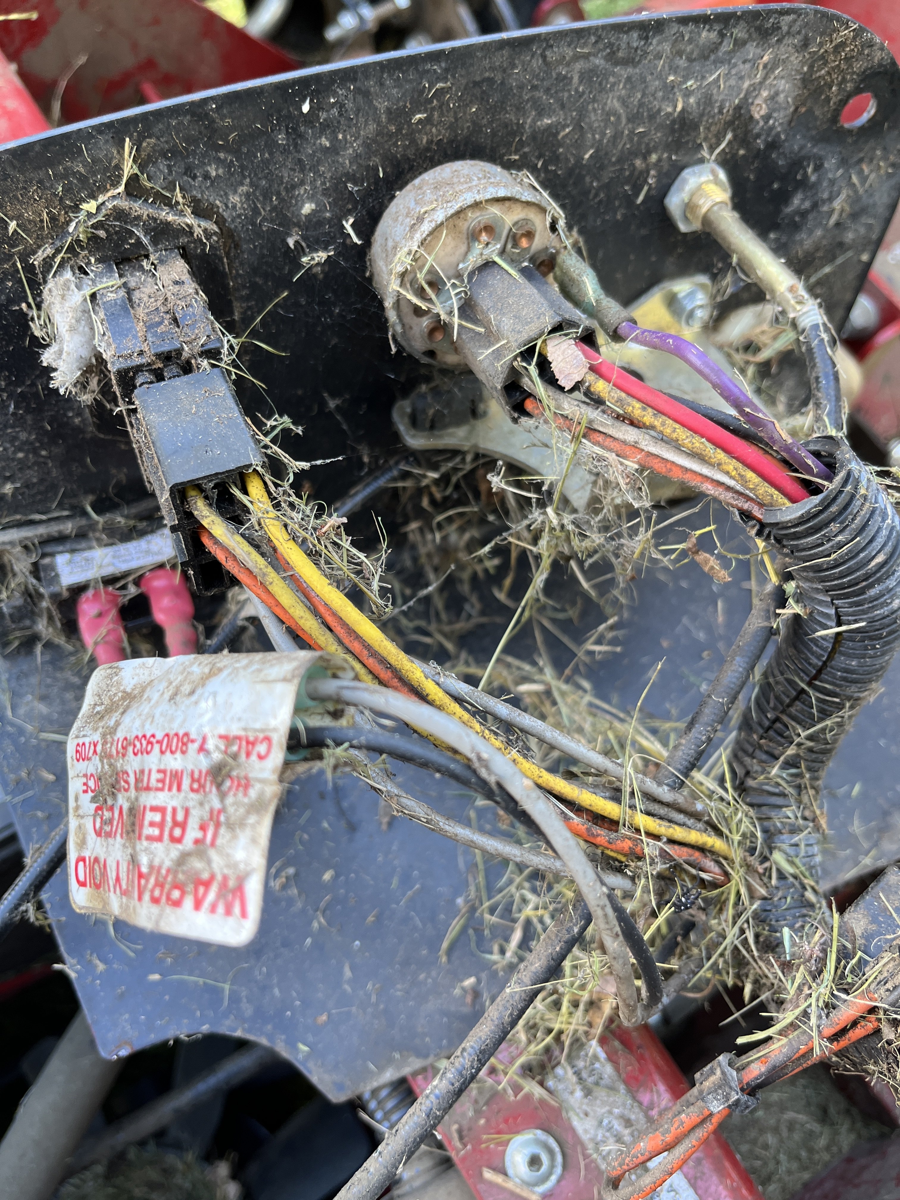

Update
My issue is getting weirder. I went out to mow today, Ferris started right up no problems, loaded onto the trailer. The battery could have been a little weak since I haven't been using it a whole lot but it started up without getting jumped. Mowed about two full acres and the PTO switch started acting up again. Got off the mower to move something, get back on and the blades will not engage. I investigated. I messed around with the RPMS and when they were low and the PTO was engaged there was a pretty loud humming sound and I could clearly see the belt was trying to move. Tried many times, could not get the blades to engage at all. Loaded it back onto the trailer and turned it off fearing the worst and fear justified as Ferris would not turn started. Jumped it, it died again while finishing up and yeah that is about it.
It is also worth mentioning that I have not been actively checking the voltage either. I don't keep a multimeter with me on the truck so it makes it difficult. I have a hunch that the battery is now failing due to the draw from what I am now guessing is the key switch.
I guess what I am doing now is trying to get it through the season. I would really like to install a push button starter and an on/off switch where the light toggle switch goes.

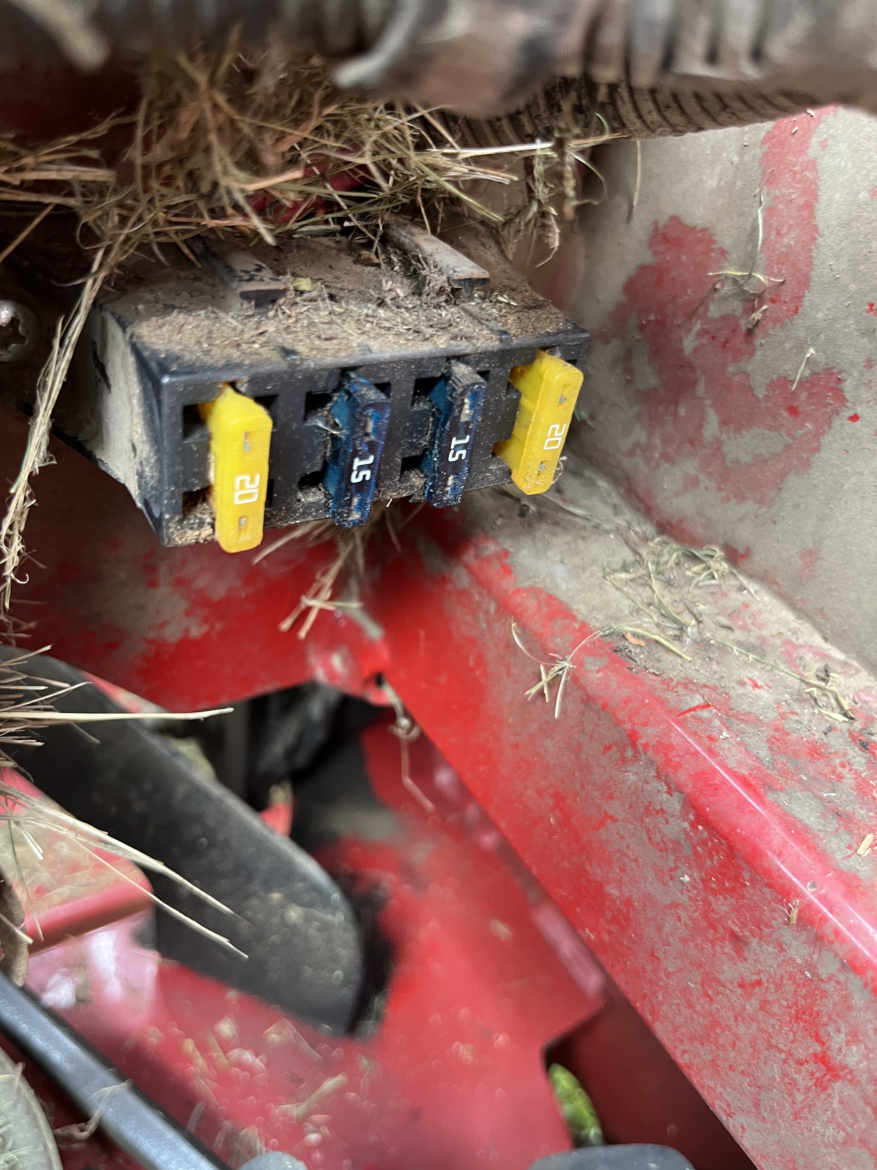

To me, it would seem there is an issue pulling power @ the starter solenoid. Normally at the same + terminal from the battery on the solenoid, there is a feed off the same lug which goes to a fuse block. Poor supply or a ground for that matter can keep your starter solenoid from actually firing as well as running your PTO clutch. It is assumed that a PTO clutch will fire @ 10-11 VDC, but will it hold.
Does your mower have an actual fuse block? I've been down that road before where the block itself is defective. Should you want to share more thoughts, post the full MTC from the Briggs and and the model / serial of the chassis.
