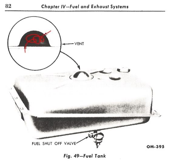

yep.. dry vs wet tells alot about rings and valves...
   / 8n only runs with full choke #32
fuel tank has the vent.. not the cap.. and is easilly plugged.

Ok Soundguy, you're confusing me. I've repainted a few 8N tanks on my remodels and I don't remember seeing a vent.
We're my tanks aftermarkets that didn't have vents?
   / 8n only runs with full choke #33
If you've repainted an 8n tank, then you know the tank is more or less an assy with the hood.
if seperated from the hood there is a dome on top with a pinhole in it.
that is actually a baffled dome as there is more metal under it, with a coresponding hole.
dirt daubers or over zealous painters.. can close the hole. OR.. those tank sealers you coat the insides with to control rust.. almost ALWAYS close the vent.
soundguy
Uh oh. Now I remember. I bet I've painted over the hole a few times.
Good diagram.
Thank you.
   / 8n only runs with full choke #35
diagram comes right out of the ford manual.
soundguy
I looked in my I&T service manual from 1953 expecting to find it but didn't. I must have an incomplete set.
   / 8n only runs with full choke #37
i know it was in the original manual...
