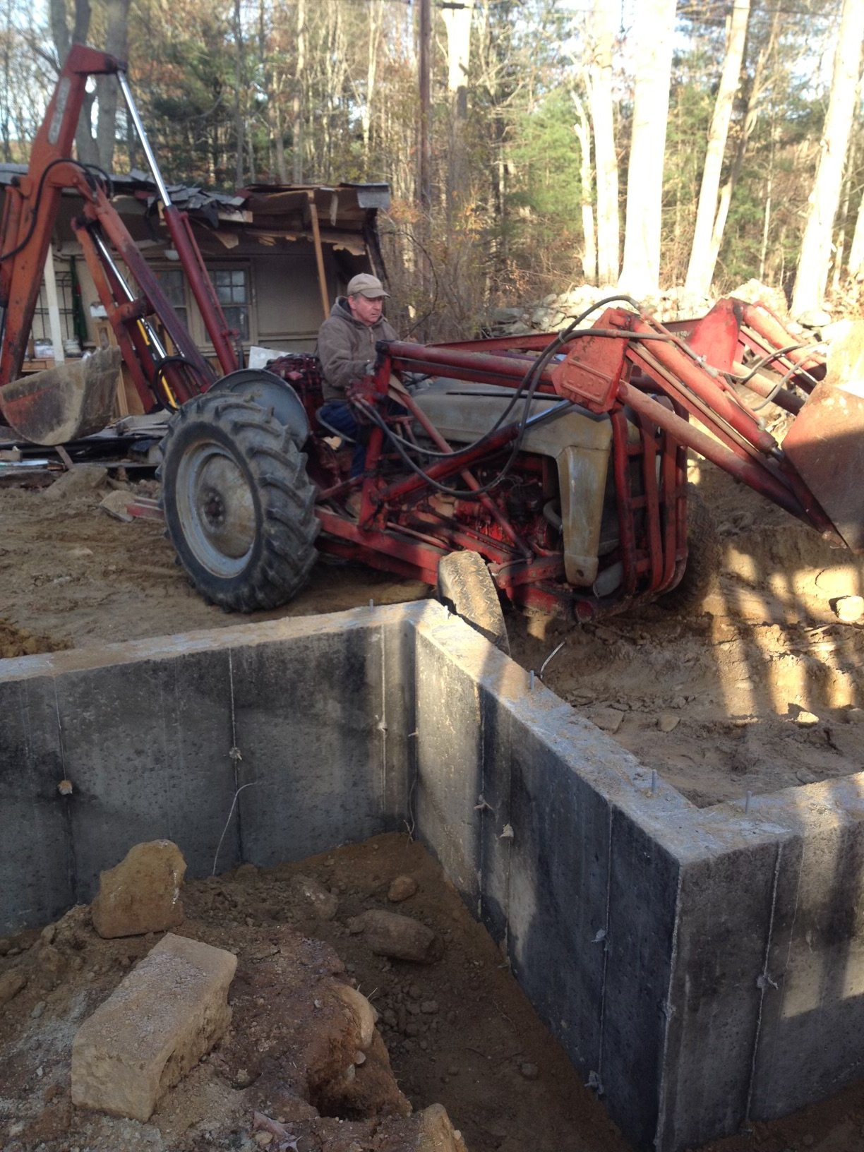

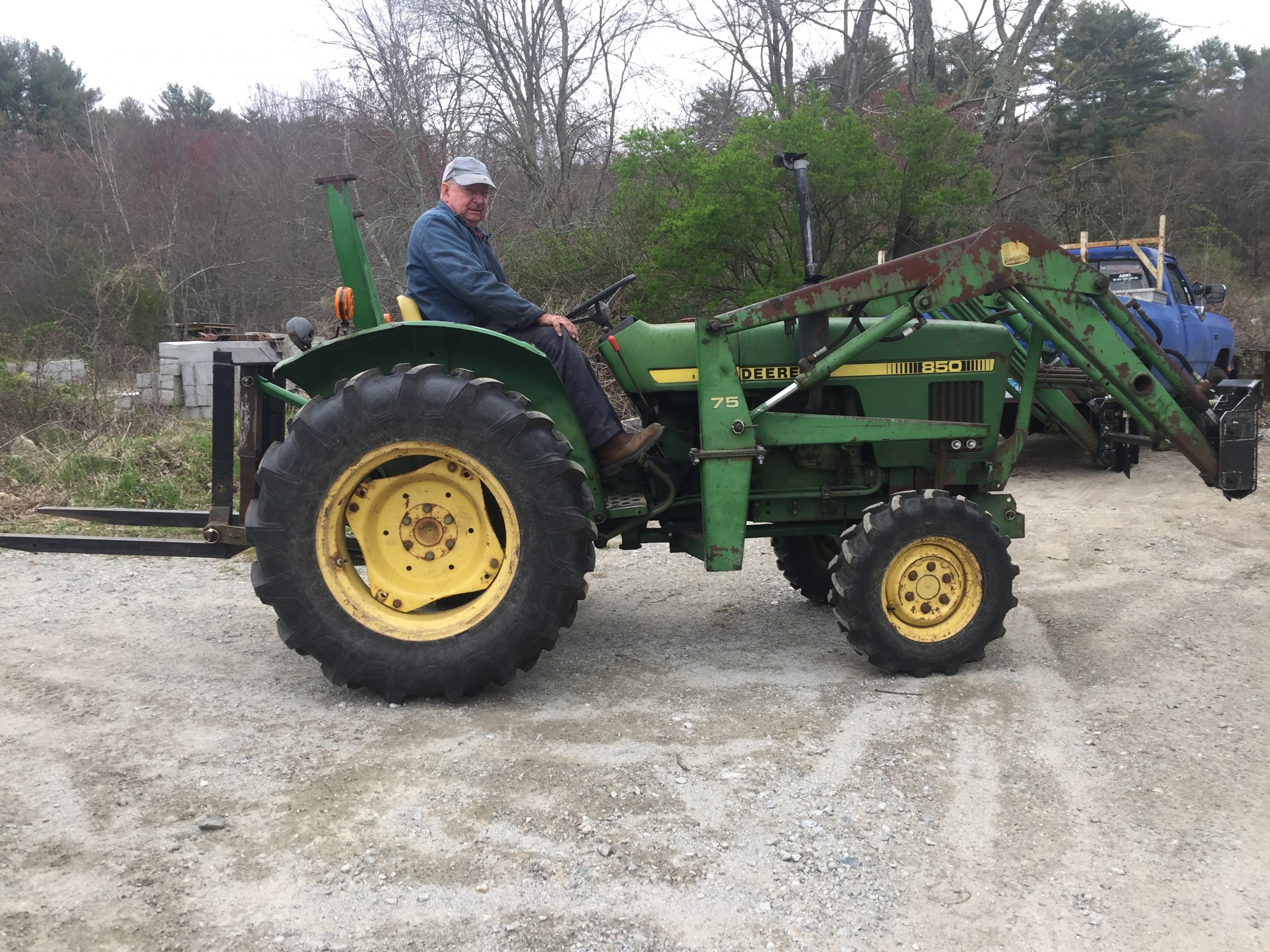

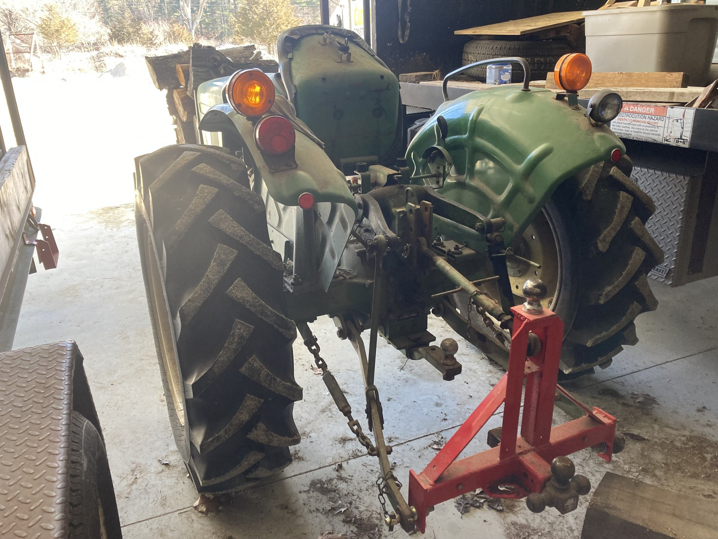

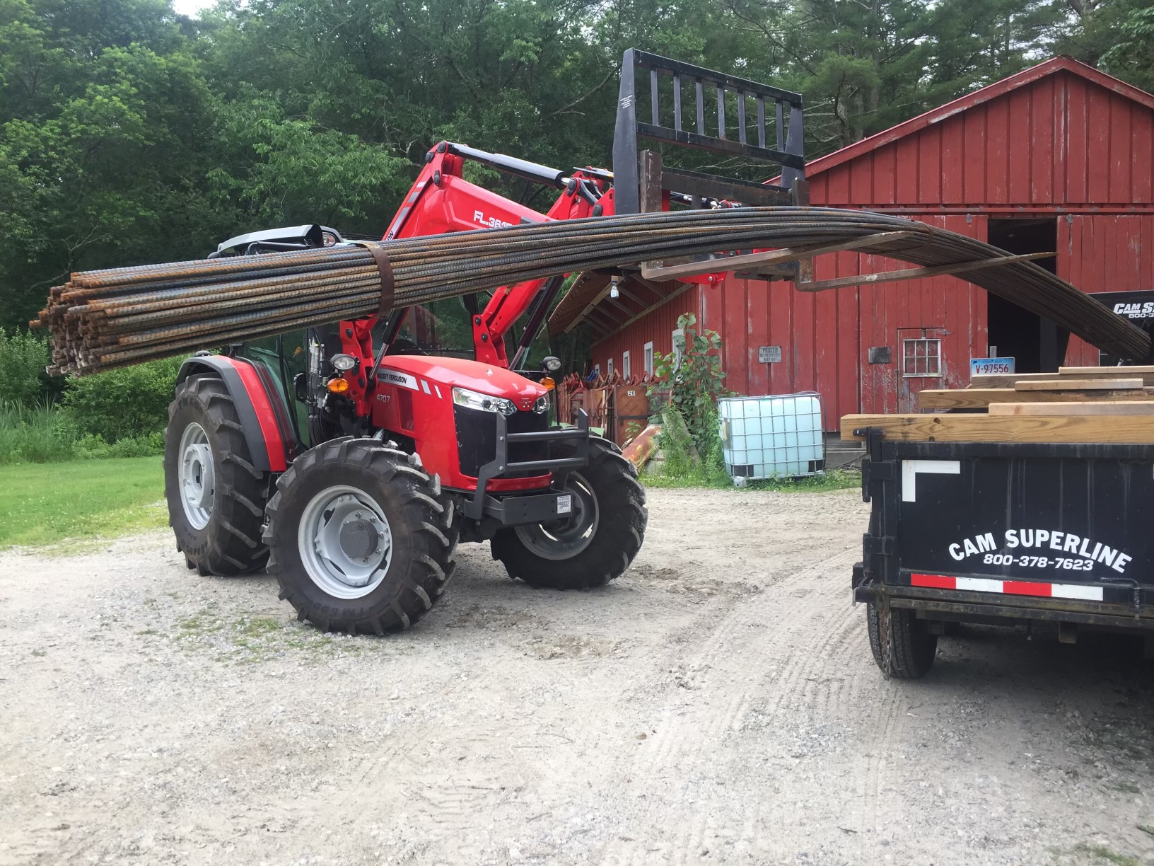

I've learned a lot in the last few years. Here are a few pics that I currently have:

like the vintage 850, a hoss, OP: update progress

rock solid, tires & sheet metal looking good. had a TO 35 for 28 yrs, but yours is a notch up the vintage ladder

Everything is kept under cover and we generally are very respectful of our equipment. That 850 has thousands of hours on it and is 43 years old.
