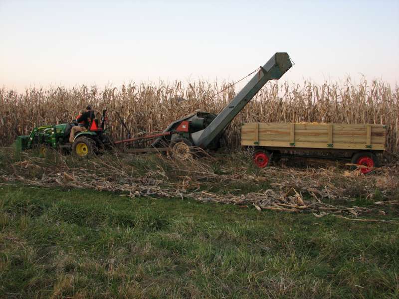

I have been nothing but impressed with my 2320. It has done everything I have asked of it with no problems. I have experience running a 4' bush hog, 4' tiller, 1 row planter, 1 row cultivator, 10' sprayer, middle buster, corn picker, etc. Here is a picture of my 2320 pulling a New Idea 323 corn picker and my wagon with about 1200lb of corn in it. No problem up to that amount, but this weight is about all it can handle before it runs out of traction. Don't try to get off flat ground or all 4 tires will just spin. Need a heavier tractor to pull more.
That's a pretty cool picture. Post a few more if ya got some.
