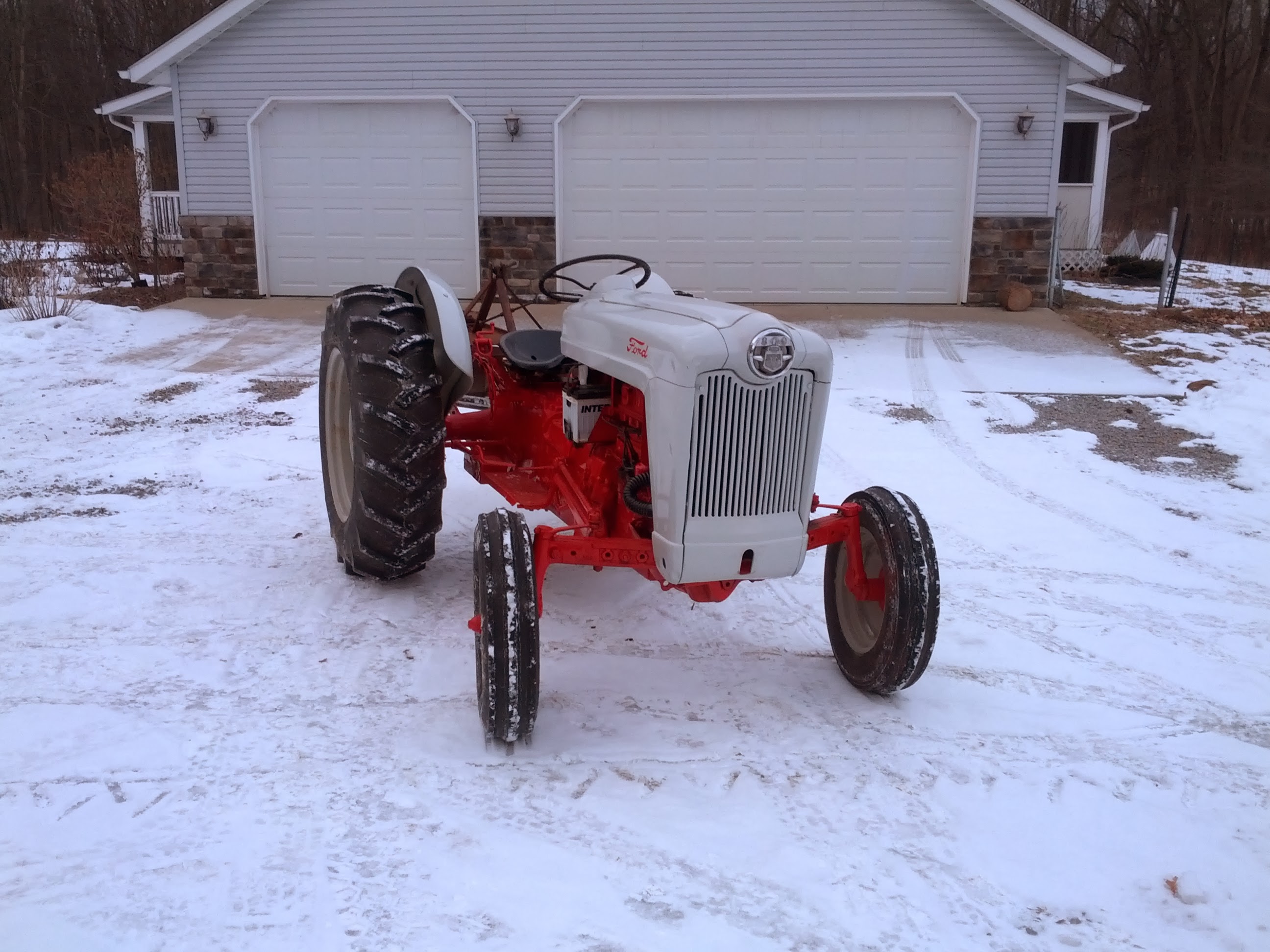

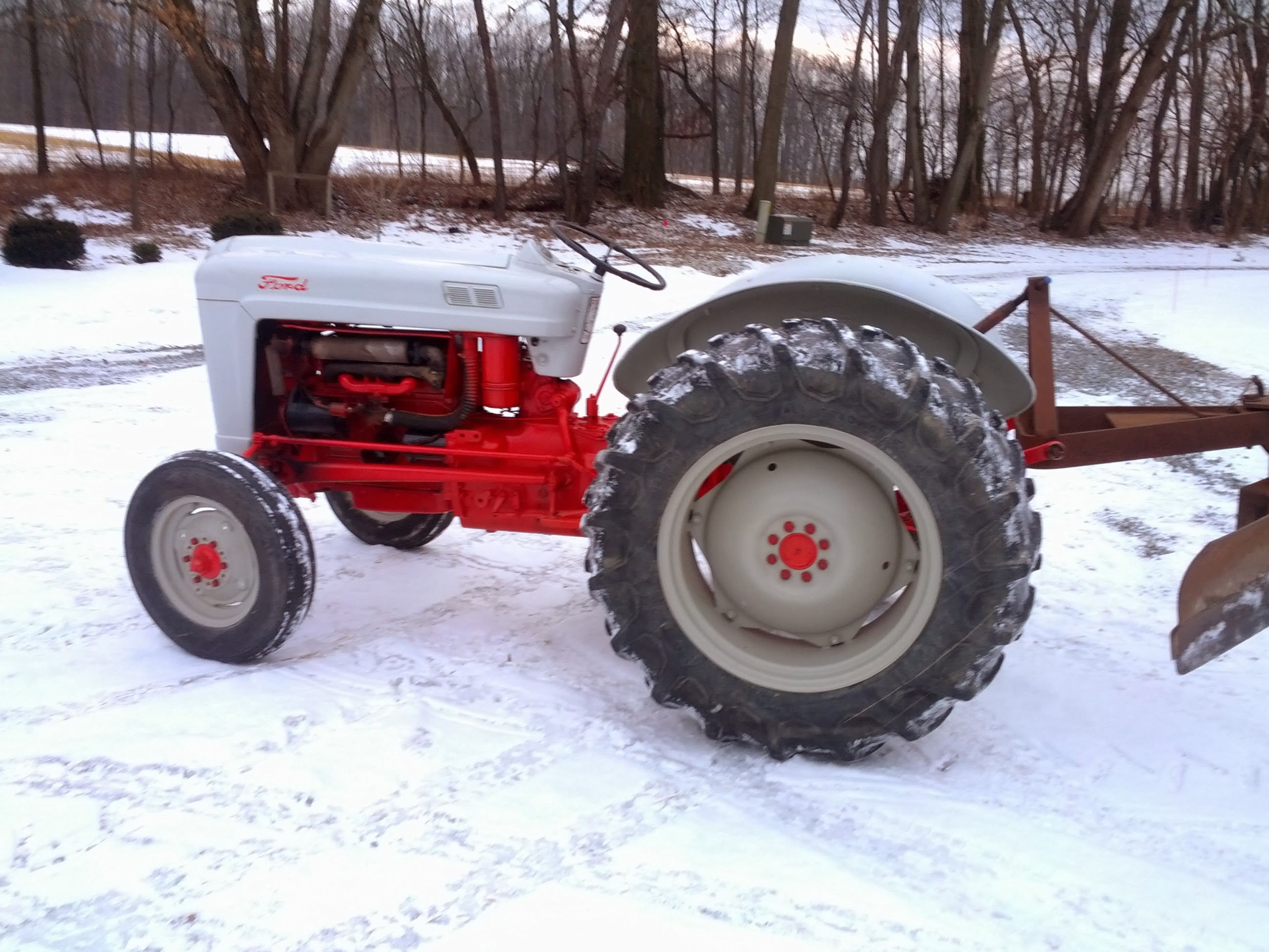

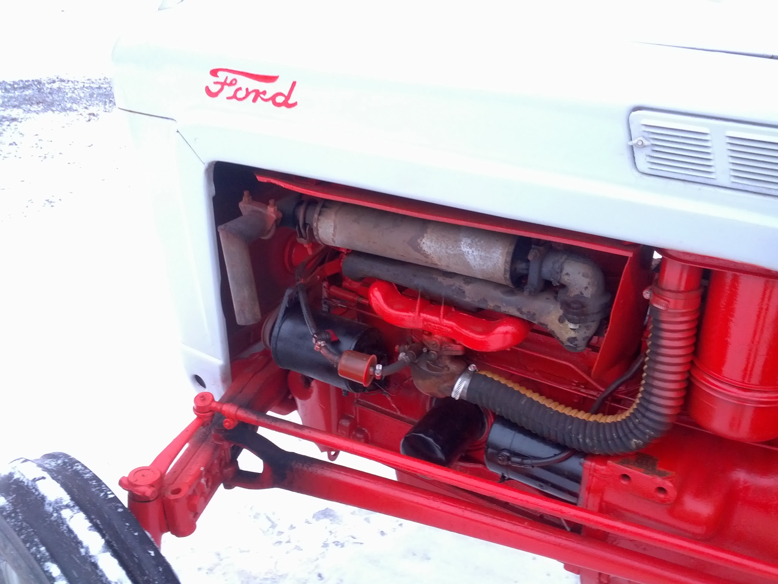

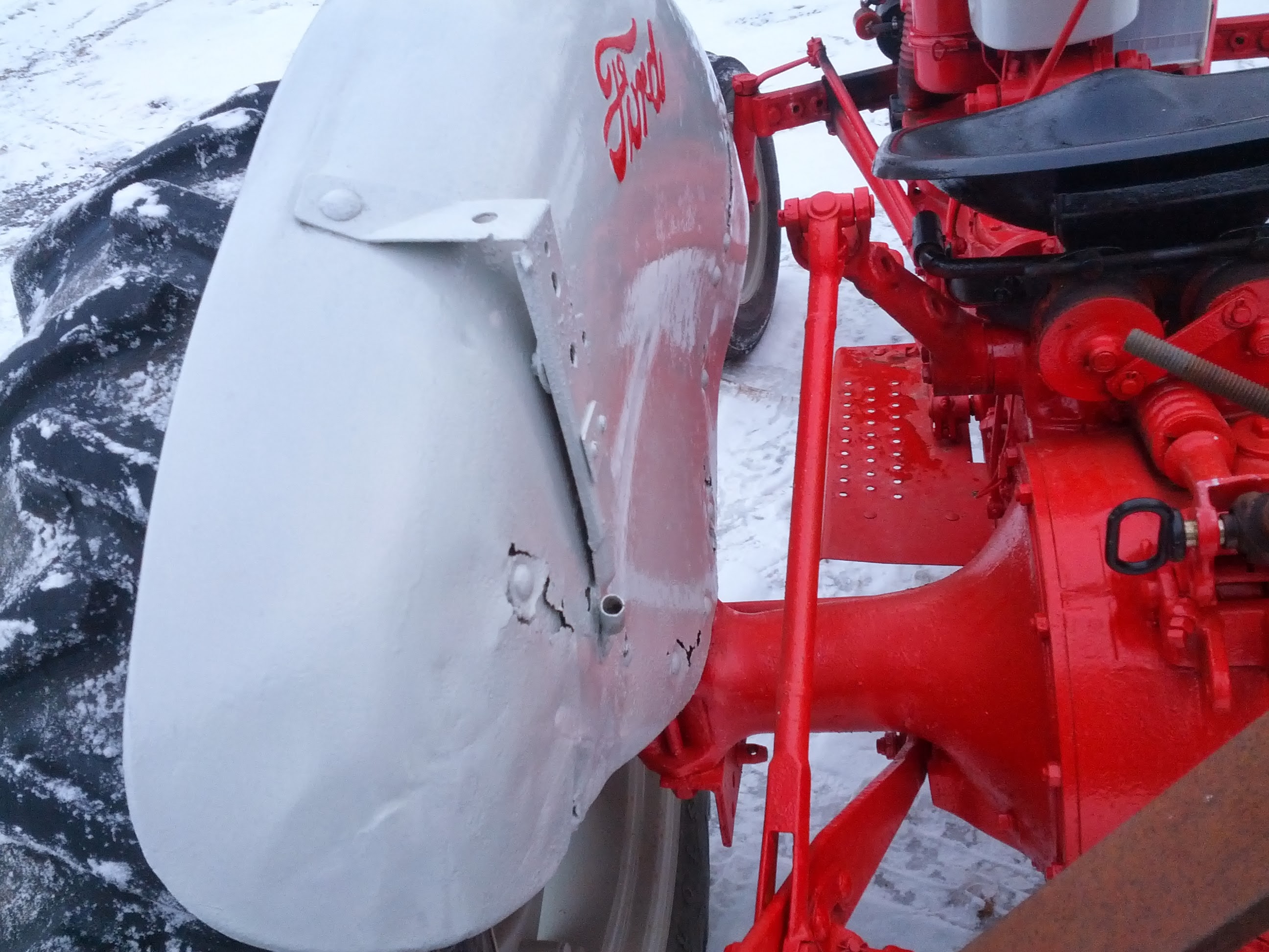

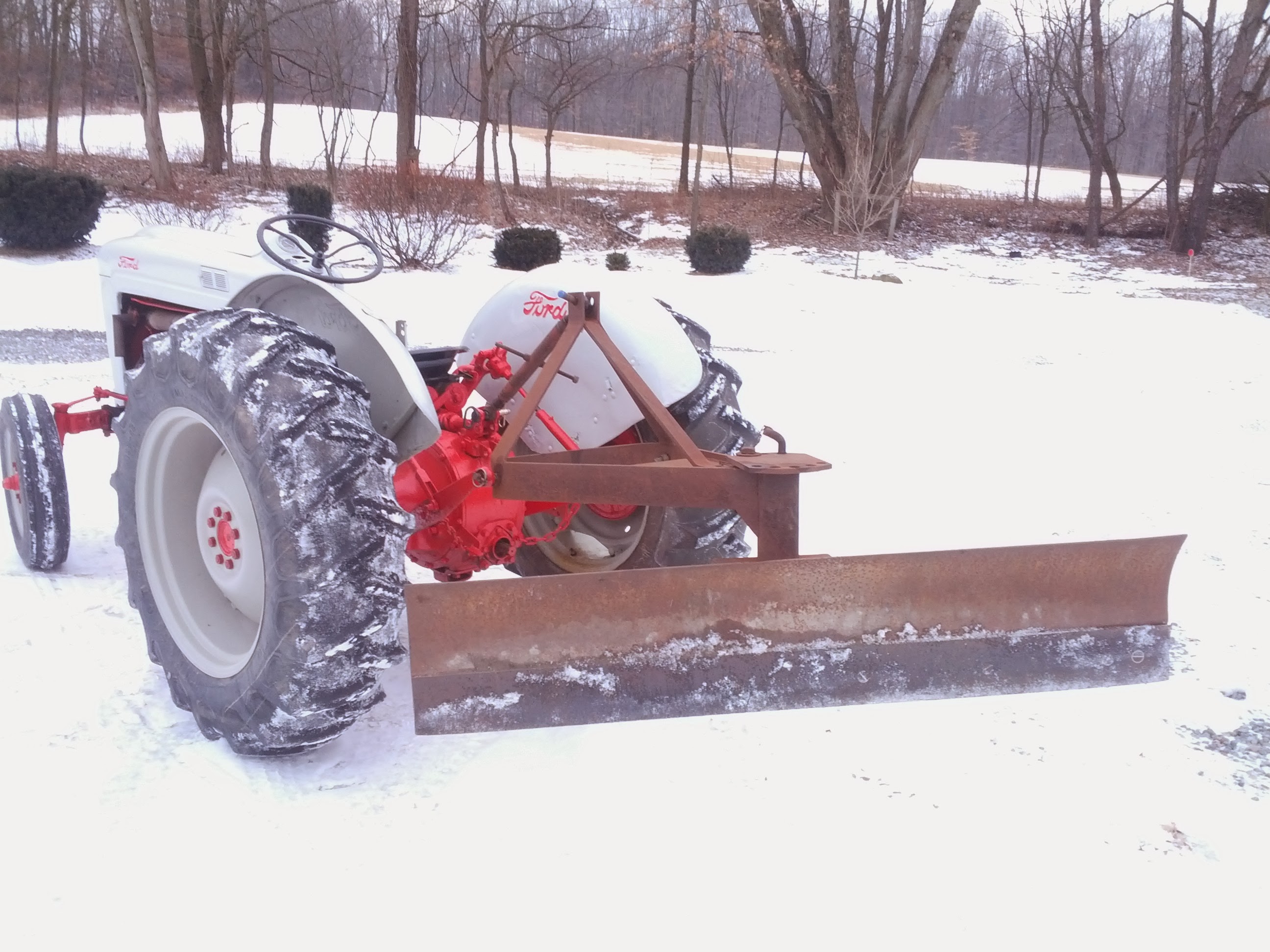

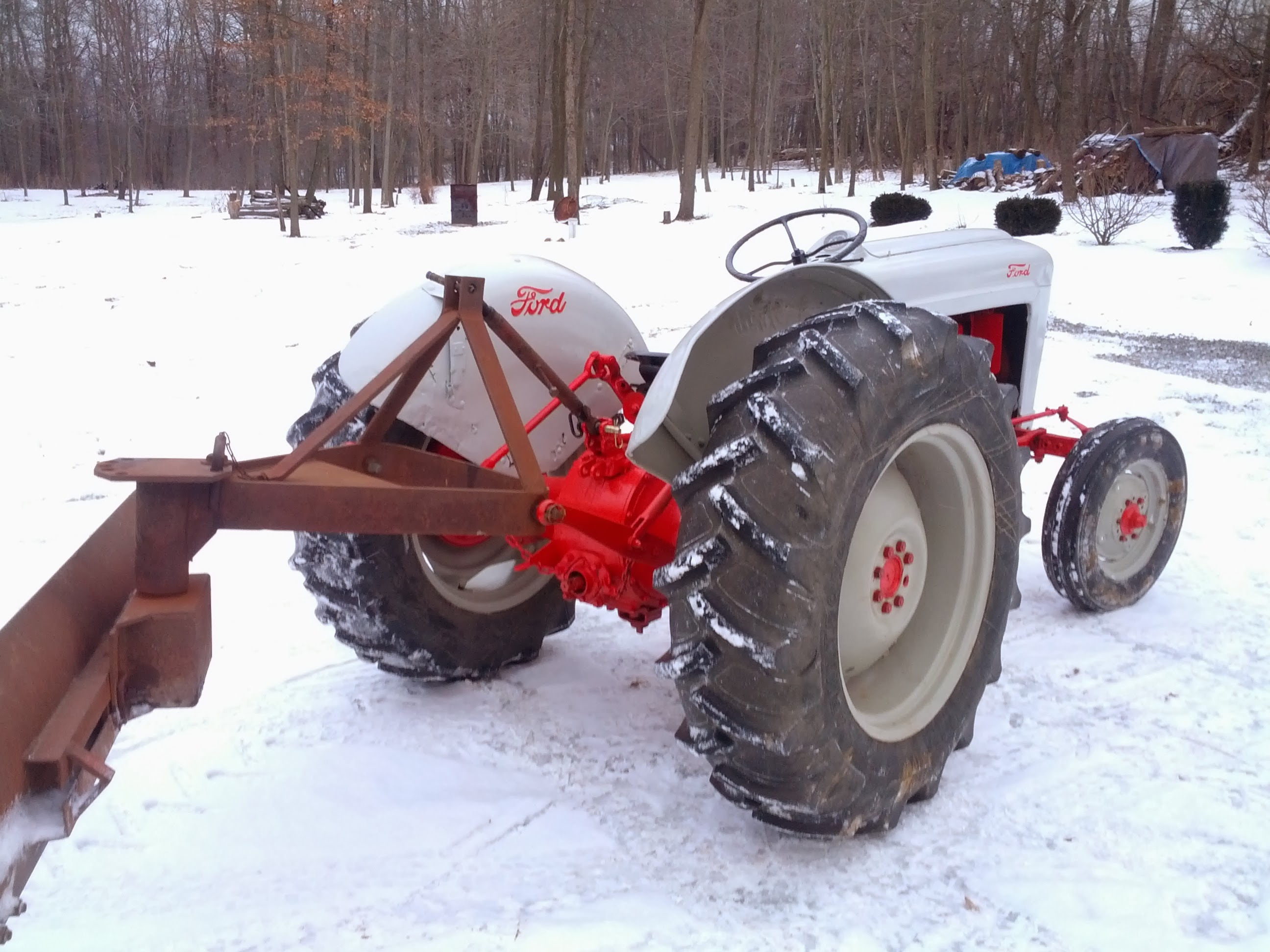

pictures of the 860:

Nice....she's got a lot of life left in her!

You can see its it a little rough (rust on fenders, etc), but was painted recently. First experiences are positive -- starts really well -- even on cold days, no throttle, give it a little choke and it starts and idles nicely. When I rev the throttle, it blows some black smoke -- not sure if that is normal -- seems like it might be running a little rich or something. When pulling under load, it does not smoke and seems to have good power. Really need to get a better exhaust solution as with the current configuration I'm breathing it during operation. Hydraulics work well once I figured out the Hy-Trol adjustment. Oil pressure gauge works, but the rest do not. Also need to wire in some lights so I can plow snow after dark.
