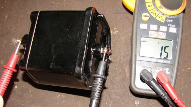

Testing the coil gets a little more imprecise - About all we can do is take a resistance reading between the top and bottom coil terminals with a quality, digital Ohm meter.
You can tell if it's bad by checking resistance, but you can't tell if it's good. I don't recall if yours is 6 or 12 volts but here's what you're looking for:
  1. 12 volt coils should read 2.5 ohms or more
  2. 6 volt coils should read 1.4 ohms or less
  3. If it's open (VOM reads infinity) the coil is bad.
