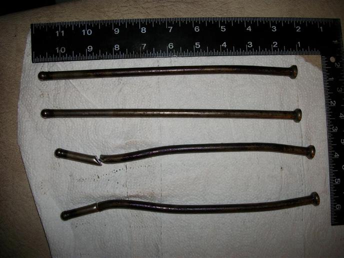

a54127.jpga54391.jpgI drove a 4 cyl ford 4000 off a trailer from a show, parked it in the barn, went to use it again, clink clink, clink, clink, clink, clink room,roomroom. that's right.. those were all pushrods bending from stuck valves!
I parked my 850 after unloading some hay, parked it by the barn to air a front tire. started it later.. clink! pop,pop,pop, chug running on 3 cyls. again. another stuck valve, and pushrod.
so yeah. stuck valves DO just happen... btdt, got the greasy rags!
My pushrods were bent soo bad I had to cut them with bolt cutters to get them out of the head and block. .. luckilly valves survived.
N is a hair different with that flatty vs an OHV engine.. but N valves surely can stick. btdt too.
