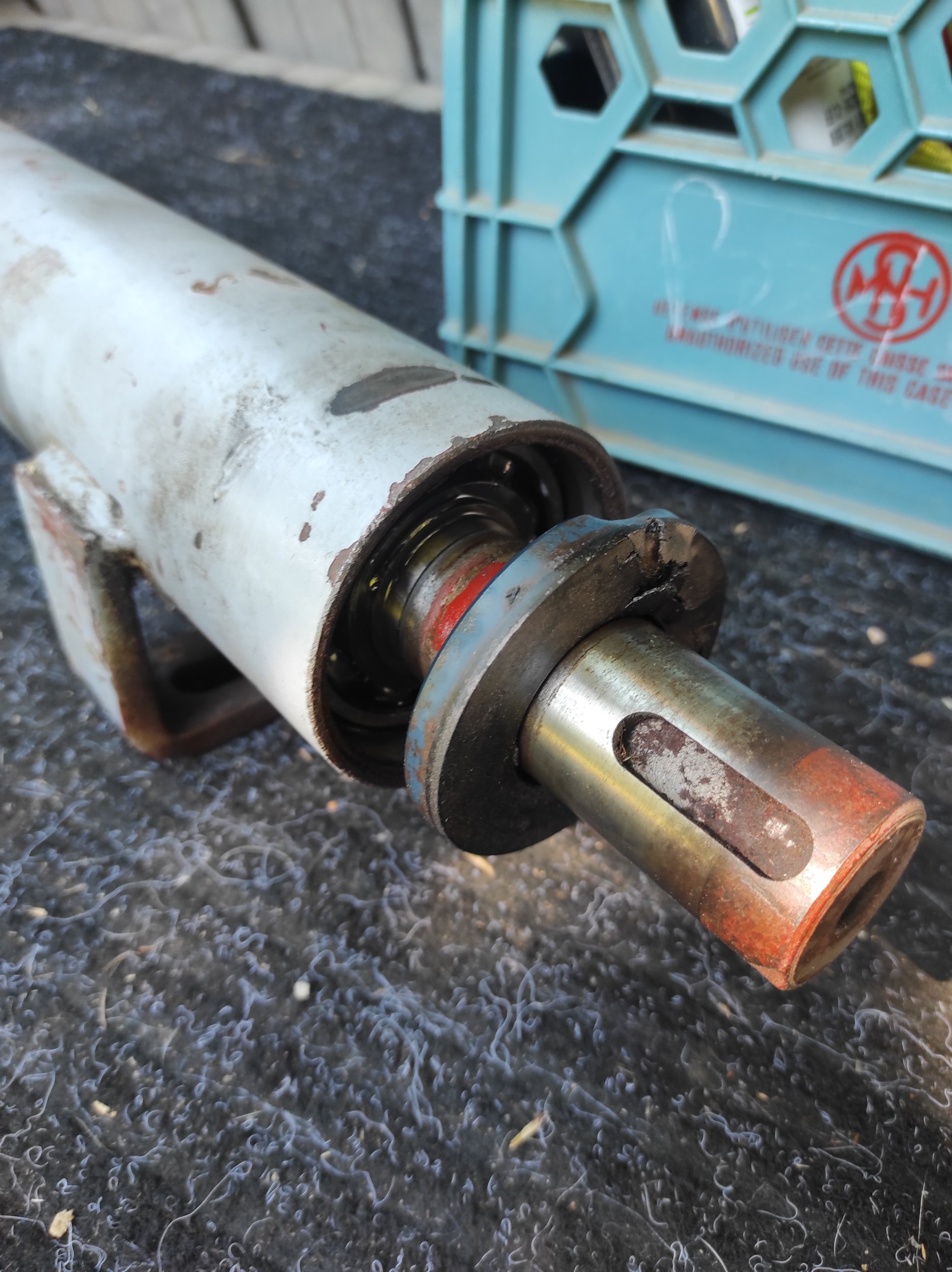

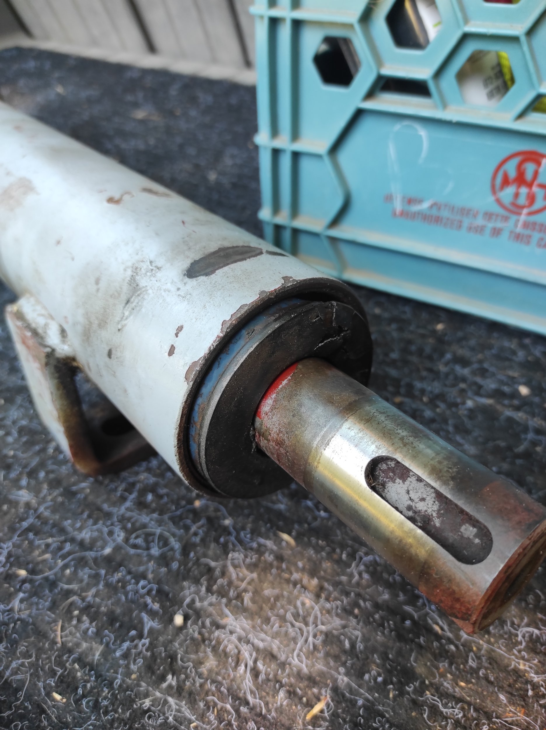

Per the OP's diagram post #6 several snap rings; #21, #22 and #26
Per yours post#10 also several; #11, #14, and #19
It looks like quite the convoluted shaft and housing.
Glad I'm not the one disassembling it, also several shims to keep in order.
   / 918h flail mower gear shaft seal replacement
#12
Brought the output shaft and casing to our local tractor dealership, and it was far simpler to remove than I had imagined. Basically the oil seal is the last item on the shaft so a tech just pryed it a flathead screwdriver hammered in a bit. The new seal is on order. Thanks for sticking with me through this project. I hope the photos help the next person out.
