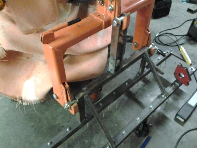

Here is the dethatcher with the top link connection gone

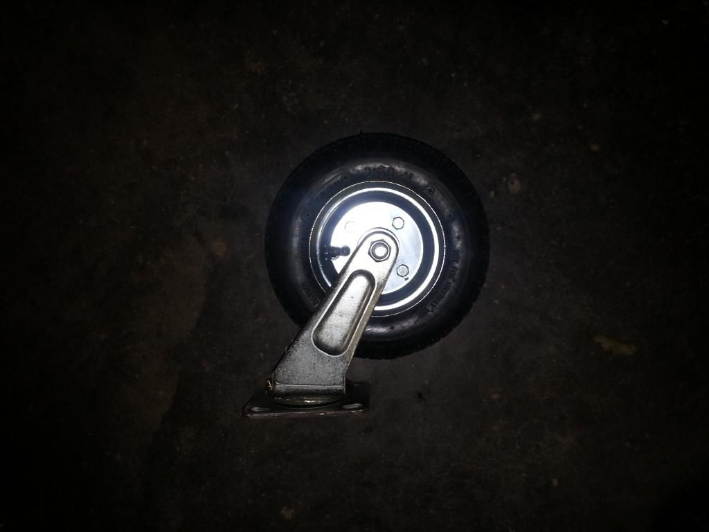

Caster and plates for caster to bolt to
Caster for gauge wheels
Getting ready to weld the new upright on, 3/8x2'' bar. I have a bottle jack under the lift arms to have the Qh sitting against the lift arm pins, There is a bottle jack leveling the dethatcher, and I have the QH sitting level.
Dethatcher level
Qh level
This the were the uprights for the top link get welded, they are also level, they must have been welded on there right.
Tractor covered with welding blankets.
A shot of the new toplink uprights, it looks better than the angle from before
So you guys will know I don't throw my stuff together here is a picture of a square at the upright for the left lift arm
So right now I need to go over it and make sure everything is welded, add the gauge wheels and I have decided to add park stands. It is stable with out the park stands but I don't like the weight sitting on the tines. I am probably going to hang it up inside once I am done.
