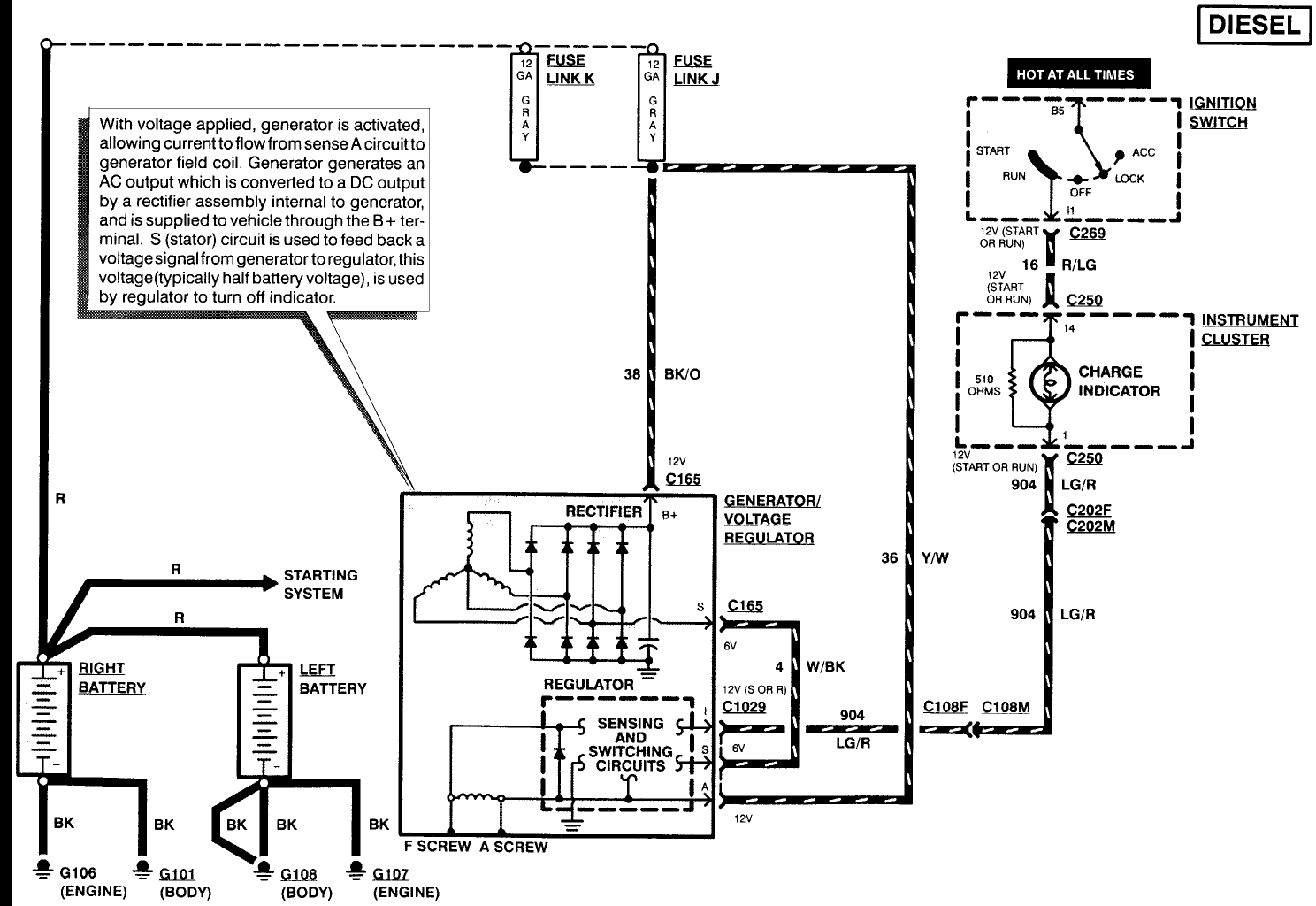

That would be a 3g alt with built in reg, grey. Run a heavy guage wire from Bat pos to alt term to by-pass fusible link (test only) this reads Bat voltage to tell the VR when to shut off. if still no charge check small b/w wire in connector for break, known problem. you can run a small temp wire to the pin the b/w connects to, to test, this excites the alt. good luck

You may want to check the bat wire from the alternator to the starter solenoid mounted on the right fender - worked on a 1989 and the wire had gone open internally looked fine-but measured open circuit- so i pulled on the end that connects to the solenoid and it had burned open inside the wires plastic covering...
Not sure how much changed in those 6 years as far as alternator wiring...

Thanks BigRol and sd455dan. I got in from work late last night and if it doesnt poor down the rain I'll check it out this morning .. any help is much appreciated.

Fusible links sometimes just look like a slight bulge in the wire covered by heat shrink.
Also check to see if the glow plug relay is stuck on.
