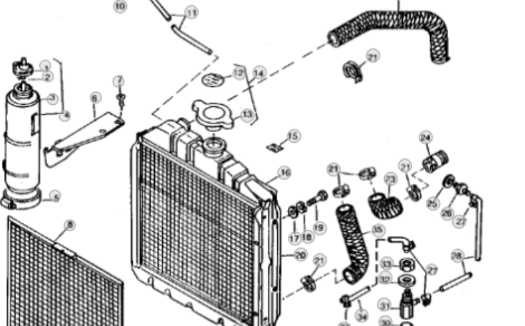

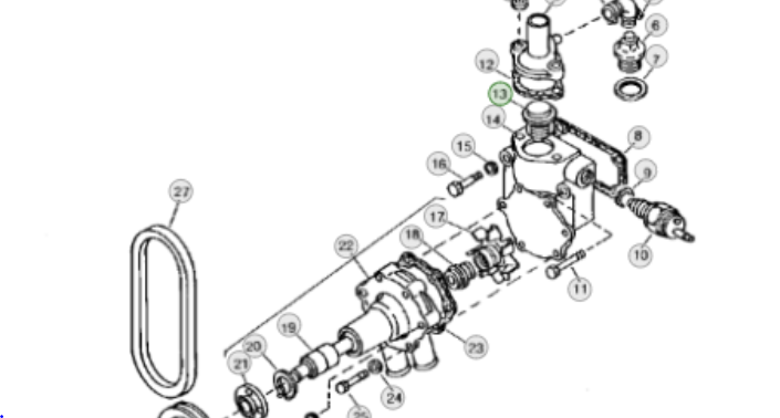

I have a 950 John Deere tractor and today after bush hogging for less than an hour in 90 degree weather it overheated. The tractor isn't hurt but I am of the mind the thermostat is either stuck or non existent. Where is the thermostat located? I don't know what year the tractor is but do know there is 800 hours on the tractor. Any help is greatly appreciated.

Follow the top radiator hose key 13 in drawing. Doses yours have the front screen key 9 in second drawing?

I’m guessing your radiator is plugged up. I sold a 950 that ran perfect. I had gone thru the tractor including the coolant system and radiator. The next day the buyer called and said the tractor got hit after a couple hours of mowing. I asked him how tall of stuff he was mowing and he said 4 or 5 feet. He plugged up the screen. Happens fast. The coolant system is adequate of working properly.
