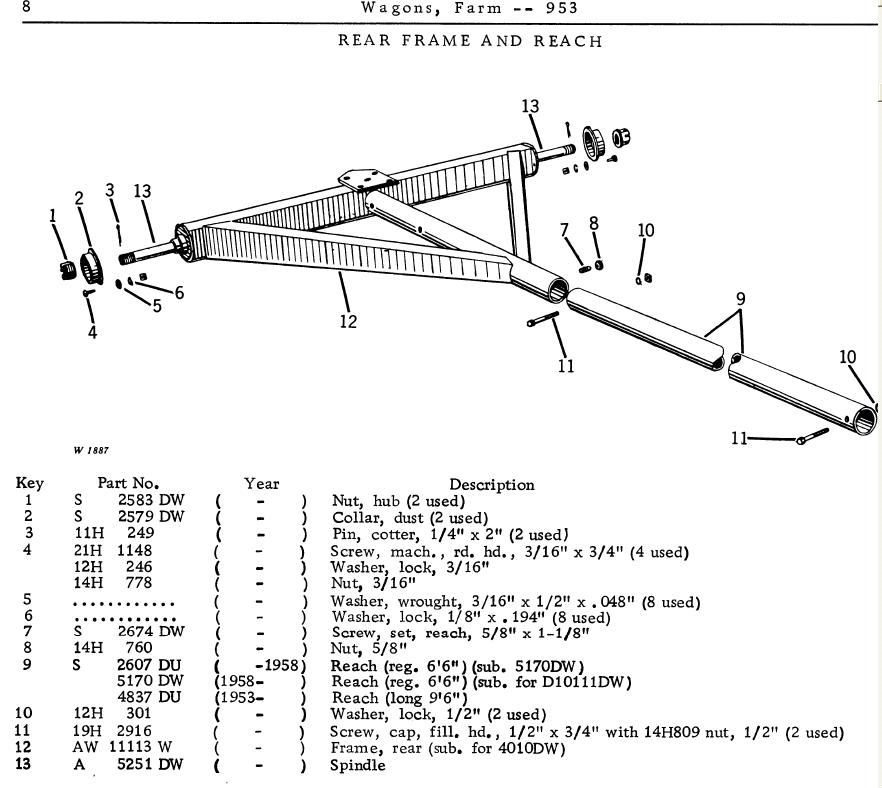

Mar 15, 2011 / 953 running gear spindle #1 H hollowcd Member Joined Oct 26, 2009 Messages 38 Can anyone shed some light on what it takes to replace a rear spindle on a jd 953 running gear? I have a slightly bent one causing my gear to track left. I am not sure if they are welded in or what? Thanks, Hollow
Mar 15, 2011 / 953 running gear spindle #2 B beenthere Super Star Member Joined Aug 16, 2001 Messages 18,665 Location Southern Wisconsin, USA Tractor JD_4x2_Gator, JD_4300, JD_425, JD_455 AWS, added JD_455, JD_110, JD_X485(sold) Looks like cut and weld. Here is a look from jdparts (maybe can heat and bend back ? ) Attachments 953_gear_spindle.JPG 95.3 KB · Views: 691
Mar 21, 2011 / 953 running gear spindle Thread Starter #3 OP H hollowcd Member Joined Oct 26, 2009 Messages 38 Thanks, anyone know if a spindle can be bent back if it is slightly bent?
Mar 21, 2011 / 953 running gear spindle #4 Tx Jim New Member Joined Jan 26, 2007 Messages 10,390 Location Coyote Flats,Tx Tractor JD 4255/Kubota M7040 HDC spindle is still available but not cheap. Part Number: A5251DW Part Price: 215.00 USD Description: Spindle
Mar 21, 2011 / 953 running gear spindle #5 Zebrafive Super Member Joined Aug 5, 2010 Messages 5,635 Location South West MI Tractor John Deere 2030, John Deere 6415 I'll bet a Collision/Auto Body Repair Shop with a frame straightener could fix it.
