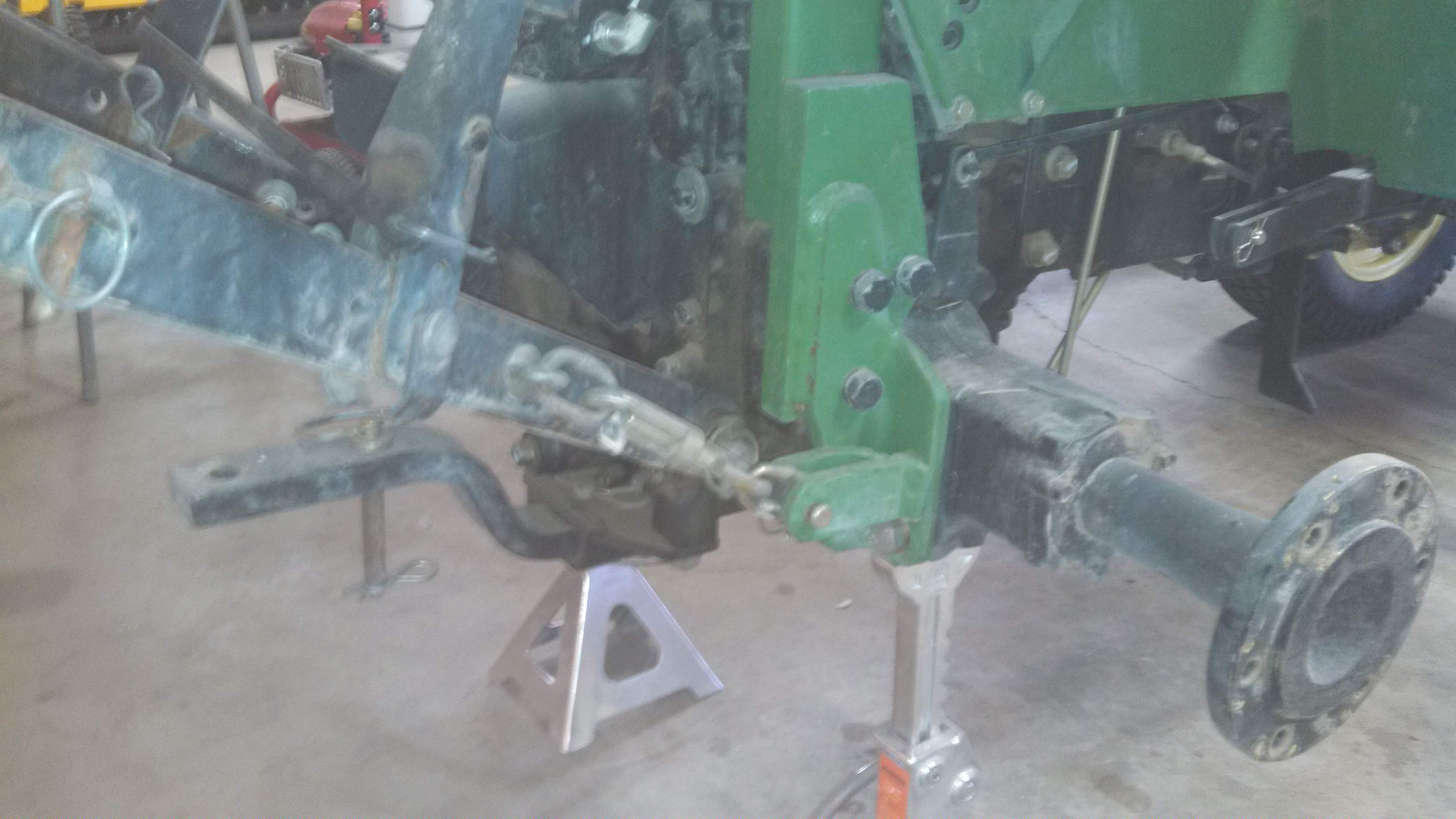

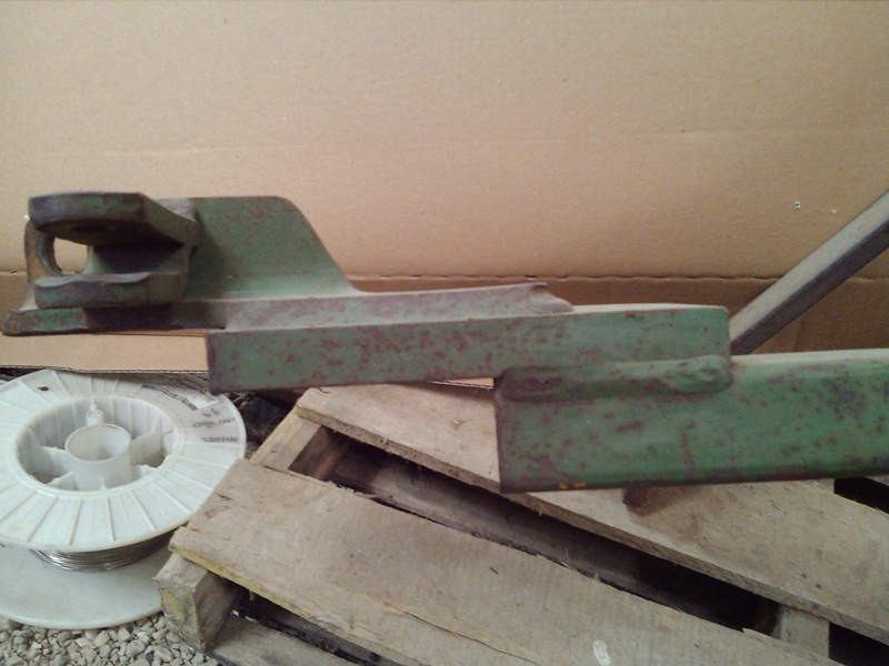

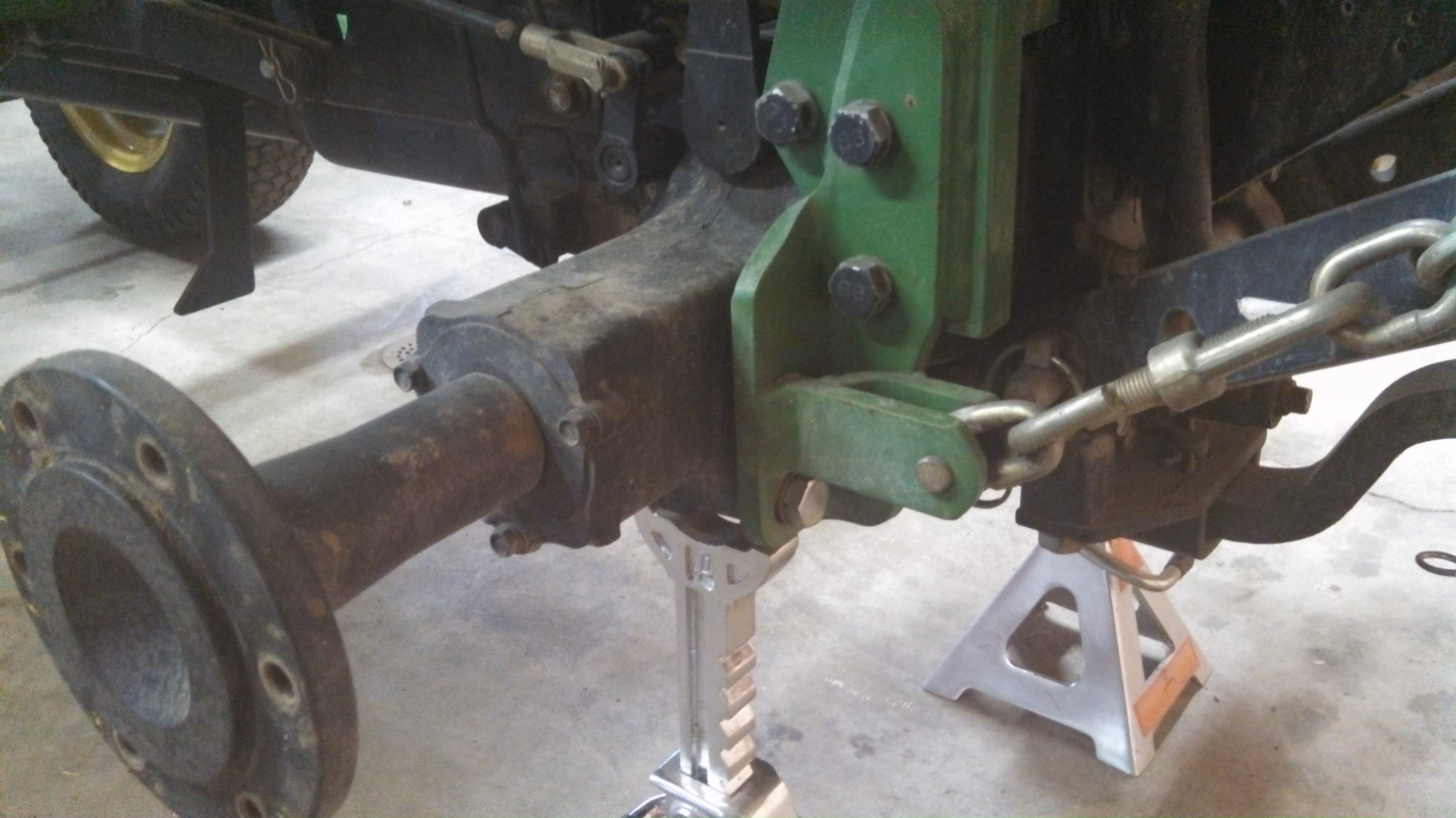

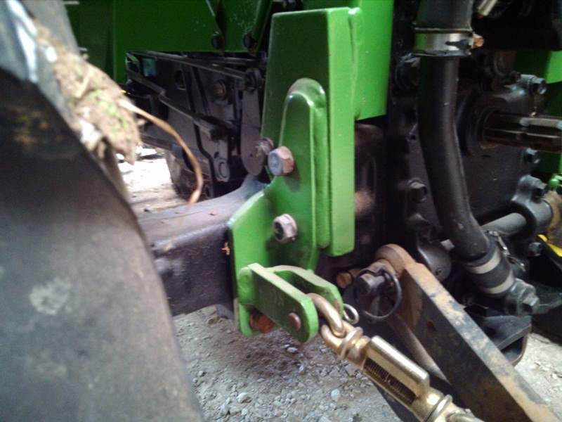

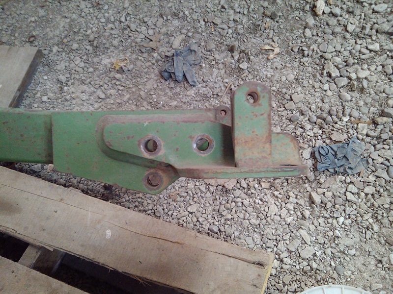

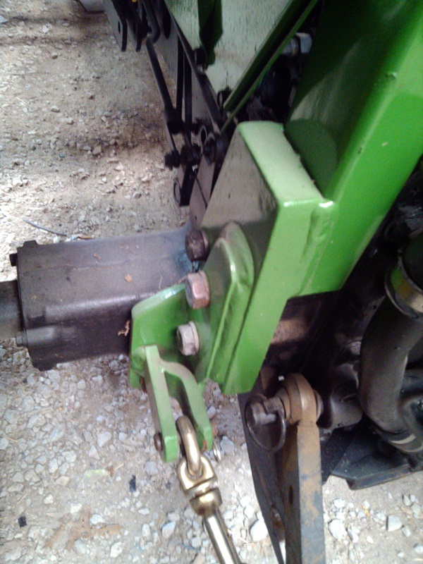

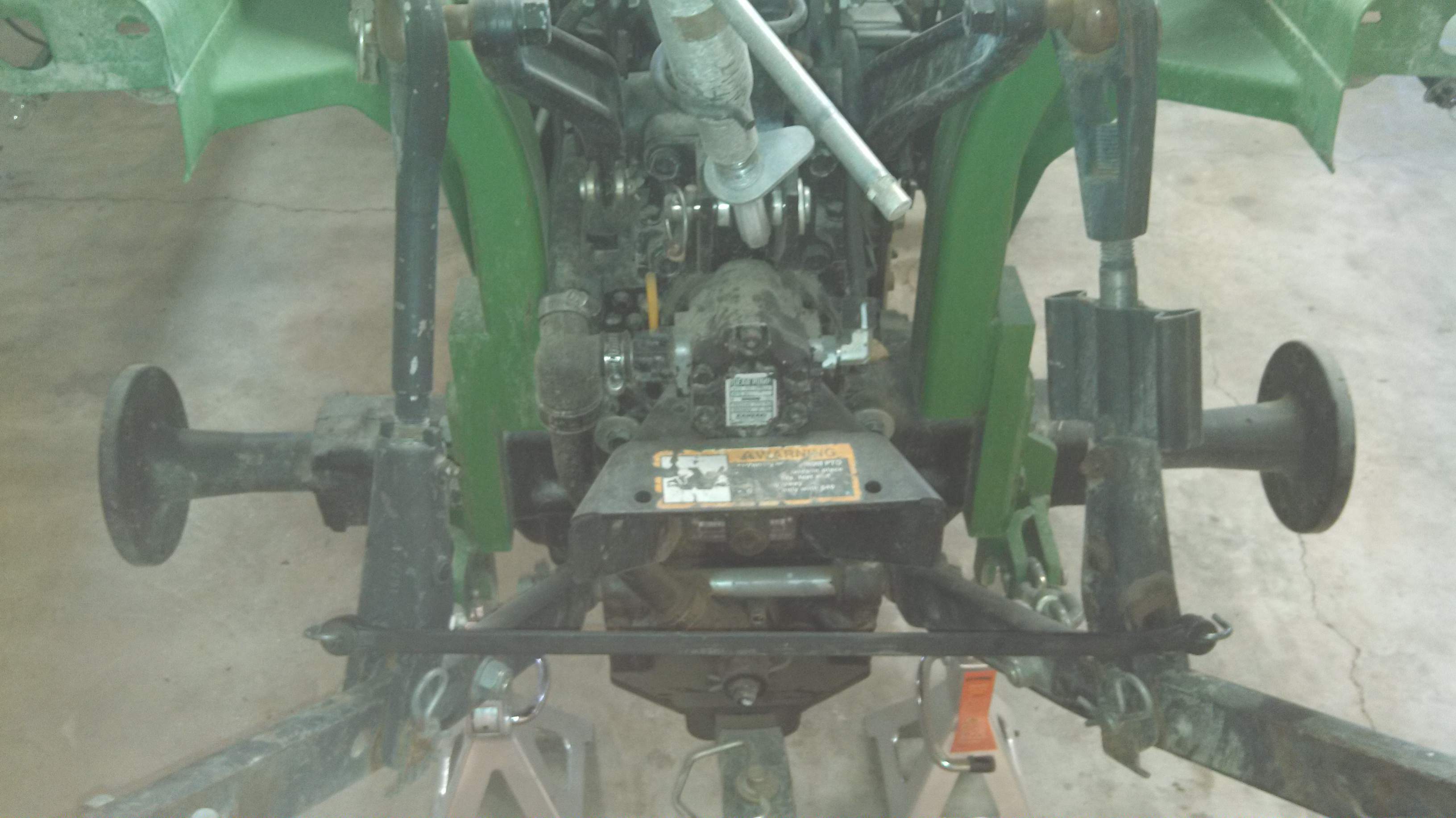

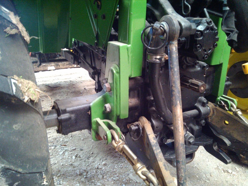

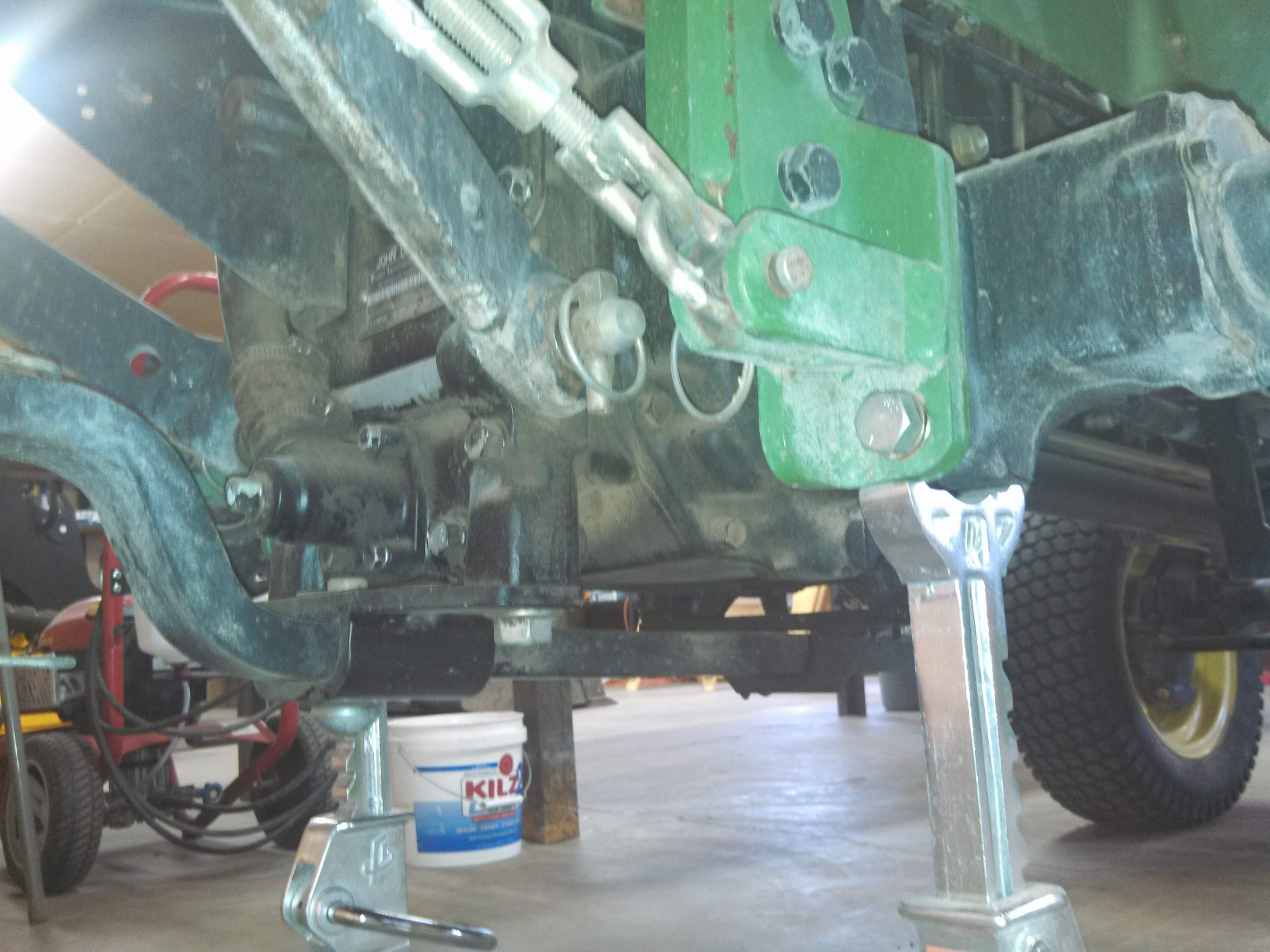

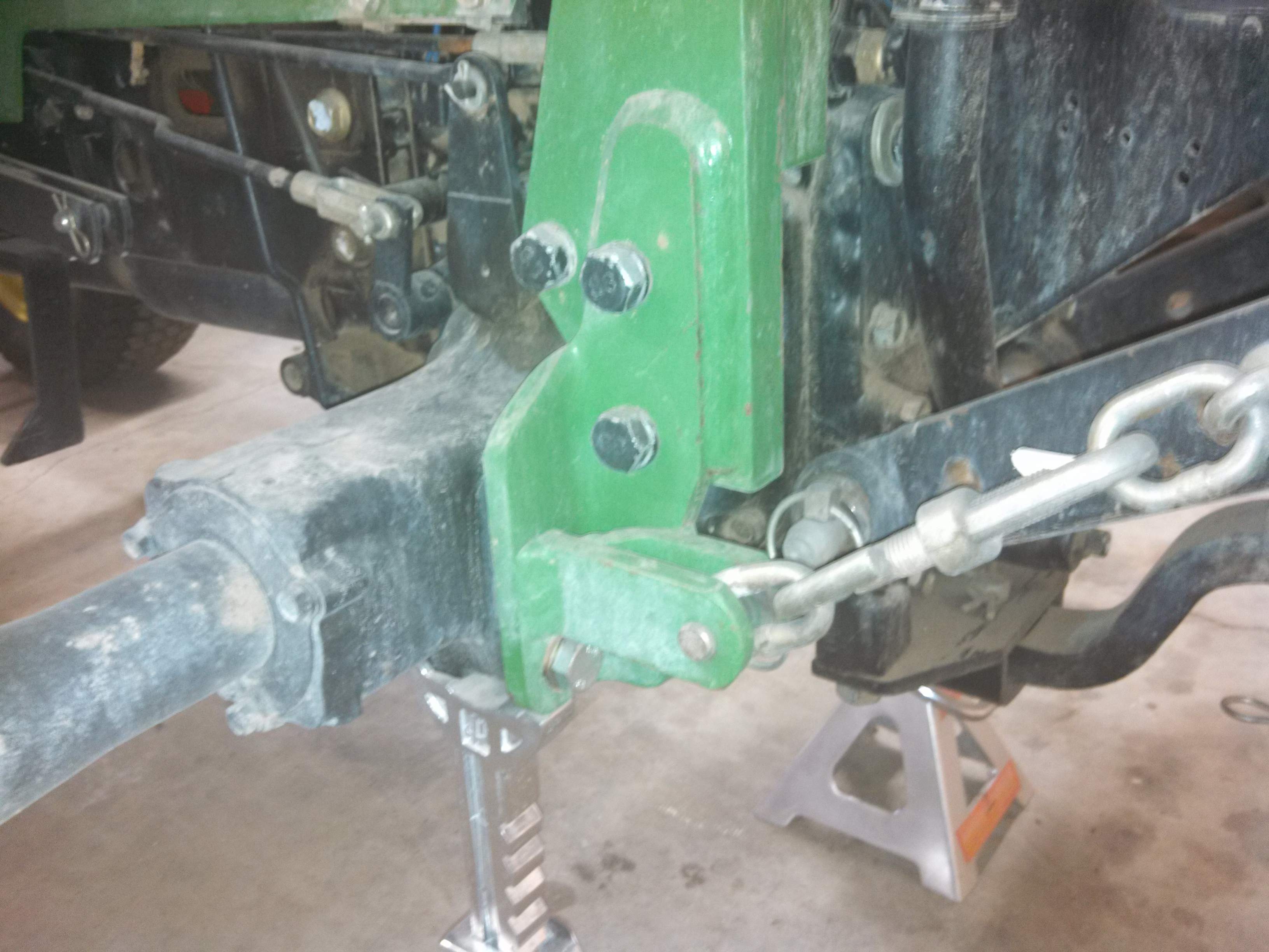

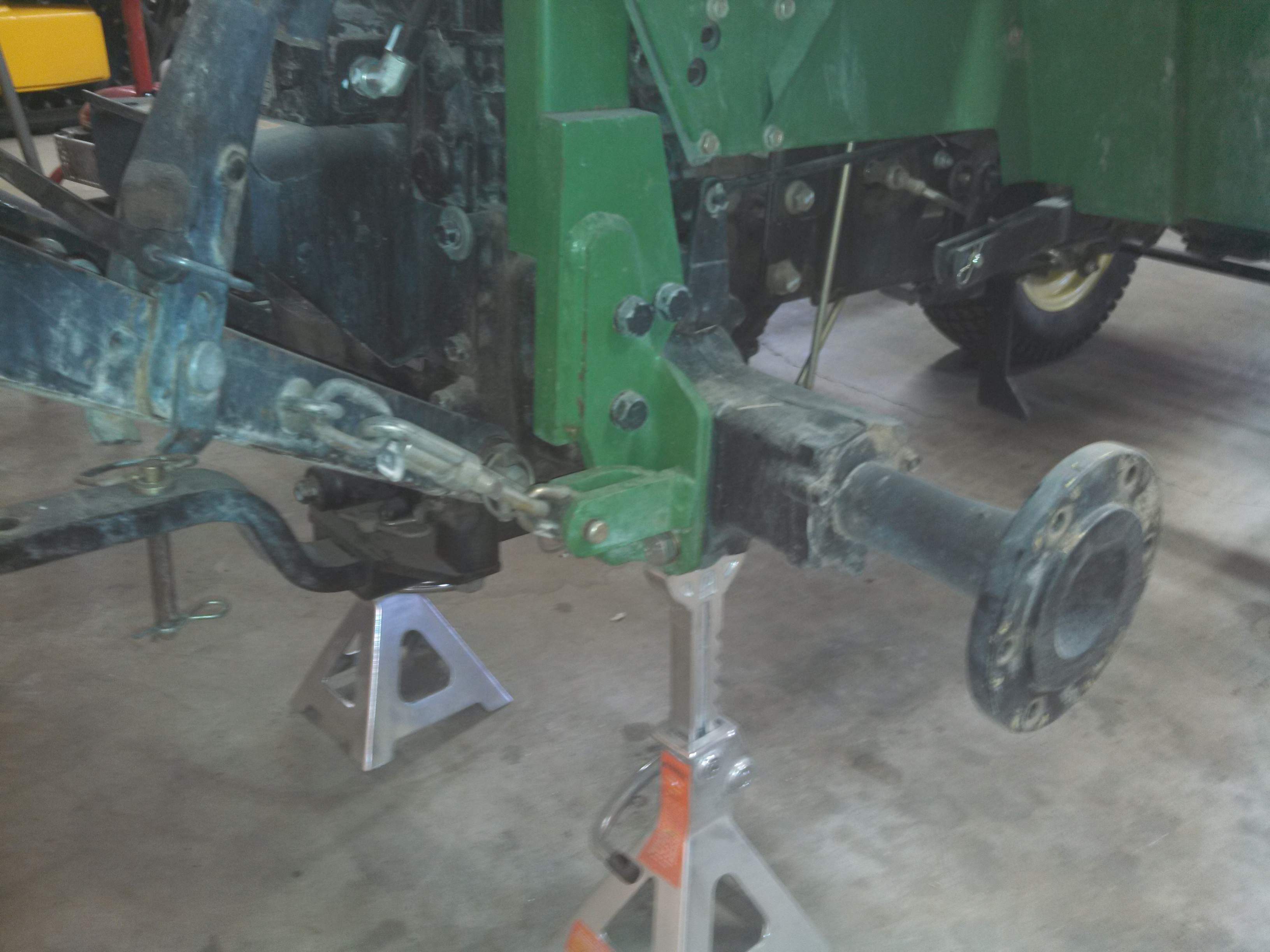

Could someone post a few close up pictures of the area where ROPS attaches to differential housing and sway bar attachment on a John Deere 955. My tractor came with ROPS missing and I need to fabricate something to attach sway bars to. I would like to find a ROPS if anyone has one for sale.

I should be out in the barn this afternoon... if I make it out there today, I'll snap a few pics.
/ 955 ROPS #3
I just happened to have the rear tires off my 955 so I took some pics but I don't know how good they are. IMG_20130223_113447_757.jpgIMG_20130223_113433_371.jpgIMG_20130223_113301_004.jpgIMG_20130223_113200_563.jpgIMG_20130223_113041_226.jpgIMG_20130223_113007_244.jpgIMG_20130223_112957_542.jpgIMG_20130223_112850_458.jpg
/ 955 ROPS
Thanks so much these pictures will help me a lot!! Why do you have tires off?
Buddy
/ 955 ROPS #5
I was doing a little reconditioning to the tractor....belts, hoses, lights, seat etc so I changed the tires/wheels from the turf style to the bar lug style for the summer. If it would help you any I could take some more pics with a decent camera and send to you. BTW, I love my 955. I bought it new in 1995 and it has served me well. Good luck! Larry.

Found a used roll guard (p/n AM103728) on Ebay in good shape, don't know if it is the taller one or not but tall enough for me, got it installed fits just right.
Thanks for the pictures y'all posted for me
