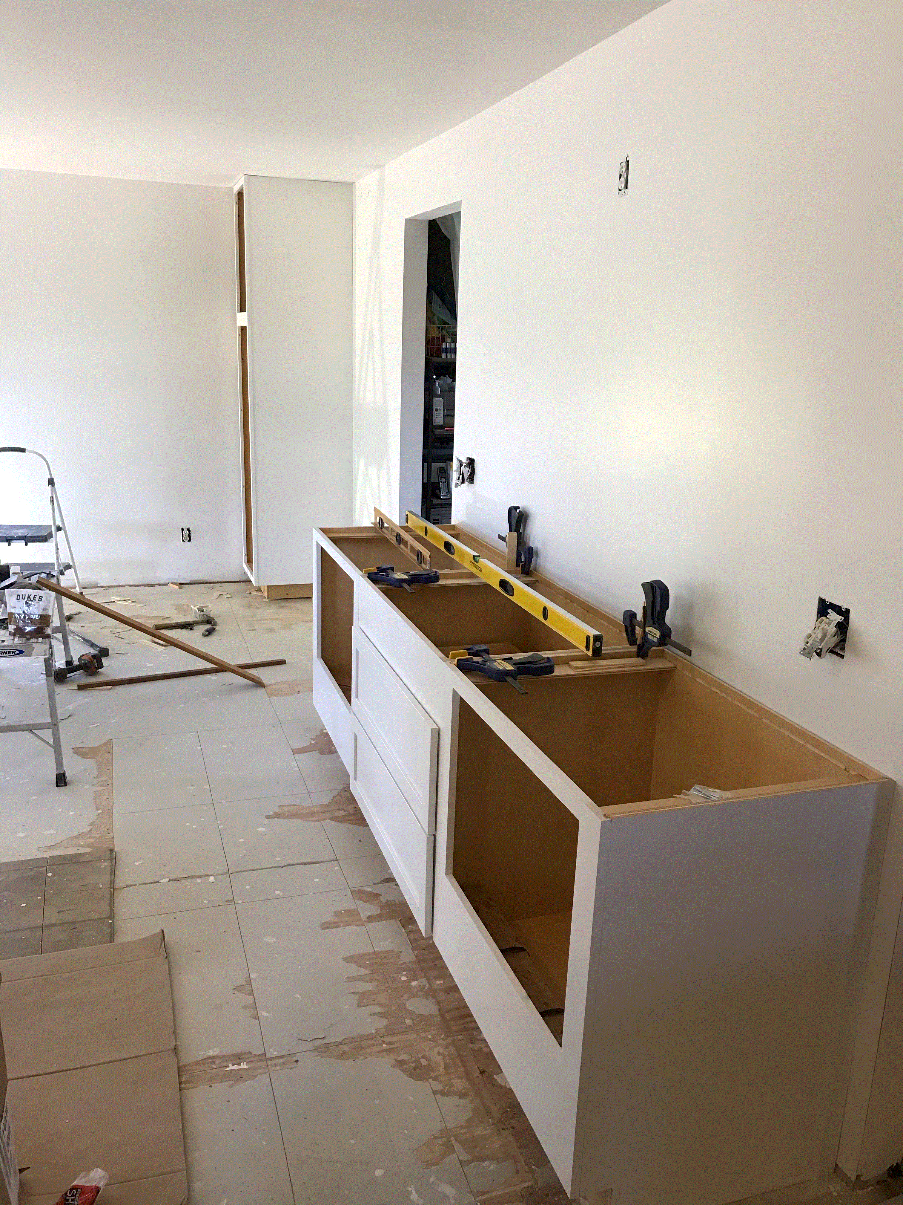

No cutting can happen as they are pre-finished cabinets.
Cabinet is 91 and 9/16 tall, the base is 5 and 5/16 then the base sets up inside the bottom of the cabinet by 15/16?
Fill in that 15/16" in the bottom, the build a new base with a 1/4"gap to allow for shimming, etc. Put the base down, slip the back edge on, then slide it back. You may have to vertical lift the cabinet. Raise it up in steps to get the cabinet higher than the base.
I built my panrty in two pieces because I did not want it on a base. Just lifted upper on once the bottom was secured to the wall. Jon
   / 96 Pantry and 8 Ceiling
#13
Thanks for the suggestions!!
I cut most of the left side of the cabinet off and we were able to work it into place.
In retrospect I should have cut the left side off flush and it would have been easier to do, since all the force once stuff is in the cabinet is pushing down on the floor of the cabinet which is on the base.
