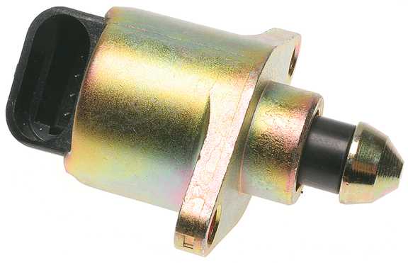

That almost sounds like a plugged or faulty AIS motor. (Automatic Idle Speed) This controls the amount of air getting into the engine when the throttle plate is closed. I'm not sure if the 5.9 engine has one, though.
Just did a search online and found something similar - and Idle Air Control Valve. (Pictured.) You might try removing it and cleaning it and the passage in the throttle body.

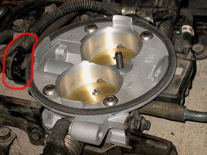

any idea where i might find that lil booger? I'm no mechanic.. but can turn wrenches on old tractors good...

I don't know, for sure - the nearest 5.9 liter engine (that I have legal access to) is about 100 miles away. If I recall correctly, there is a large plastic air duct coming from the air filter box that is clamped to the top of the engine. Take that duct off and it will expose the throttle body. The AIC will be mounted to the side of the TB, probably held on by some Torx screws. I think the thing circled in red in the picture is the AIC. (I'm not 100% certain that this picture is even from a Dodge 5.9 L engine...)

Unplug, as in remove the electrical connector? If that part is the problem, then unplugging it would make no difference - it would continue to die when you remove your foot from the pedal. The plunger coming out of the solenoid is spring loaded and relies on electricity to pull it back in to "un-plug" the passageways in the throttle body varying amounts, allowing air into the manifold when the throttle plates are closed.
(Note, this is not a valid way to test if this is the part causing the problem - it could also be the Throttle Position Sensor (TPS), but that requires a scanner tool to test. It's just easier to clean the idle control parts of the TB before digging in deeper.)
