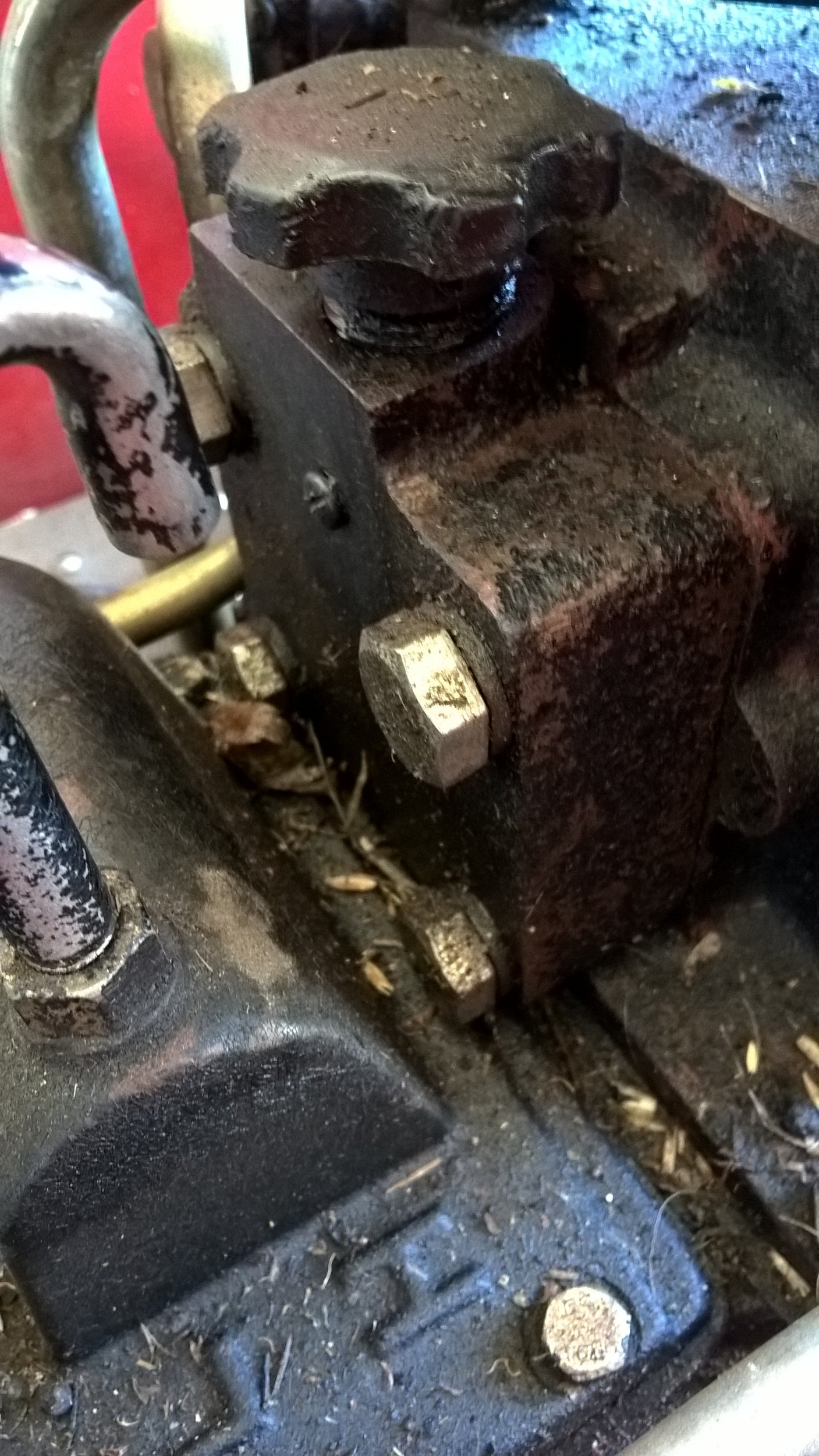

There is a small set screw for a straight head screwdriver

That linkage arm not being connected probably contributed to your situation.
It is good to know that you can access the cylinder by removing the front and rear covers. I wasn't sure it would give enough room to work inside.
Here is a picture of my adjusting knob and set-screw. 2006 284

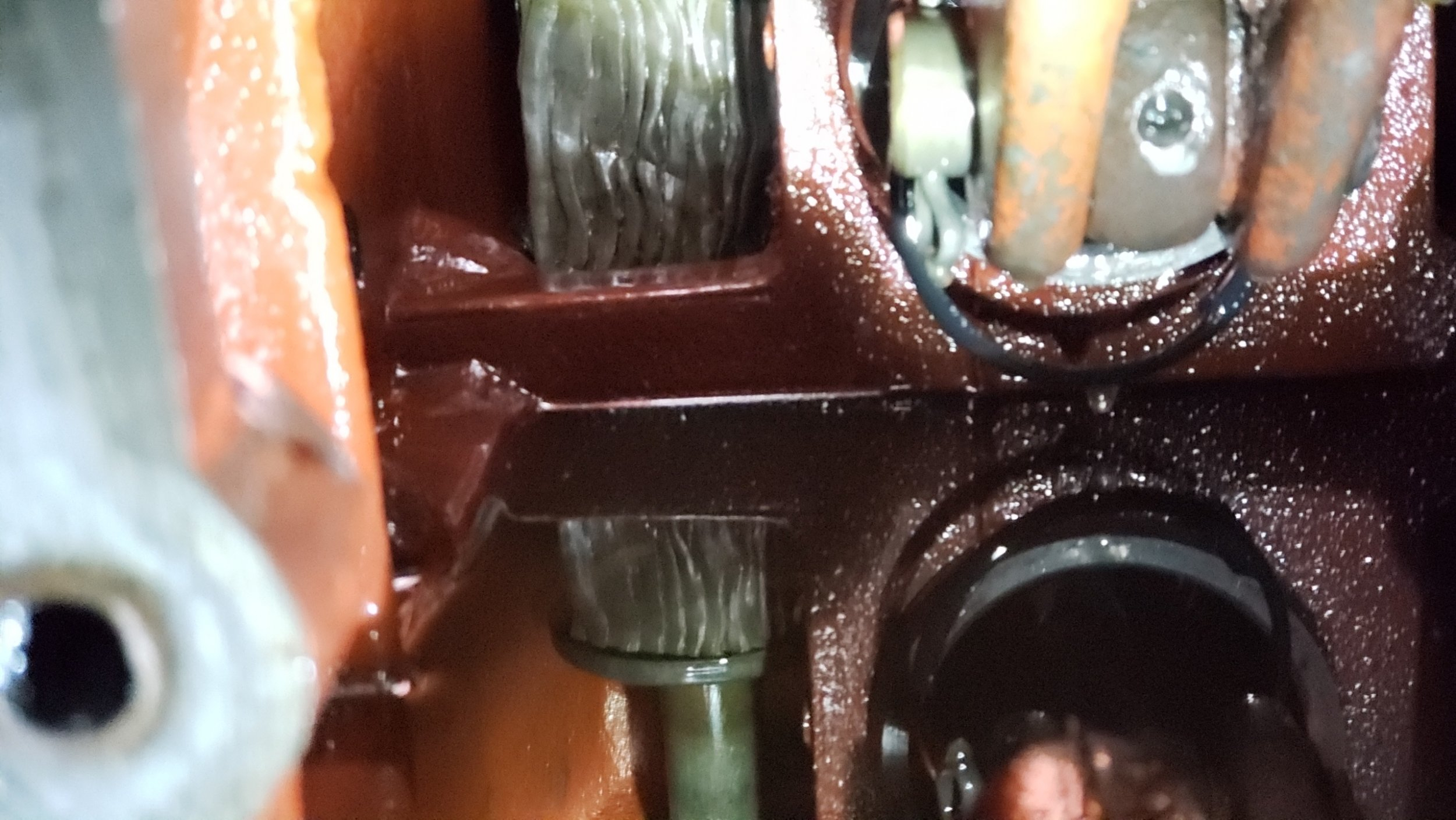

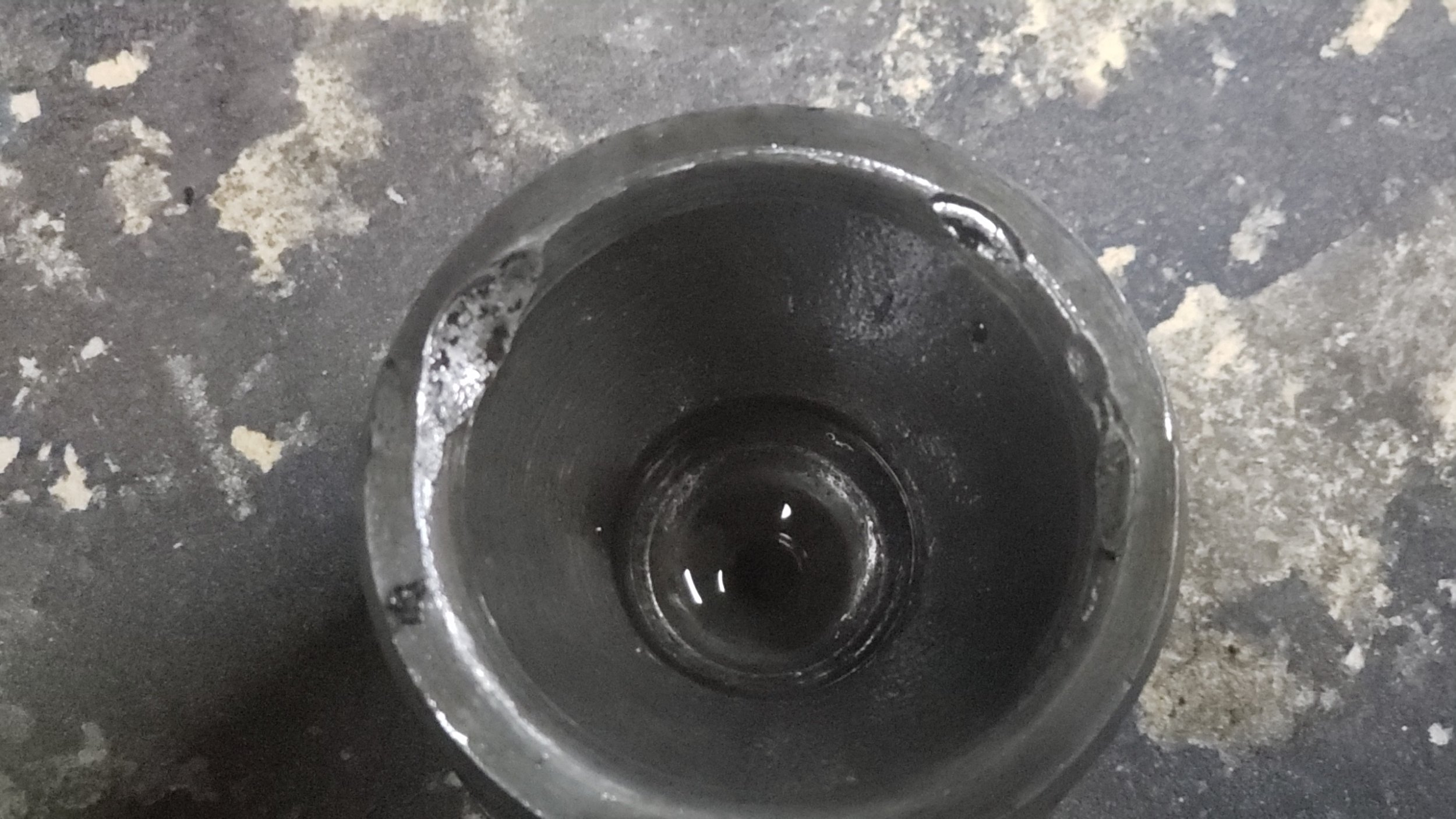

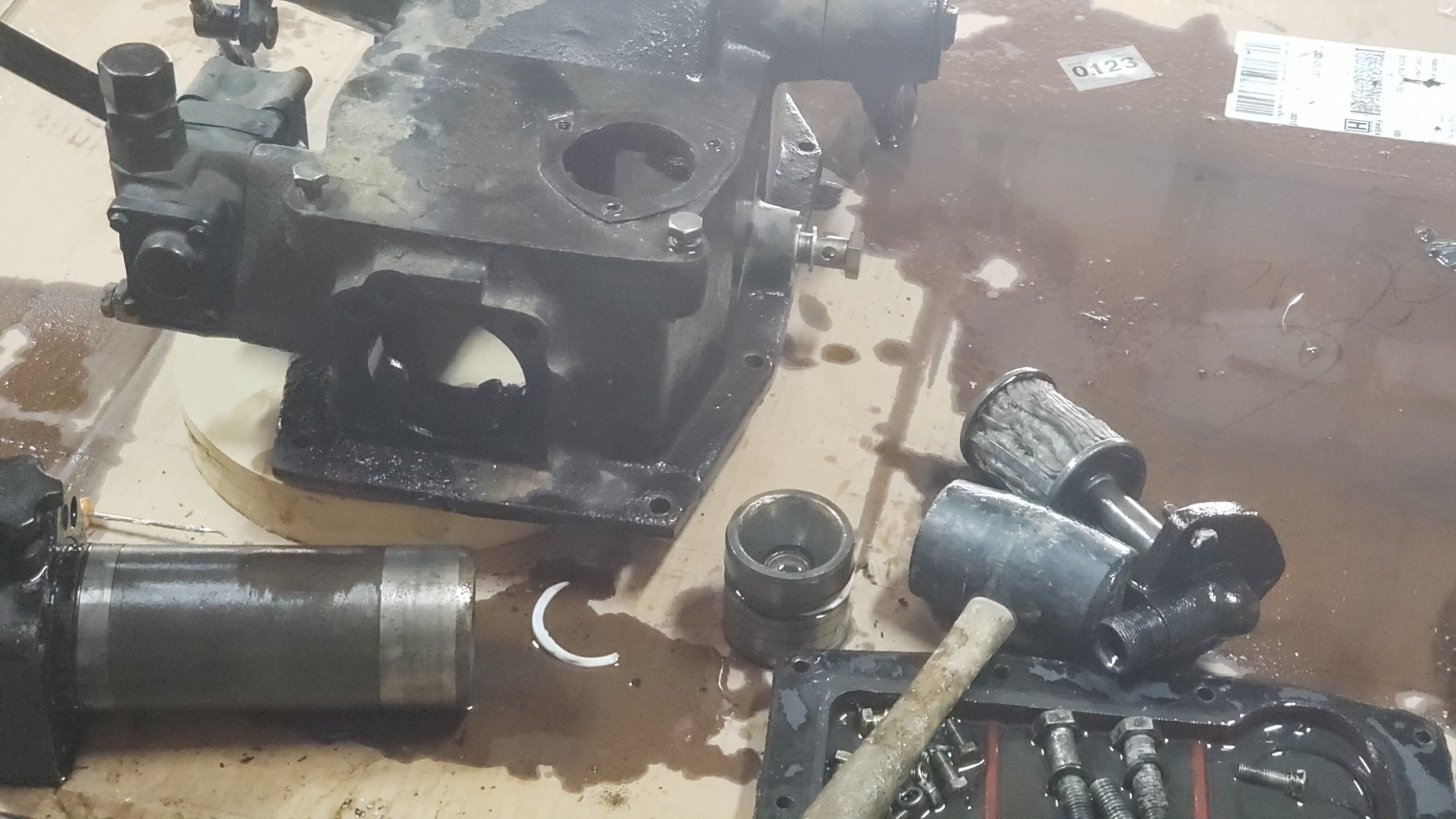

I removed the back plate and saw the piston rod hanging with a black o-ring hanging around it (pic 1). The piston was all the way to the front and could not be retrevied. I removed the lift box, a horrible design with a bottom cover what would keep hydraylic fluid from leaking into the gear box. With the lift box removed I unbolted the front cap and the cylinder was removed after pushing out some left over fluid the piston suction was released and piston slid out. I also found both of the nylon washer wipers were in pieces shattered everywhere. The o-ring that was hanging around the piston rod was in one piece but it was split down the middle leaving a 1/8 " thick o-ring where its usually .25 " thick. Its wonder the 3pt worked at all. I also found what was left of the dipstick. One more observation if the piston rod is not connected to the piston, if the pressure goes slack the piston rod ball becomes unseated and guides itselfs back into the piston center ? The last pic shows two dings where it looks like the rod has smashed into it while self guiding its way back to the piston?

Good thing you got in there to do some TLC. I think your assessment of the dings in the piston are correct. IF the lever was in the down position and the 3pt had lowered itself normally the piston would be at the bottom of the travel. Then if something (or someone) manually picked up the lift arms or drove the tractor with something on the 3pt in such a manor as to cause it to "float" upwards that could cause the push rod to come off of the piston. That is the only scenario where I can see the piston and the push rod separating. Normally just the weight of the arms will keep them connected. If the piston has no other damage, I would go ahead and re-seal it and move on. The dings don't look like they would effect the travel or the seal of the piston to the cylinder. A pain the wazzoo, but good work.
