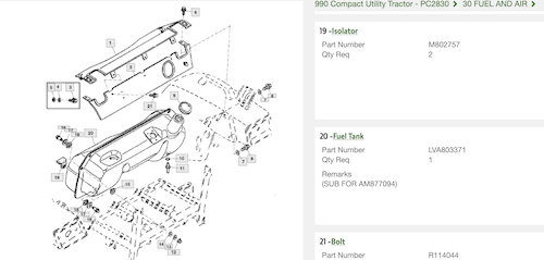

Need to replace fuel tank on my 990 compact, since there are no replacement tanks available I'm trying to decide how and where to place an auxiliary tank...any advice would be appreciated...

Its a Yanmar fuel tank. If you know the size in liters, I can provide you with the searchable p/n's.
/ 990 compact (fuel tank) #5
8.5 US gallons - 32.2 liters is what I find

Yanmar models YM276, YM330 and YM336 for domestic models use the same fuel tank.
p/n 194145-04112

the 990 tank mounts behind the seat -
