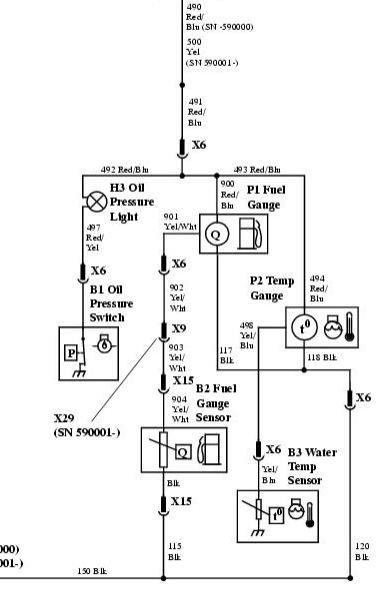

Feb 19, 2011 / 990 John Deere #1 G greenbay New member Joined Feb 19, 2011 Messages 1 Tractor 990 tractor compactor Fuel and Temp Gauge not working. Only two years old.
Feb 19, 2011 / 990 John Deere #2 AKfish Super Member Joined Oct 1, 2004 Messages 5,420 Location Alaska Tractor JD 5115M; JD 110 TLB; JD 4720; Ford 9N; JD X300R Welcome to TBN, greenbay. (Great game, too..!) Fuses good? Wiring OK? Lights? AKfish
Feb 19, 2011 / 990 John Deere #3 Tx Jim New Member Joined Jan 26, 2007 Messages 10,396 Location Coyote Flats,Tx Tractor JD 4255/Kubota M7040 HDC Besides checking fuses/circuit also check for a good dash ground connection.
Feb 19, 2011 / 990 John Deere #4 K kjung17 Gold Member Joined Dec 10, 2010 Messages 472 Looks like fuel and temp share a wire at plug X6. The feed is from fuse #4. #150 is chassis ground. Not sure if your wire will be #117 or #118 at the plug. Looks like the only black one on the plug.
