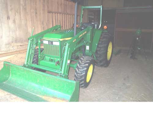

I found it in a classified ad, 40 hours, with attachments, selling for an unbelievably low price, and all of 4 miles from me. Drove it home. Attachments include a never used JD 513 rotary cutter, 12" phd, never used ballast box, and 430 FEL. Image attached, taken when I was dropping off the deposit check. I called a dealer to see if the offering price was a good one, and they joked, "What, is he getting divorced?"
