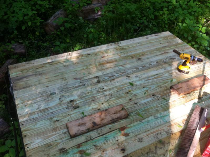

Finished up the decking Monday.

Yeah that stream is way to wide to use a culvert.
Does it ever get high enough that it will mess with your bridge?
JB.
We had real big flood the spring I was going to set the bridge. I went back and put stakes on the bank to mark the high water level. Then I set my grade for the lower beams about 6" above that. So far so good. I think the occasional tree that comes along might snag on it while the water is high.

Nice project. I would consider trying to anchoring the ends down somehow and not count on trees to do that, because if the water raises a foot it might push the whole thing downstream or turn it and dump it in the river somehow. There will be a tremendous amount of force on the whole side of the bridge.
I made a wooden bridge out of barn beams which worked great until I had to pick it up about 1/2 mile downstream after some flooding. But it wasn't made of steel like yours and was lighter, but you have too cool of a bridge to have something happen to it.
   / A bridge for my Massey #20
Kal130; I am curious what kind of foundation you have on each end, how far down and where you are located.
