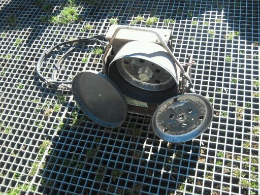

I'm all for stick welding:thumbsup:. On the job time is money, so it's wire feeders all the way.
You may luck out and get a good deal on an LN-25, but on the whole they go for $400 to $700.00 used. You might have better luck finding a deal on an LN-22, because they're so out dated. The wire is hot all the time, and you're limited to the 14-pound coils of wire only. But they are tough as nails. I've seen them fall 40-feet, and work just fine.
