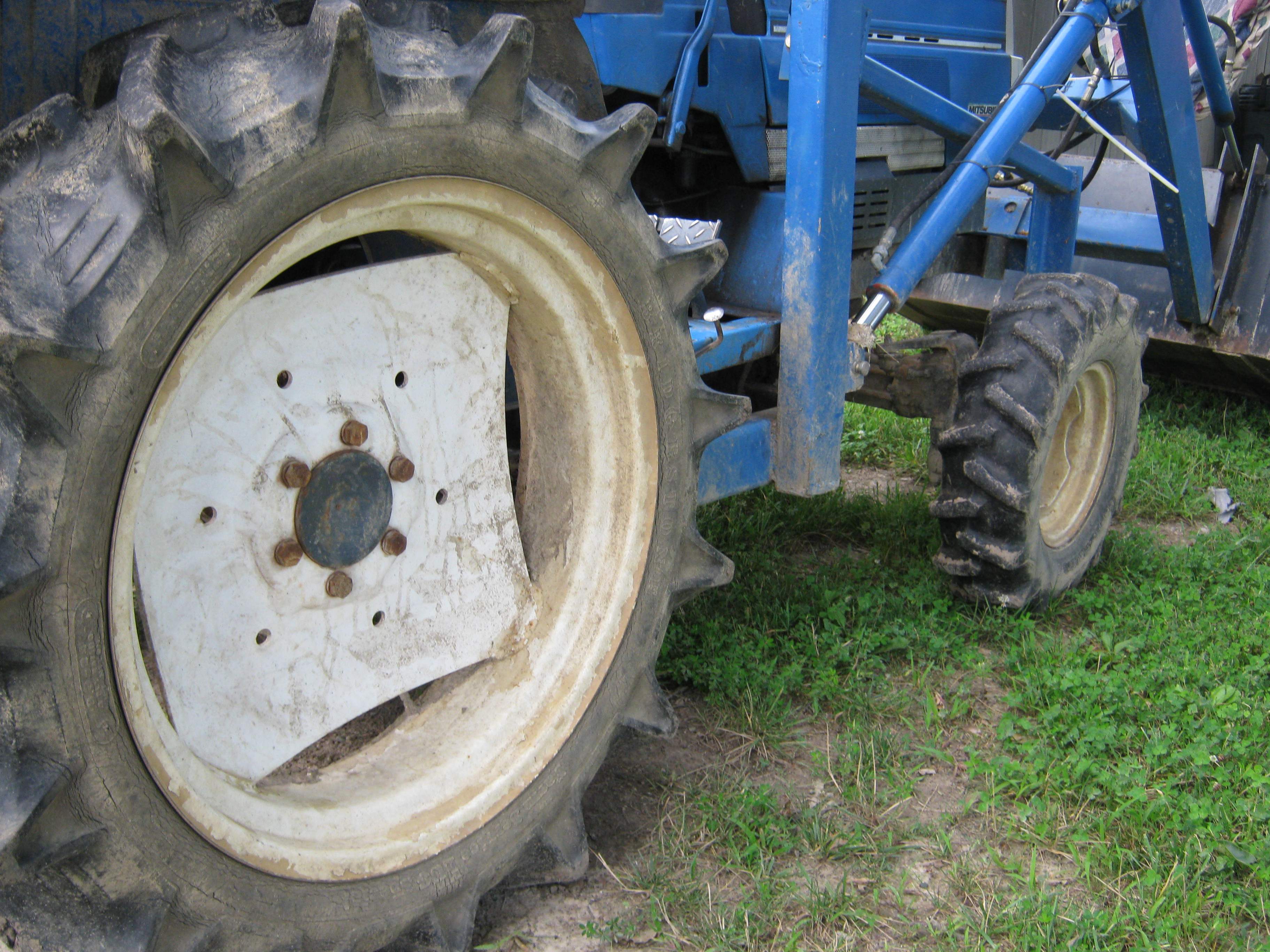

*That's why I always get off on the high side no matter what.
Not a lot of choice on this one Because of the levers on the high side LB ( see pics ) , Not much chance of Me getting through them , let alone over them :D .
I,ve got My jeans caught on them before & that didn,t work out so well , which is probablly why my first instinct was to bail to the left . ;) . Bob

Cowboy, I have owned a number of grey market tractors and currently own a Mitsubishi. The best thing I ever did to add stability was to swap the wheels around to the wider offset. I see you have yours still set with the offset to the inside. I have heard a few say not to do it on the fronts because it creates more of a strain on the front end of the FWD tractors but I have had mine set this way for probably 5 years and 3 1/2 of those with a FEL on it and never had a single issue. Even with 800# of counter weight on the back I have lifted the rear tires off the ground many times ( did it earlier tonight in fact) and have never broken anything. I am not suggesting that kind of abuse but the point is it has never caused damage to mine and the Iseki's are some tough tractors too.
Especially with the FEL on it, I am certain this wider track has saved my butt on a number of occasions.

Don't know how well you can tell the difference that the offset makes from the pics but depending upon your rims, I would guess somewhere between a 6-12" track difference which doesn't sound like much but is immediately noticeable. I mow a pond levy with mine that is definitely steeper than what your pics show and swapping the rims around made all the difference. I used to not be able to mow it with the tractor.
When you swap them, you want to put the left ones on the right and visa versa. If you simply turn the rim around and keep the wheel on the same side, your treads will be backwards, so swap them from one side to the other.
Looking at your rims, the rears appear to have a lot more offset than mine, they will probably stick out of the fender wells more than mine so you will occasionally get a little slop on you but I guarantee you won't want to switch them back after you see and feel the difference it will make. It will feel like a different tractor in a lot of situations.

Once again Thanks for the info & mostlly for taking time to take the pics. It looks like it would make one heck of a difference as well as easier to get to the grease zerts :D . I might just give it a try . Thanks again Darryl , Bob

One last comment about swapping the rims around. If turning the fronts give you concern about any added stress on front spindles or bearings, just swap the rears. Since my first response to you on this subject ( front rim specific now), I have done some reading on here about it and some members have posted that their dealers have recommended doing it and some have said not to and it seems to be a very model specific issue as to whether it is advisable. I have never read or been told that swapping rears can create any problem and is something I would advise without reservation.

As far as reversing the wheels & tires I will probally do it on the rears only for now & see what difference it makes before I consider the fronts . But after looking at mine it does look like it would make a Huge difference on the rears as They do have quite a bit of an offset on them .
