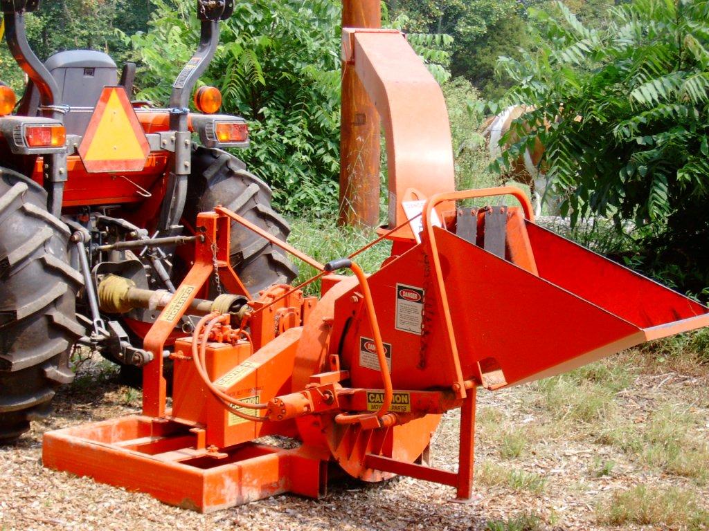

Hi Riddler,
I run an old Morbark (Eager Beaver) model 125 PTO powered 6" hydraulic feed. I run it on a Kubota L4330 (about 38 pto HP). The hydraulics are all self contained, belt driven pump off the main input shaft. I bought this used, but extremely well cared for; paid about $3500. It is wicked heavy, about 1000-1100#. If you watch e-bay for a while they occasionally come up, even a few Vermeers. I'd be wary of a used unit that was a rental, but PTO-powered ones are very rare in the rental world! From my old research, I think that the big Wallenstein 6" hydraulic feed was the closest match in something new. The latest Jinmas that have the few kinks worked out also seem to be pretty similar in capability.
We have used it for a few dozen hours now with only one blade change for maintenance. I bought one spare set of blades for about $45. Spending what's req'd for a big hydraulic feed may be mitigated some if you have other kin/relations that have similar needs;-). My BIL used it to digest all of the debris from cutting his powerline and road to his house!
It will happily digest full green cedar branches up to about 4" main branch diameter with no problem. Sometimes if the branches have 90 deg side branches of substantial thickness and strength, one has to manually "fold" (or cut) the side branches into the hopper or push down on the feed roller handle to get the extra grip needed to force the side branches through the hopper. With anything but cedar, this is usually not needed. 95% of the time, one shove into the hopper to get it started is sufficient and you can ignore it while going for the next load. The only time I stalled it was with a part-rotted, soft, soggy 6"+ diameter pine log; it cut so fast, and the soggy chips were so heavy, that the fan/blower blades couldn't get the chips up and out of the discharge chute fast enough, and it bogged down and then stalled the tractor. In summary, chipper only suits my needs fine, and I think your needs are very similar.
The major disadvantage I see to most non-powered feed chippers is that the user has to lift the material much higher to start it into the hopper. If one is chipping a few dozen branches or the remains of a medium sized tree, no problem. But with the volumes I am dealing with (and probably you too) the lifting to a manual feed would wear me out fast.
- Jay

That's great looking chipper (and tractor). You're lucky to find a unit like that at that price.
You're right that having a relatively low chute angle will make a significant positive impact on the work I plan to do. The self-powered units I have rented have been like that, and now I can understand why. Hydraulic feed is pricey for sure, but with the many years and many acres of material that I have to chew up, the investment is looking increasingly worthwhile.
