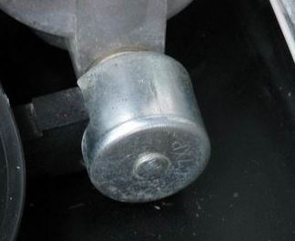

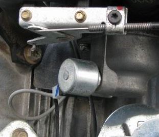

Is this the fuel shut off solenoid on your LA 145? I have a LA 135 with very similar fuel starvation symptoms. I've checked the fuel pump operation and my next step is to check the fuel cut off solenoid for correct operation. Thanks
Does anyone know how to remove it without destroying it?

   / A couple of JD LA145 issues #16

All of these guys have been gone for several years, I remember Jinmam as a nice and helpful member, RIP. mjmcad also did some nice work and was well informed too.
About the fuel shut off, IIRC this will unscrew from the carb without issue and the internal plunger retracts when energized to allow the float to drop and open the needle valve.
