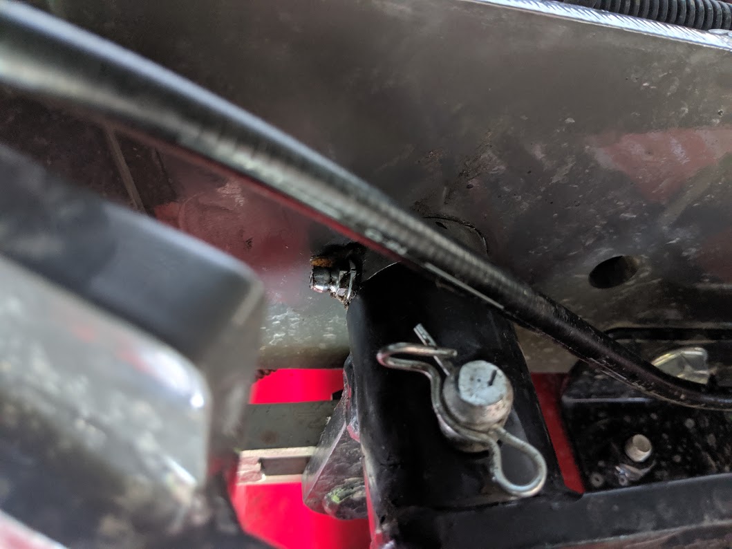

I was under there looking for zerks to hit with the grease gun, noticed 2 weird things, well 3 actually.
First is, the manual says there's a brake pivot to lube, but I just couldn't find that zerk. Is there one for that or do I just smear some grease on there?
Also, the zerk I did find on that side was farther back, I guess it's pivot for the 3-point, and it's in a ridiculous spot...there's no way I can get my grease coupler on it because it's almost butting against the pivot housing, plus it's in tight spot a normal coupler couldn't get to anyways. How are you guys greasing it?

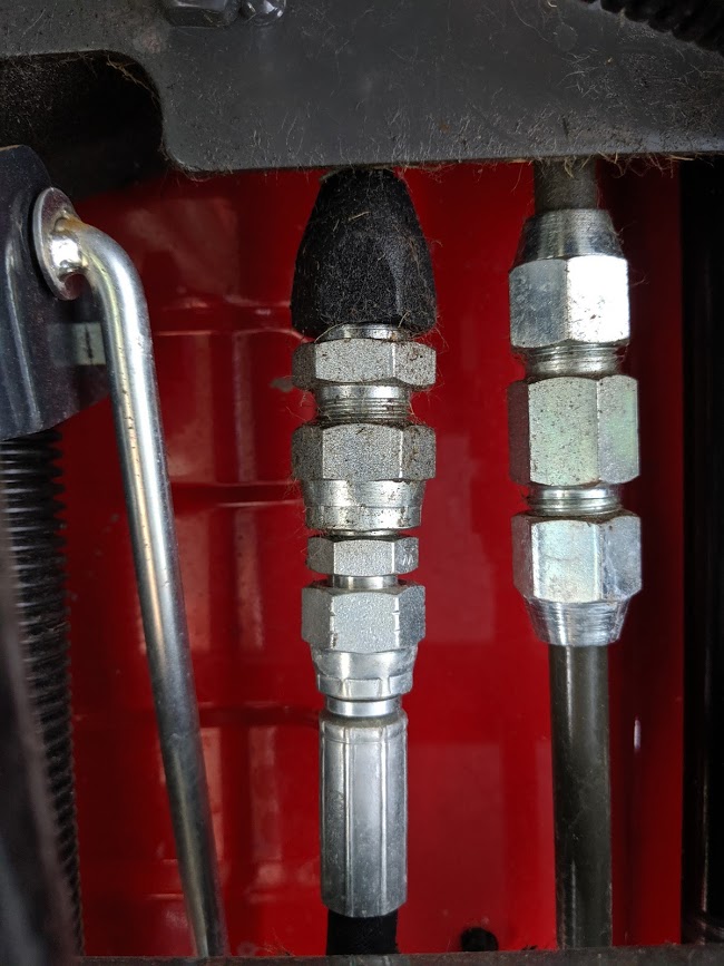

Another strange thing is on the hydro pedal side. There's a hydraulic hose routed over the linkage, and the linkage is brushing against it with every push of the pedal. Is that normal? The hose has that fabric sleeve, and you could actually hear it scraping against the sleeve when I was moving the pedal back/forth with my hand. I smeared a bunch of grease on the sleeve over there hoping that would help.

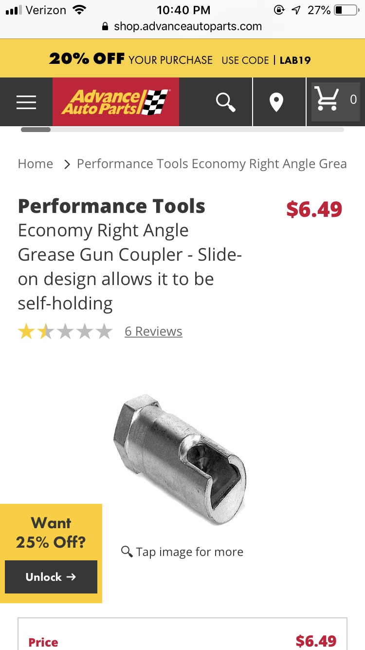

Maybe a right angle grease coupler would help you. View attachment 619167
It's real close to the wall too, though. Only a thin walled coupler would fit, and do they make those? It's not all that noticeable, I wonder if many people ignore it.
   / A couple things I noticed underneath my GC1710 #6
The earlier GCs don't have one to my knowledge. Its not in an area that gets washed out, or under any significant strain/repeated use. Get a can of Fluid Film, give it a spray once a year to stop it from rusting. You'll eventually need a spray lube for the 3pt top link, the threaded section on the lift arm (usually rusted up when you need to adjust it), and the ball couplings.
The hose that is rubbing. Any way to zip-tie it out of the way? It will take a long time (years) to wear through the mesh. Vibration will probably cause more wear than the linkage rubbing.

That grease nipple (zerk) that's hard up against the pivot housing is, indeed, in a bugger of a spot... that can't be normal. I'd definitely bring that issue up with your Dealership and I'd document it for any future potential problems arising. Fair dinkum, that's a manufacturer's design fault and needs to be rectified.
That being said, the GC1710 model started in 2013 and small improvements have occurred over the years... which do not get entered into the Owner Manual. Again, ask your Dealership about the discrepancies that you find (making a note, in pencil) in the Manual.
Generally, I'd snug/tighten/torque every nut that I can access; grease every nipple that I can see and, if it moves but doesn't have a nipple, spray it with a lanolin lubricant.

Yes there are two zerks on brake pivot rod, not exactly where MF manual shows where the " one" is (at least on my 1715) ...
Have not noticed hydraulic hose rubbing on anything... Maybe just tie it up with zip tie or something to avoid contact....

Ok, I need to look more thoroughly for those zerks I guess, for the life of me couldn't find it/them there.
As for that hose, it's pretty tight up against that linkage, I could hardly budge it out of the way to get my finger in there with a glob of grease. I don't know which hydro line it is, this is where it attaches (the left one) farther back.
Can somebody take a look sometime under theirs, see if it's the same way?
