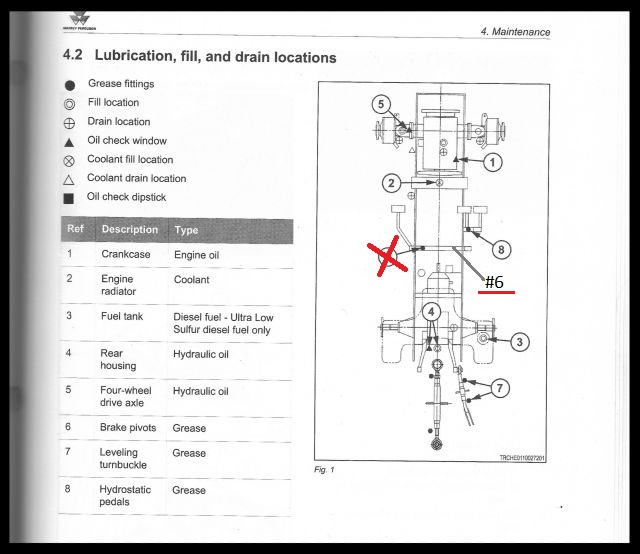

I was under there looking for zerks to hit with the grease gun, noticed 2 weird things, well 3 actually.
First is, the manual says there's a brake pivot to lube, but I just couldn't find that zerk. Is there one for that or do I just smear some grease on there?

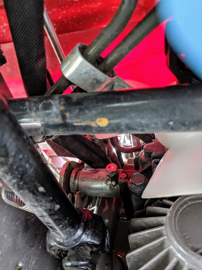

Also, the zerk I did find on that side was farther back, I guess it's pivot for the 3-point, and it's in a ridiculous spot...there's no way I can get my grease coupler on it because it's almost butting against the pivot housing, plus it's in tight spot a normal coupler couldn't get to anyways. How are you guys greasing it?

My grease gun coupler fits fine. I have a 36" flex hose. It's a bit of a strain on the hose, but it still pumps the grease in there. There are 4 grease fittings under that tractor.
I have a Milwaukee M18 cordless grease gun. Perfect for a backhoe with lots of fittings.

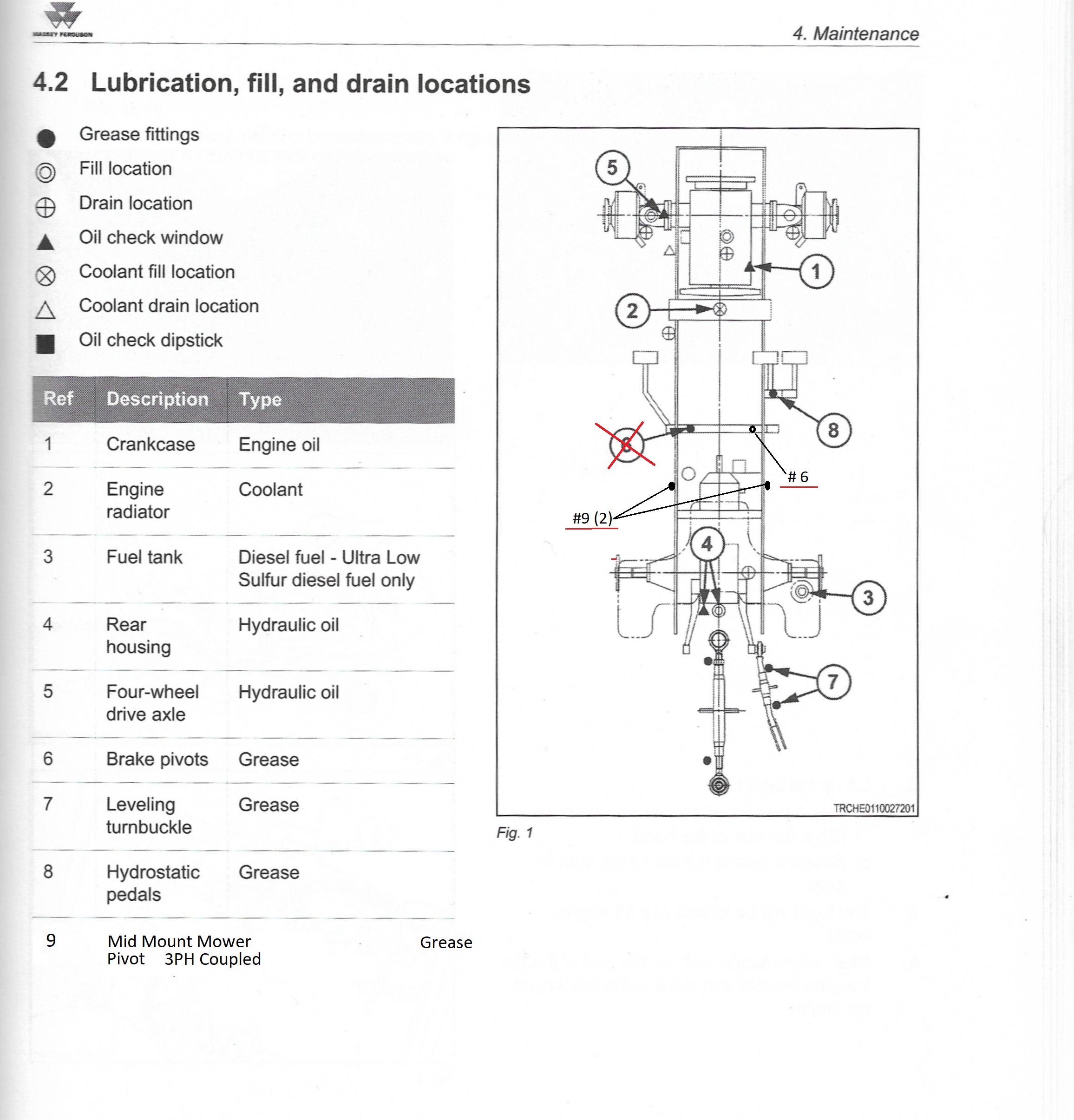

About brake pivot that needs to be lubed.... First an apology because I though there were 2 but I can only find 1..... On my 1715 its on the sleeve the brake pivot rod rotates in, and it is about 3 inches towards center from right frame member (from operators position).... On the sleeve right near the drive shaft to front differential...

Great, thanks Dale. I didn't see the zerk on the left side either (the one you x'ed out), and they don't even list that hard to reach zerk on the 3 pt linkage.

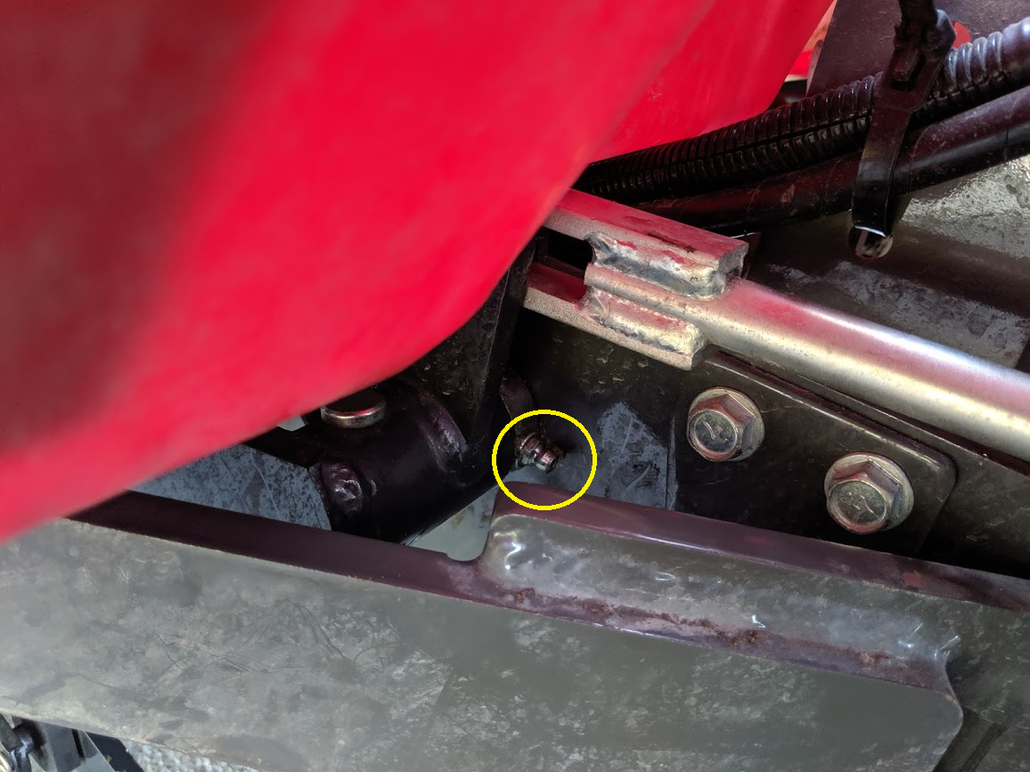

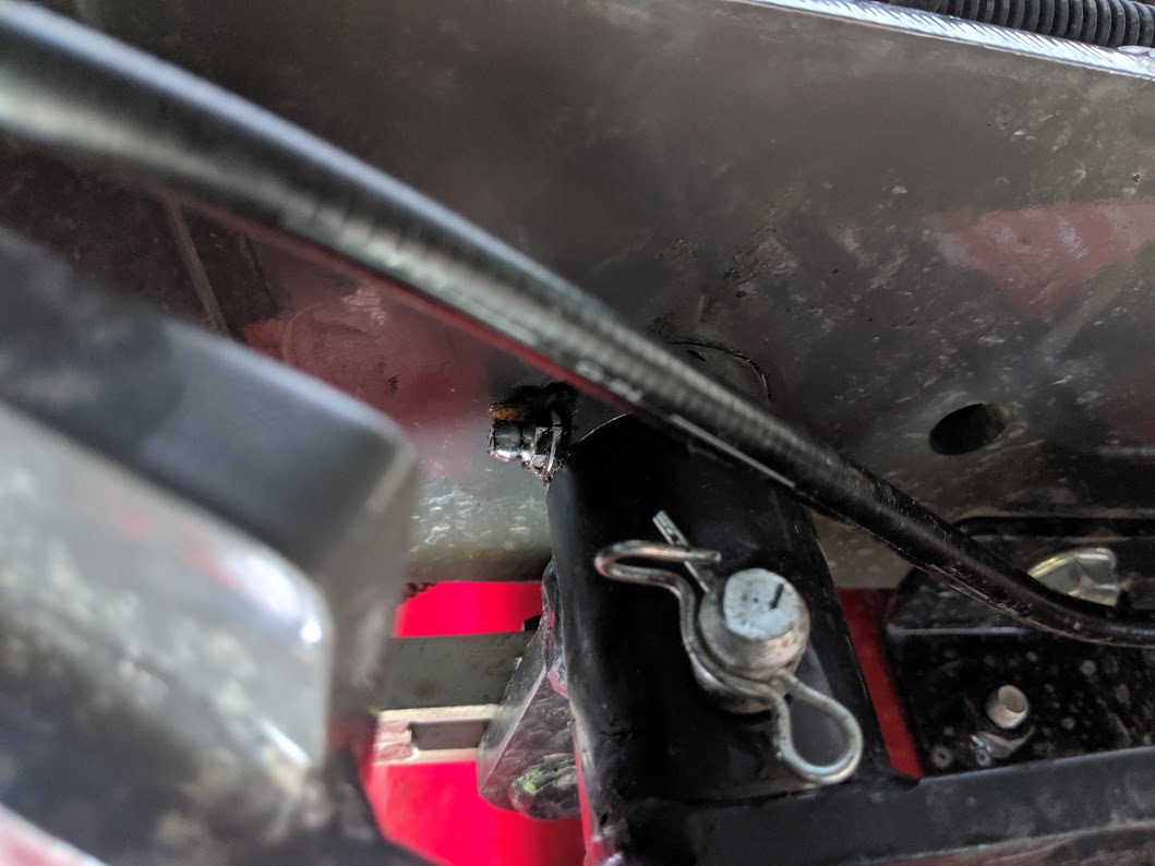

Yeh, I think it's the pivot linkage for the 3 point and mower deck lift, that's the zerk I'm talking about that's hard to access as is. Here's a pic of it looking from the outside left side, just in front of the rear wheel.
   / A couple things I noticed underneath my GC1710 #30
After all these years i have ever noticed those two! Biggest issue is how do you get in there as it is tight to the frame. It doesn’t move a lot but still.....
