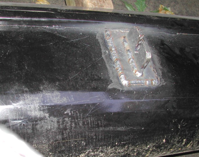

Jay, those 2 kinds of hooks are not your only choices.
I use 1/2" plate with a slot or slots cut in them, plus a backing
plate. Here is one I finished last week, installed on the back
center of the bkt. The painted version is hard to see in a photo,
as the black paint has poor contrast to the bkt.
I learned this from one of my excavator contractors....he used
multiple slots in the same bar.
One advantage over hooks is that the chain can be dropped out
of the slot after you take the load off, by just curling the bkt up.

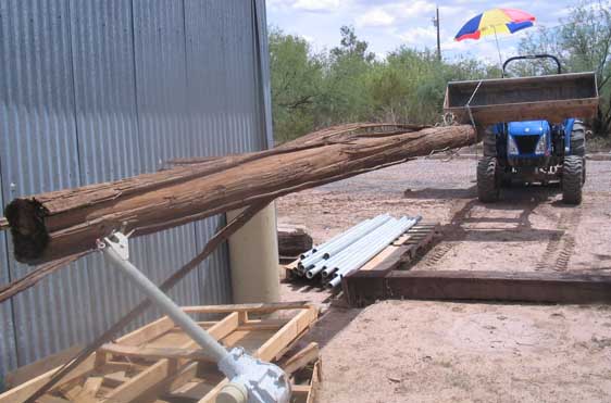

/ A different bucket hook question #7
AWDirect.com has weld on hooks.
/ A different bucket hook question #8

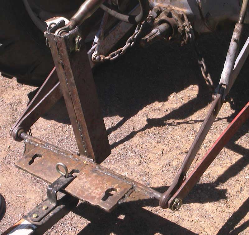

See pictures in other post as well as this one.
Another option is a Key hole slot that a chain locks into. Pictured is a draw bar that I built of a neighbor. A ball can be bolted on, chain or chains fit through the slots, as well as a simple pin hook up.

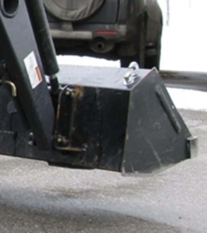

/ A different bucket hook question #9
I posted this on another thread but will repost here. Sorry for the fuzzy picture but I no longer have the tractor.
I used ordinary chain grab hooks, put fender washers on each face of the bucket, and the nut for the bolt is between the clevis holes on the grab hook. The bolt continues up to the top clevis hole.
/ A different bucket hook question #10
Sorry, this picture should have gone with the previous post. My internet connection is really screwed up. Such are the joys of sharing wireless internet.

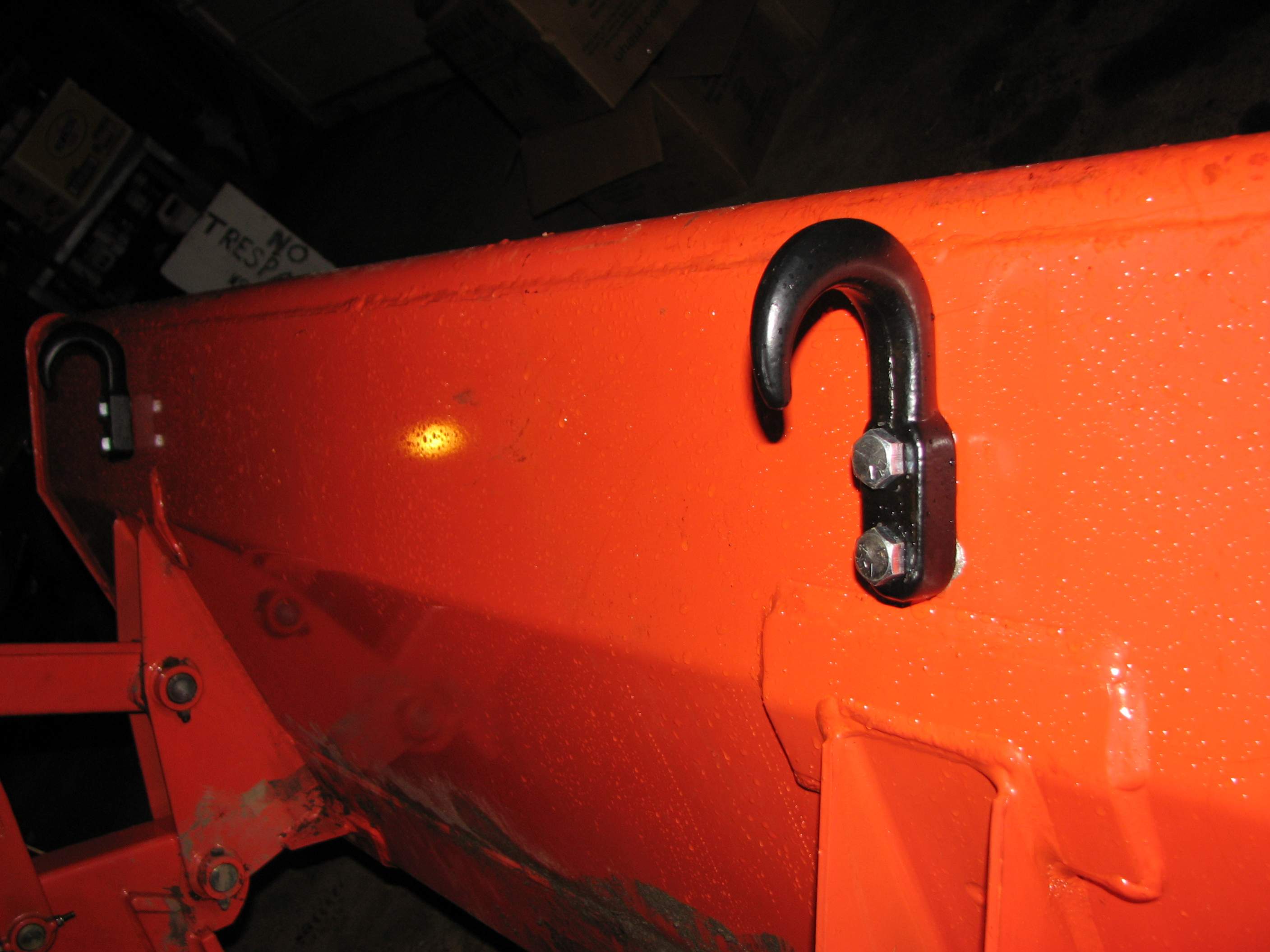

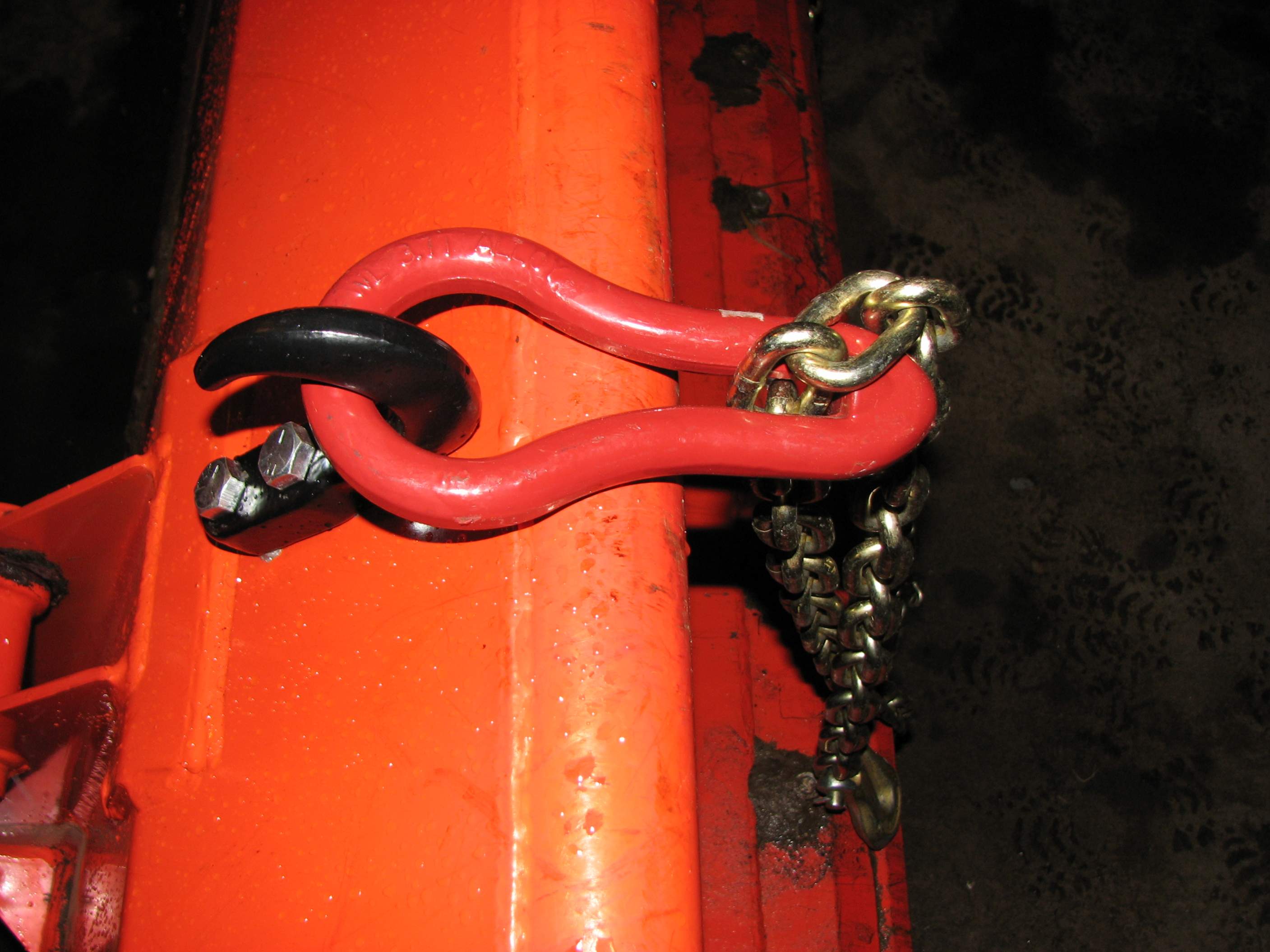

/ A different bucket hook question #11
I went with bolt on slip hooks because I didn't have a welder and frequently prefer to use ropes rather than chain. Hooks, nuts, bolts, & washers are from TSC & banjo links are from Bailey's:
-Jim
/ A different bucket hook question #12
-Jim
That's a good combo, using the banjo link, I have one of those also.
Your set up is good for rope, chain, sling, and cable
Just remember for anything heavy you need to use both hooks so you don't put to much load on just one side of loader/tractor.
I just bought some of those same hooks from HF they came with the fasteners, but also a spring steel keeper that closes off the hook so something put on the hook wouldn't fall out.
Haven't decided what to do with the hooks yet.
JB

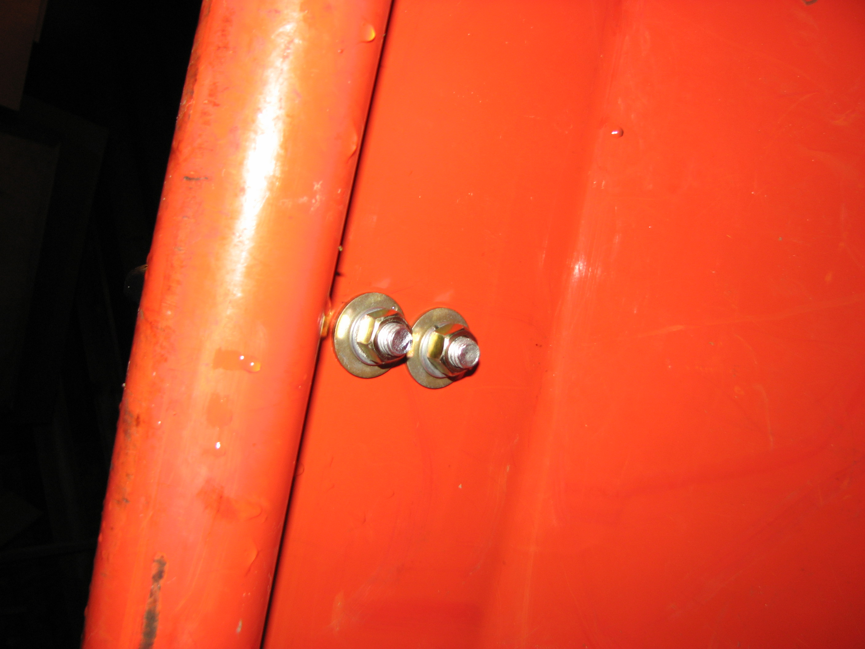

/ A different bucket hook question #13
I used two bolt-on Shackle mounts, i.e. HD Eyes.
Now I can use shackles, hooks, or anything else that mounts with a bolt and is space to fit.
I have a sling that mounts to the two mounting points with shackles and come together for a single lifting point.
Also, I reinforced under the Shackle Mounts, inside of the bucket, with シ Plate larger than the Shackle Mount foot print, just to be on the safe side.
Sorry, no pics but working on it; working on it !
