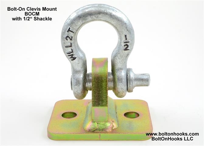

I bought some of Ken's excellent Bolt-On Hook products some time ago, and am only now getting around to putting the Bolt-On Clevis Mount (for a shackle) on the backside of the backhoe bucket on my BH77, on my B3000HSDCC.
I can't remember why I didn't buy both the chain hook and the Bolt-On Clevis Mount (i.e., his "Grab Hook Clevis Combo,") but it appears I only bought the latter (i.e., not the chain hook). So I have a few noob questions:

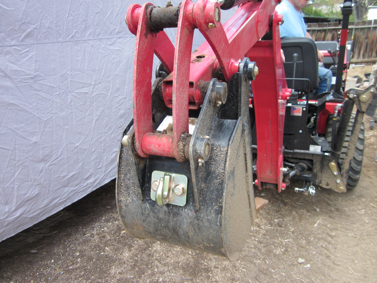

1. Should I mount the Bolt-On Clevis Mount on the INSIDE or the OUTSIDE of the backhoe's bucket? (It seems to me I should mount it on the backside of the bucket, so I have the full amount of "reach" when using the backhoe as a (light) "crane" to unload trailers, etc....) However, in the attached pic from Ken's website, I see that the chain hook is mounted onto the backside of the bucket (see attached pic of red Mahindra backhoe with black bucket that I got off of Ken's excellent website).
2. Assuming I mount the Bolt-On Clevis Mount to the OUTSIDE of the bucket, how close to the bucket's lower pivot pin should the clevis mount be placed? Please see the pic below, where the chain hook appears like it could have been mounted a bit closer to the bucket's lower pivot pin, and thus away from the area of the bucket that is obviously in contact with the ground, based on how the paint looks. I assume it wasn't mounted any closer to the pin in order to allow bulky/multiple chains, shackles, etc..., to be easily hooked over the hook without being blocked by the bucket's pin boss.
3. HOWEVER, I feel I should have also bought the chain hook from Ken and plan on doing so in the future, meaning I will likely then swap the Bolt-On Clevis Mount into the inside the bucket, and put the (new) chain hook on the backside of the bucket, as shown in the photo of the red Mahindra backhoe, below.
Does anyone see a problem with my plan to add the chain hook at a later date and simply reuse the same, two holes I'm about to drill for the Bolt-On Clevis Mount? (I realize I'll need to also buy the longer bolts and, again, I should have bought Ken's excellent clevis/chain hook combination kit, shown here: Grab Hook Clevis Combo: Grab Hook/Clevis Combo - BoltOnHooks LLC)

I'd place the hook where it's out of the way while digging but still reachable with your chain. Be a bummer to break off that new hook when digging and you will hate it if it's tucked away so tight you can't unhook your chain while wearing leather gloves.

There are a lot of ways to do add a BH bucket hook. I put mine outside of the backhoe bucket much like your picture shows. The difference is I use a heavier clevis mount instead of a hook, and my lifting kit contains several D rings rigged for use with nylon straps or with a chain hook.
I stuck mine on with a magnet and tape before drilling and worked the bucket to see if I had the right amount of clearance. This isn't the first one I've done, and I've been surprised to see that even when they are lower and farther away from the lower pivot I haven't had any interference or wear when digging. Not enough to worry about. A Clevis mount can be tighter because the D ring gains you chain-rigging clearance.
3. HOWEVER, I feel I should have also bought the chain hook from Ken and plan on doing so in the future - putting a Clevis inside the bucket.
Why not? It ought to work. I use heavy thick washers on mine to spread the load out inside the bucket and recommend you use that or some sort of backing plate. Your extra Clevis mount would do the same
4. Does anyone see a problem with my plan to add the chain hook at a later date and simply reuse the same, two holes I'm about to drill for the Bolt-On Clevis Mount?
If it does need moved, I suspect that the back of the bucket won't be hurt by a few extra holes. Buckets don't tend to wear back there.

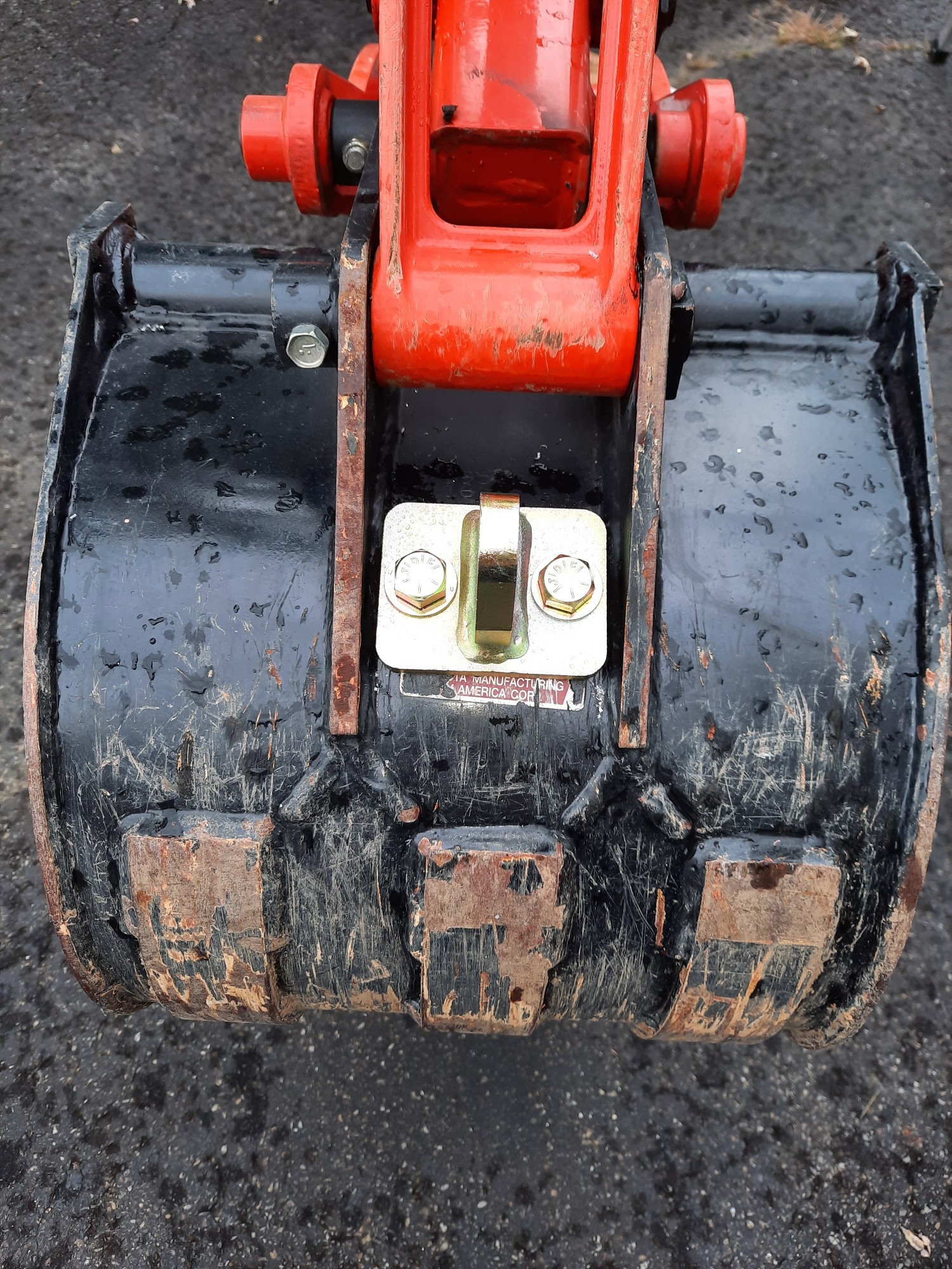

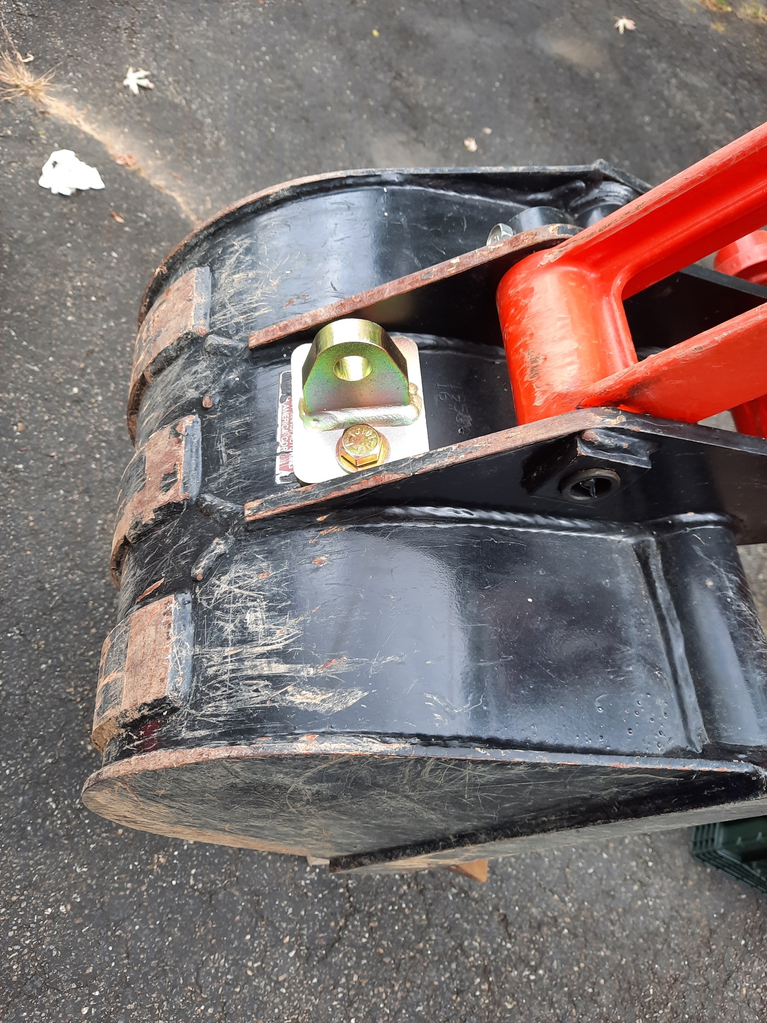

mikester: Thank you--I hadn't considered the effect of gloves. Unfortunately, given that my bucket is narrower (or at least, built differently) from the backhoe bucket on the red tractor I posted earlier, I won't be able to work a shackle pin while wearing gloves, given how close the bucket's rear, reinforcing bosses or flanges are to the bucket's lower swivel pin. But, it is what it is.
Also unfortunately, as you will see in the pic of how I added the clevis to my bucket, the entire backside of my bucket is rounded (unlike the red tractor's bucket I posted a pic of, which has a nice, flat surface for the clevis pin's base to sit on).
And not having my welder at this location, I was unable to "build up" a suitable, flat "pad" for the entire base of the clevis's mounting plate to sit on squarely. I did find a "sweet spot" where the tendency of the clevis's mounting plate to "rock" is less likely to occur. However, because of the rounded back of my bucket, I'll be lifting largely against the "shear strength" of just the two, Grade 8 bolts which are provided with Ken's kit. But to be clear: Ken's kit, and bolts, are excellent--really top shelf stuff! The fact that my bucket is rounded is not something a 3rd party's kit can be expected to compensate for. :)
But given the rounded back of (most of) my bucket, in the future, in order to lift heavier loads with greater piece of mind, I plan on buying two more clevis kits from Ken's Bolt-On Hooks, and mounting one up on each top corner of the BH's bucket, where there ARE completely flat surfaces to mount on. This way, the entire backing plates of the (two, additional) clevises will be providing strength that is far beyond what is available from even the center-mounted clevis's Grade 8 bolt's shear strength.
But I will leave the center-mounted clevis as well, for lighter loads, as I won't need to rig up some sort of "bridle" to use the center clevis, as I will in order to use the two, additional, top-corner mounted clevises I plan to add. Make sense?

Thank you for the suggesting that I get some "D-Rings" to use with the nylon straps I have! I will make a separate post asking for suggested makes/models/sizes of D-Rings, but since you already use them, I'd like to ask you (either here or in the "D-Ring" post I have not yet made) if you can suggest any sources for D-Rings you like.
That's a great idea you had, to do a "test dig" with the clevis temporarily mounted with magnets. I didn't have any magnets (but I will keep that in mind for future customizations!) but I also didn't have a lot of placement options, given the rounded back of my BH's bucket that I keep ******** about.
I might not end up mounting a clevis inside the bucket after all, given that much of our soil here has a high clay content, which I suspect will cause wet clay to stick inside the bucket as it is. But I might try adding a clevis inside the bucket, and see if I can get away with it--we'll see.
Good point about a couple extra holes in the back side of the bucket not affecting bucket integrity significantly. Plus, if I do remove the center-mounted clevis once I add a clevis to each top corner of the bucket, as described above, I could always weld up the two, original holes.
