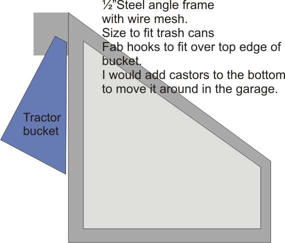

Welcome DmFahie,
If you have the tools you could fab a simple frame and add grating or wire mesh.
Then fab a hook to go over the top lip of the tractor bucket. Drive up tilt, lift and drive to the curb.
Phil

Ding ding ding ding, we have a winner. Phil, thats awesome. I live the caster idea, very simple design, easy fab. Thanks.
   / A "Dumpster" for my Tractor #15
Great one Phil... inovative and yet simple.. I love it..:D

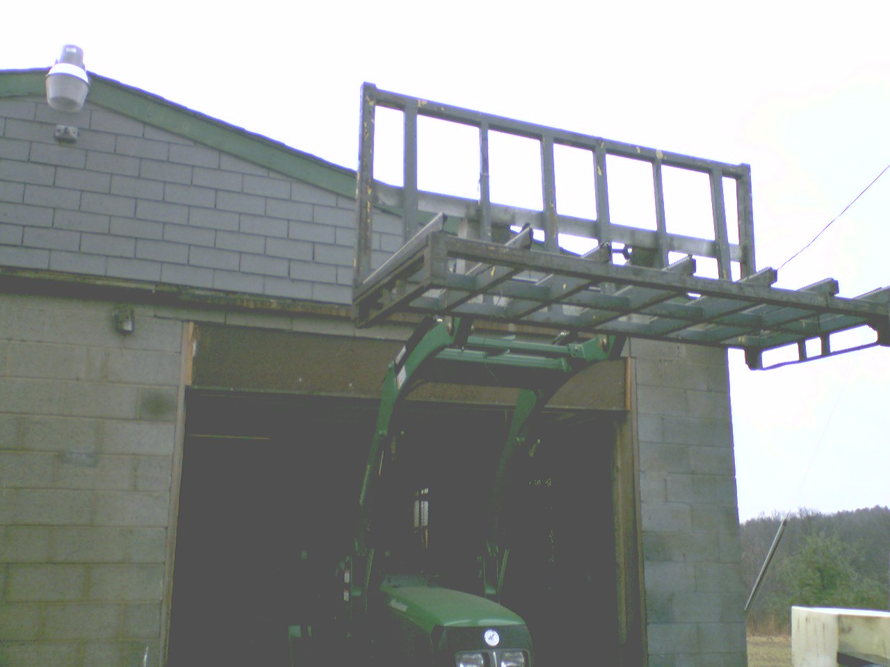

Hi all
Here is somthing I put together last summer when I was putting on a new roof and used it to put tear off in . Since these pics' were taken I've put corrugated metal sheeting on 3 sides and the bottom . It works great as a carry all / dump box etc. This was made from a glass rack from a comercial glass shop . They were throwing a bunch out a while ago and I went dumpster diving.
K9
