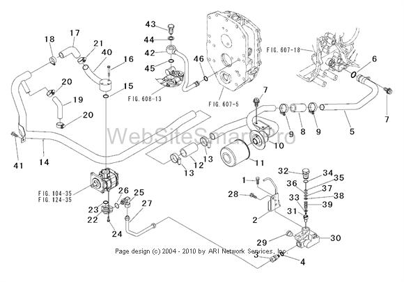

New to the site and have a few questions about the 3215. Does anyone know the thread size for the ports of the hydraulic distribution block that feeds the loader valve? (#30 in the diagram) It is not a typical SAE (o-ring sealed) fitting. I need to replace the factory fittings and would like to convert them. Also is there a draft control option for the 3PH?

I believe what your needing is a G 3/8 Plug size. for the T and N port. At least that's what I'm getting out of the service manual which talks about external hydraulic circuit.
T - Plug Tank
N - Plug return
P - Hydraulic Pressure external port
Hopes this helps.

Thank you very much, that's what I need to know. 3/8" G is a BSPP fitting, of which I can get an adapter to NPT.
